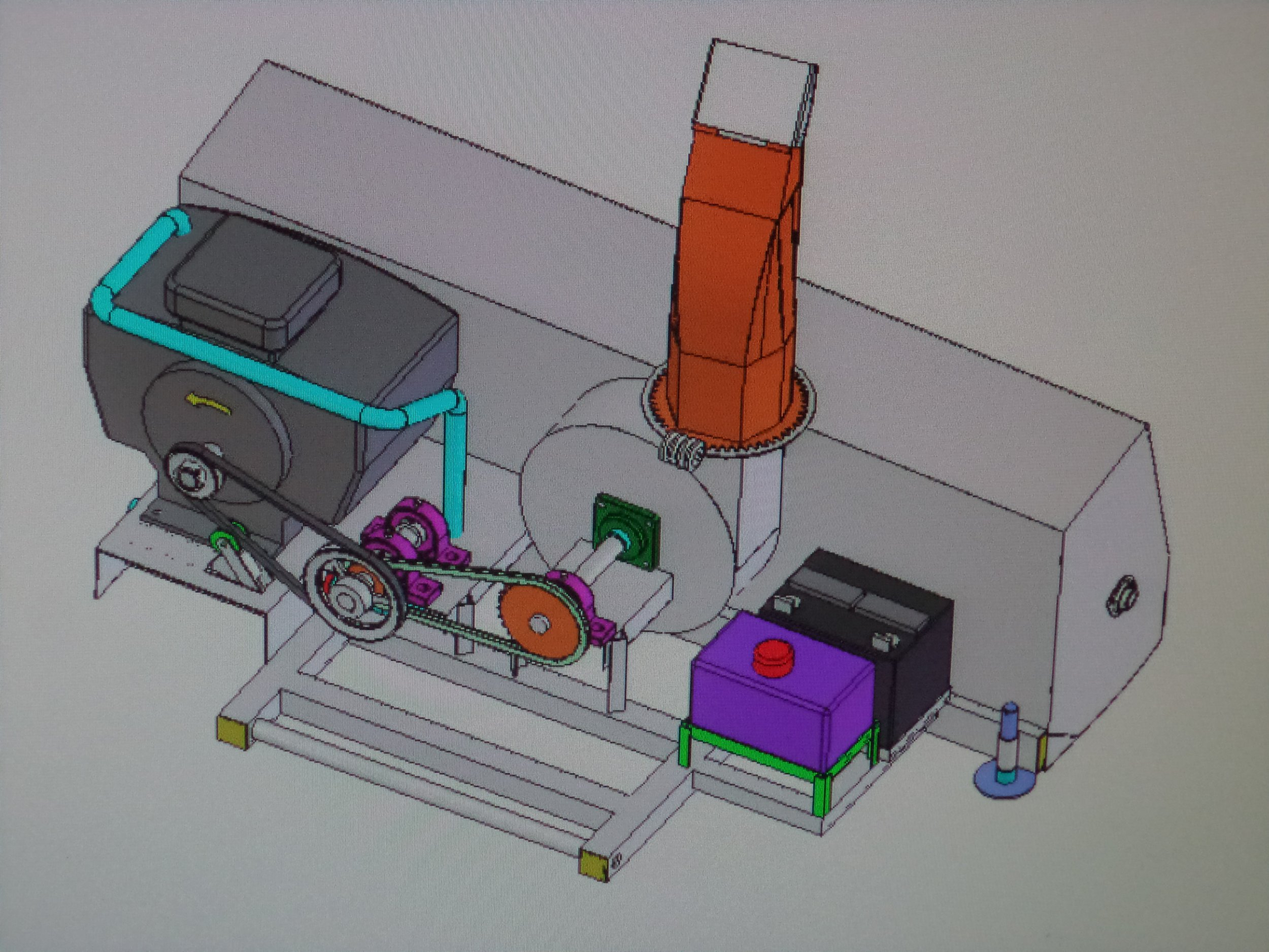

Not really Arly. I've been playing around a bit on the design of Snowzerblower which I may or may not build:
Here's a design question for the group: when you look at the 5v belt being driven by the 20hp Onan engine, you'll see a belt tensioner device. This will act as a clutch to engage/disengage the blower by tightening/loosening the belt tension. I would plan to activate it with a small pneumatic cyclinder (under the housing) using a three-way solenoid valve inside the cab piped to an air supply. Do you think it work better as shown to push on the belt or should I move it to the inside of the belt to pull on it to tighten the belt? Stay well.
Just like you have it is best. Very effective. Looks like a nice design.

I looked into electric clutches some time ago. I found that electric clutches with 1-7/16" IDs are uncommon and the pulleys tend to be too large for my needs. I have to slow the engine speed down a bit to run the impeller at a reasonable rpm (around 1000) so I mounted the smallest pulley I could fit on the engine shaft.
Pushing usually works better as the belt ends up with more surface area on the pulley. Looks like a cool setup.
   / My Senior design project - a "Swamp Thing" tracked vehicle clone #528
What is your air supply for the pneumatic cylinder to actuate the belt tightener?
   / My Senior design project - a "Swamp Thing" tracked vehicle clone #529
That is a strange size shaft. I've not seen it done before, but I'm wondering if there is any technical reason you couldn't mount an electric clutch on the jack shaft instead of the engine? That way you can size the jack shaft diameter to whatever clutch you come up with...in this case you'd want the biggest pulley available.
Drawback is the torque would be increased by the pulley ratio between the engine and clutch, so you'd have to take that into consideration selecting the clutch.
I would use a mini 12v air compressor that I would pipe up to a small tank and a pressure switch - the kind they sell for air horns.
