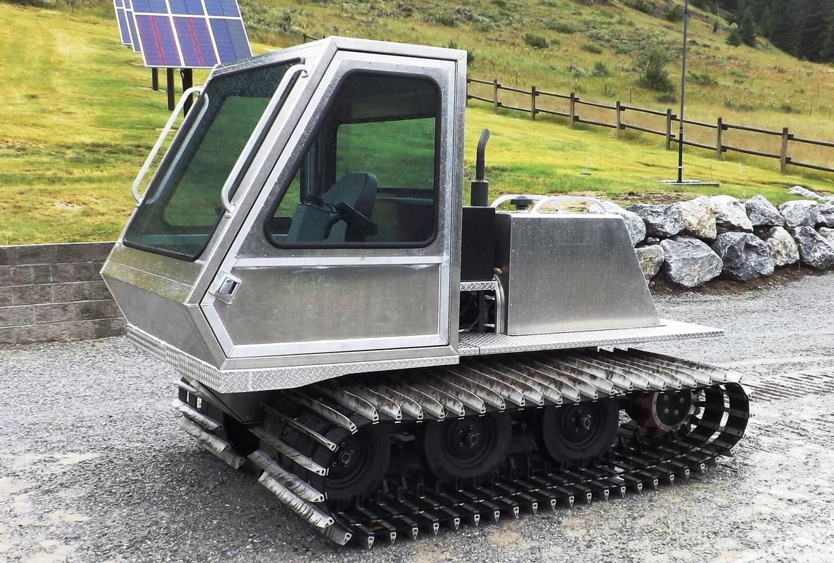

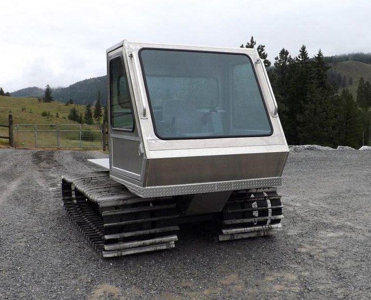

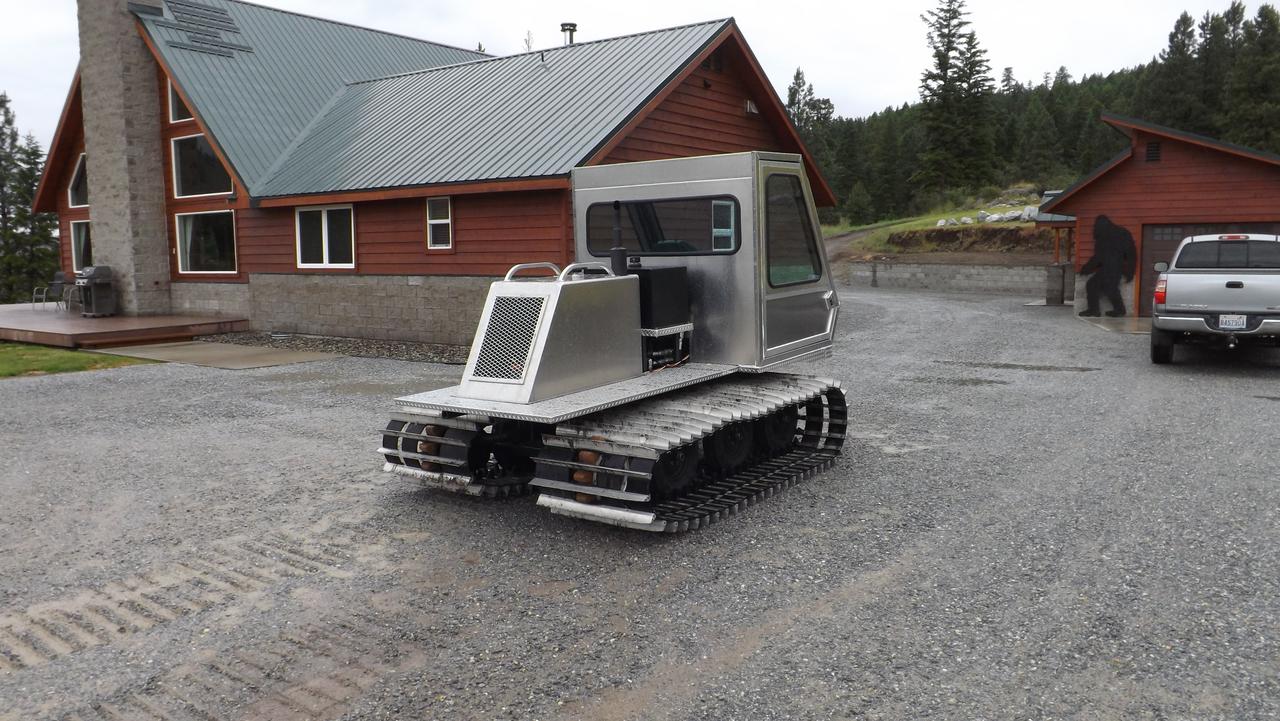

Interesting project! Here is a few photos of one a buddy assembled. Its FS if anyone is interested. I did have some construction photos if it but I can not locate them.
