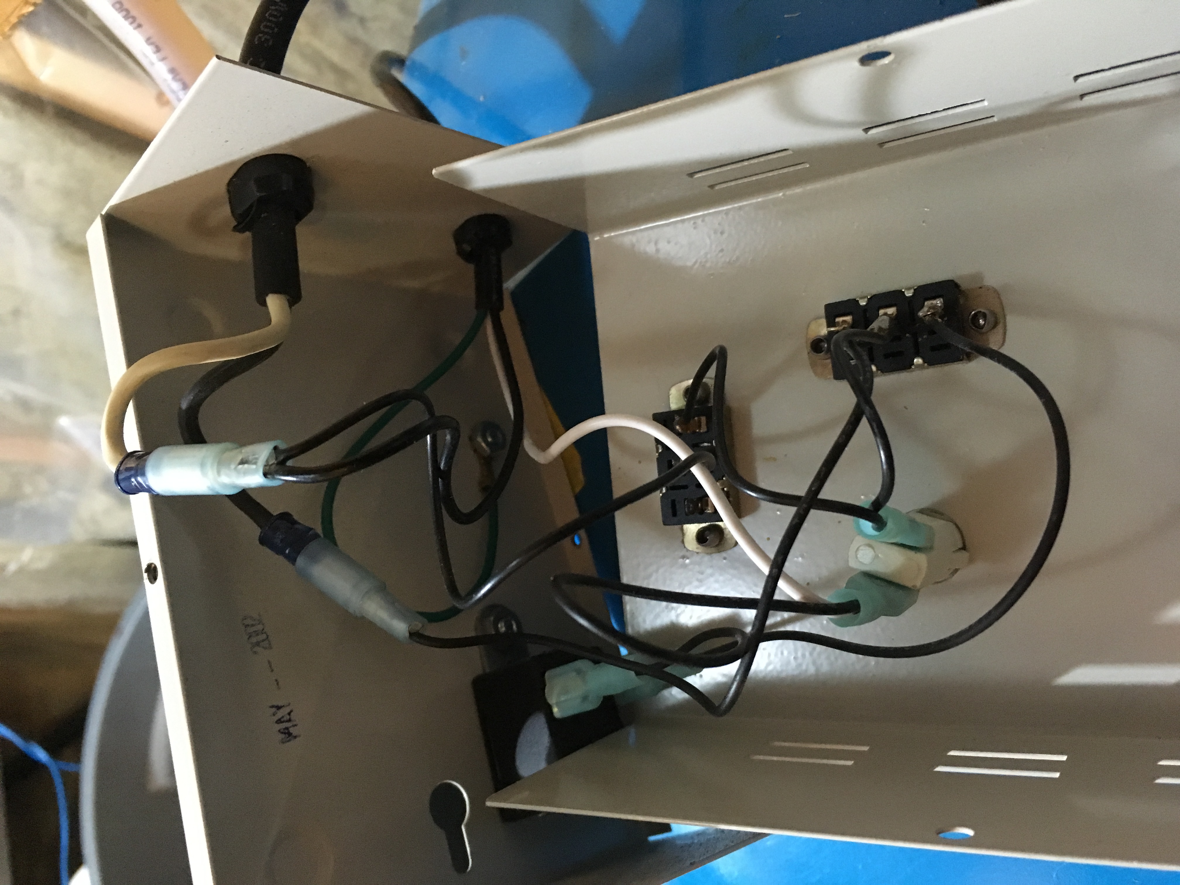

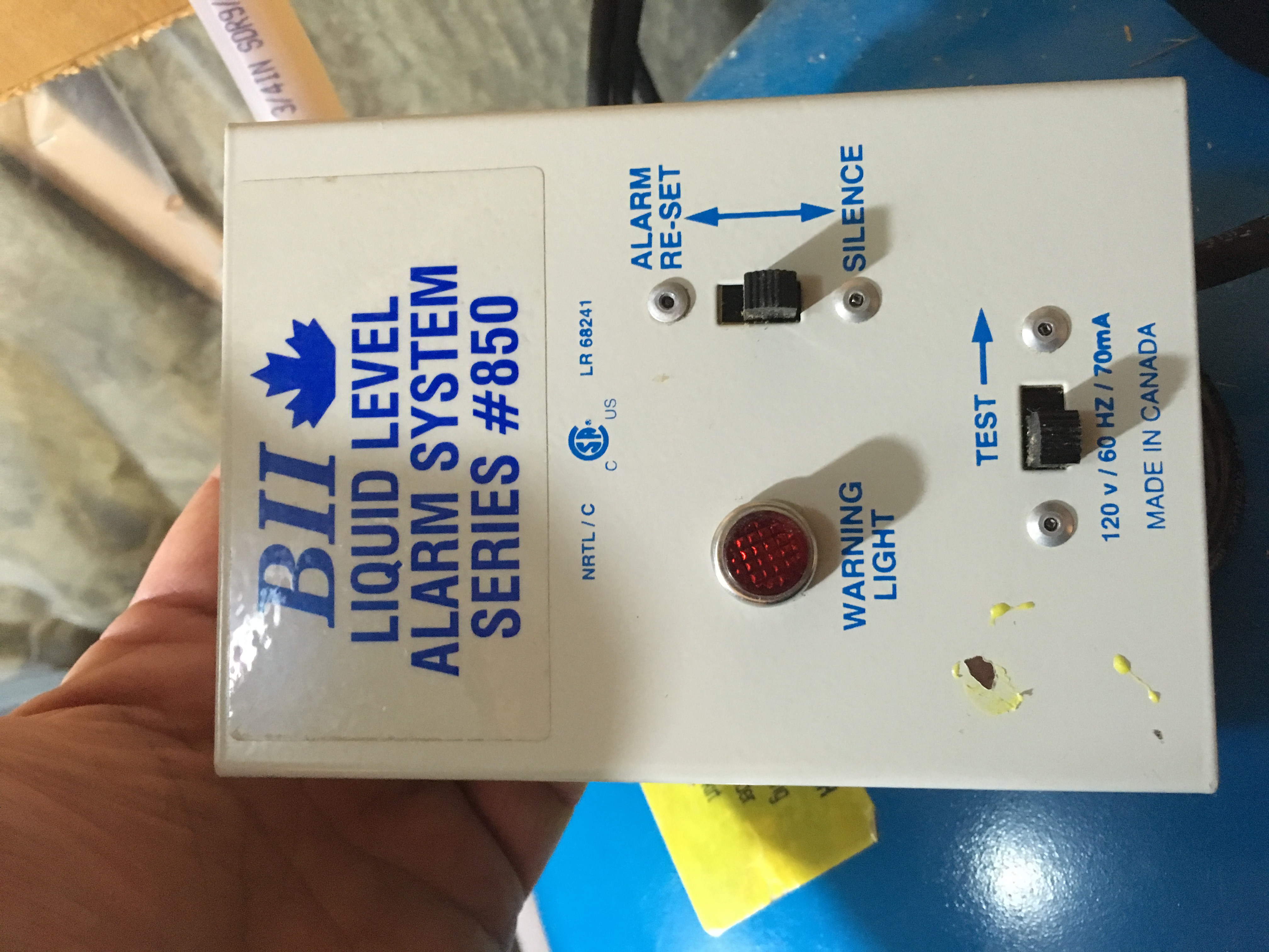

OK, OP here. I have now opened up the alarm box (which, fortunately, is inside the cottage), and tested the wires going out to the float. Joy! That circuit is open, meaning the float switch is off, as it should be. (Remember we tested the functioning of the pump earlier, by running water enough to fill it up and then listening carefully outside to hear the pump star and stop after the water ran for a while.)
So, the problem is inside the alarm box, which is of course very simple, and as far as I can tell consists of a buzzer (the dark shadow in the corner), a light (the white thing with the green terminal connectors), and two terminals/switches (one of which silences the alarm buzzer, and one of which tests the alarm buzzer). My guess is that one of these switches is defective, or MAYBE the buzzer itself.
Next step is to check and see if I can get parts for this thing.
One thing that confuses me is why there is a (hot) wire which coming from the receptacle plug and going down into the cable that goes out to the float switch. Why would we need power to go out to the float switch? Is there some sort of step-down transformer?

Just looked for that manufacturer on-line and came up empty. Any other details that might lead you to the OEM wiring diagram?
Try boshart.com. I called them and they have the 850H high level alarm, but now it seems they only send 9V DC down the line to the float switch “in order to reduce the risk of electric shock”. My (16 year-old) alarm sends 110 AC (I think!)
Will have to call them again about this, and hopefully get a wiring diagram. (Hope they are open tomorrow.)

OK, went up and did a few tests this weekend. The two switches (one for "Test" and one for "Silence" both showed the correct impedence when using the switches. And now the warning buzzer seems to work intermittently when all switches are off/open. (Actually, it kind of hums like it wants to come on but can't.)
And Boshart was not open this weekend, so I will have to call tomorrow. Seems like a lot of money for a box with 2 switches, a lite, and a buzzer! ($173)
