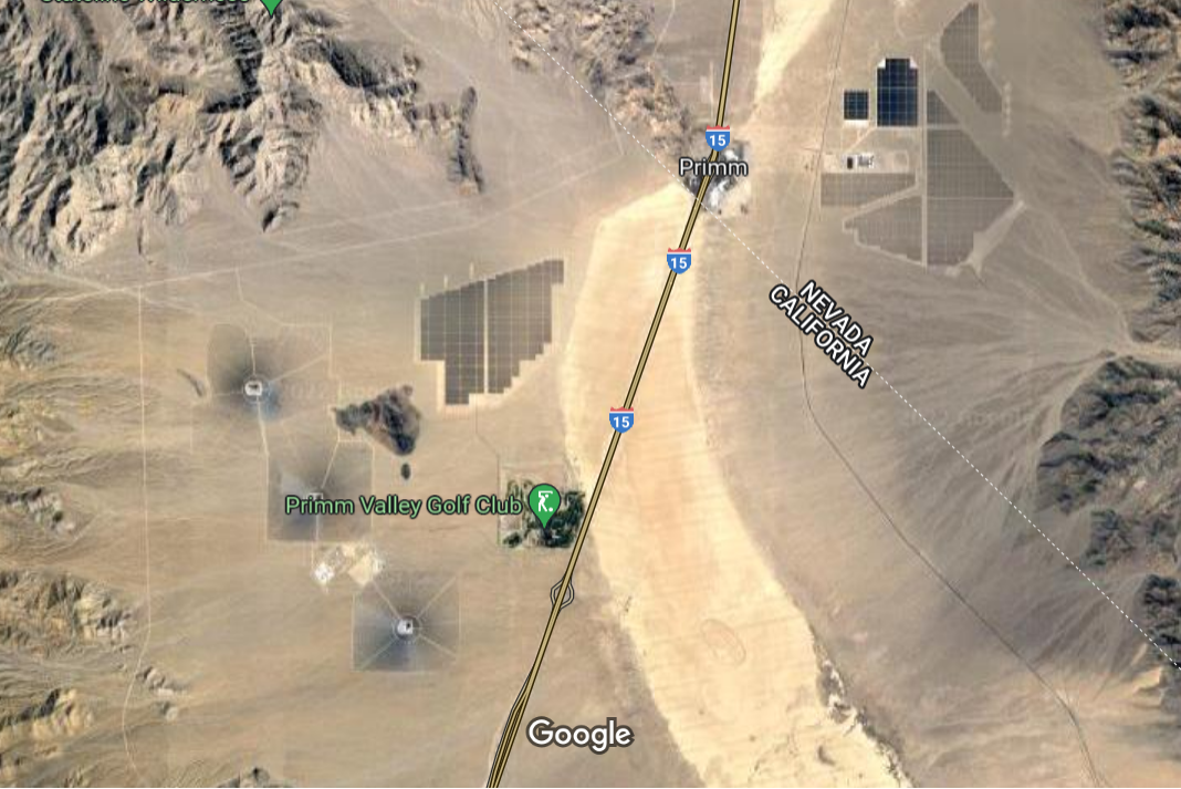

My 7530 system generated 14.6 MWH in the last year. Love that desert sunshine.
   / My solar is working for me #31
Wow - that's great. Question - are these all solar arrays in the Mojave?
  • Solar in Mojave.pdf
