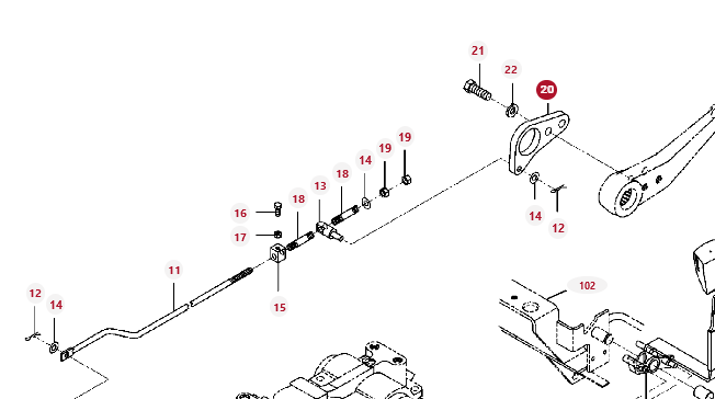

I use it a lot on my gc2400 with tiller. the gc2400 has a rod that goes into arm connected to actual lift, springs at both sides of the lever tighten and flip lever back to center. so I just loosened spring on the lower side to "create" a float.
not sure if 2300 series setup like this. this is what looks like on 2400 series. Item num 18 on both sides of slide are springs. front one is one to loosen.
