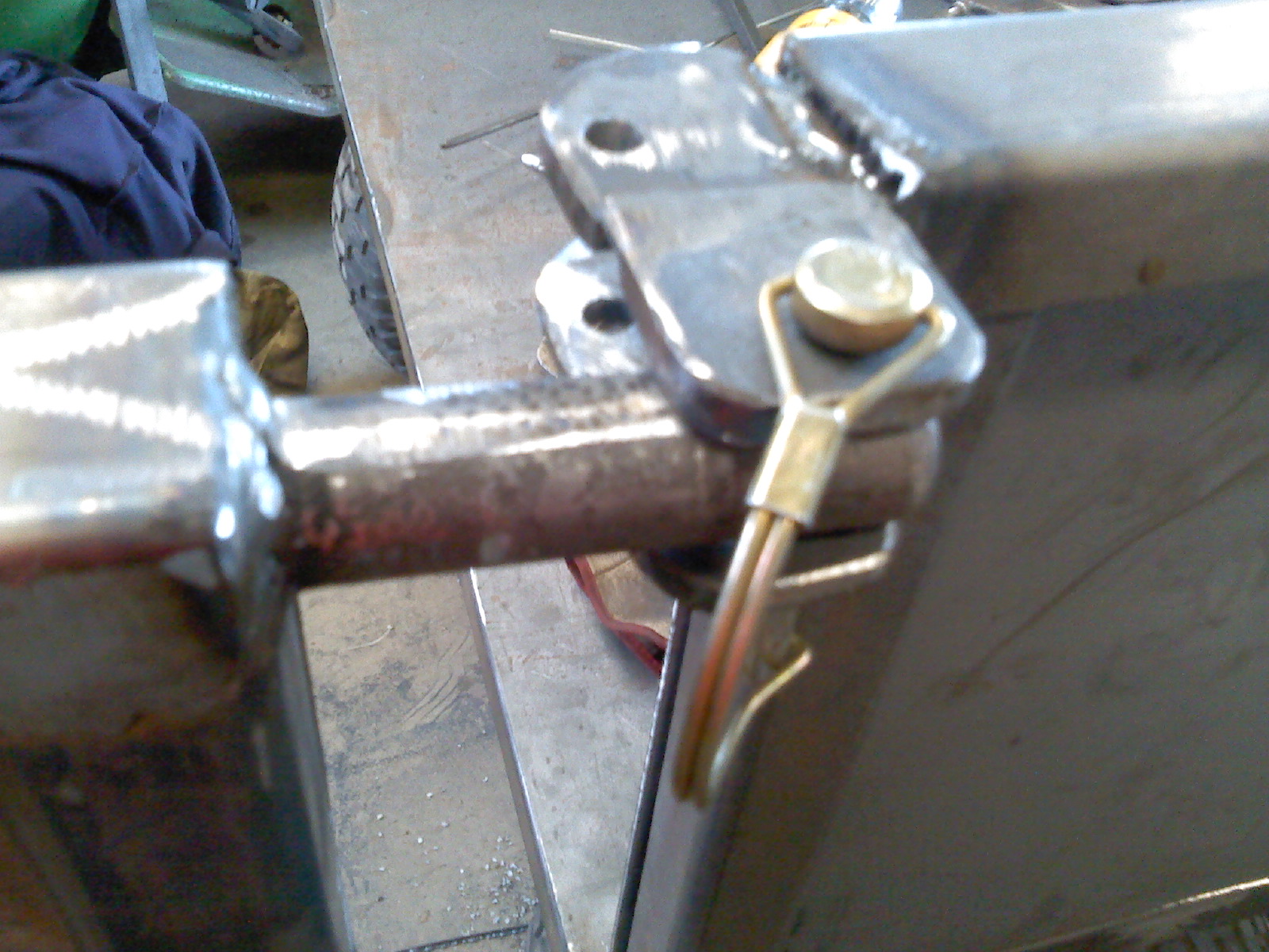

Some kind of deflector is what I would be putting there. Maybe a piece of 1/8th" flat steel 1" or so wide bent into the shape of a number 7 and welded in just ahead of the ear.
NormL I am not sure what you are talking about but in the pics I have more grinding to do on the ears so there are no sharp corners. I can't put a piece of steel over the end of the ears as the pin will travel through the ear as the gate opens and folds back on the side.

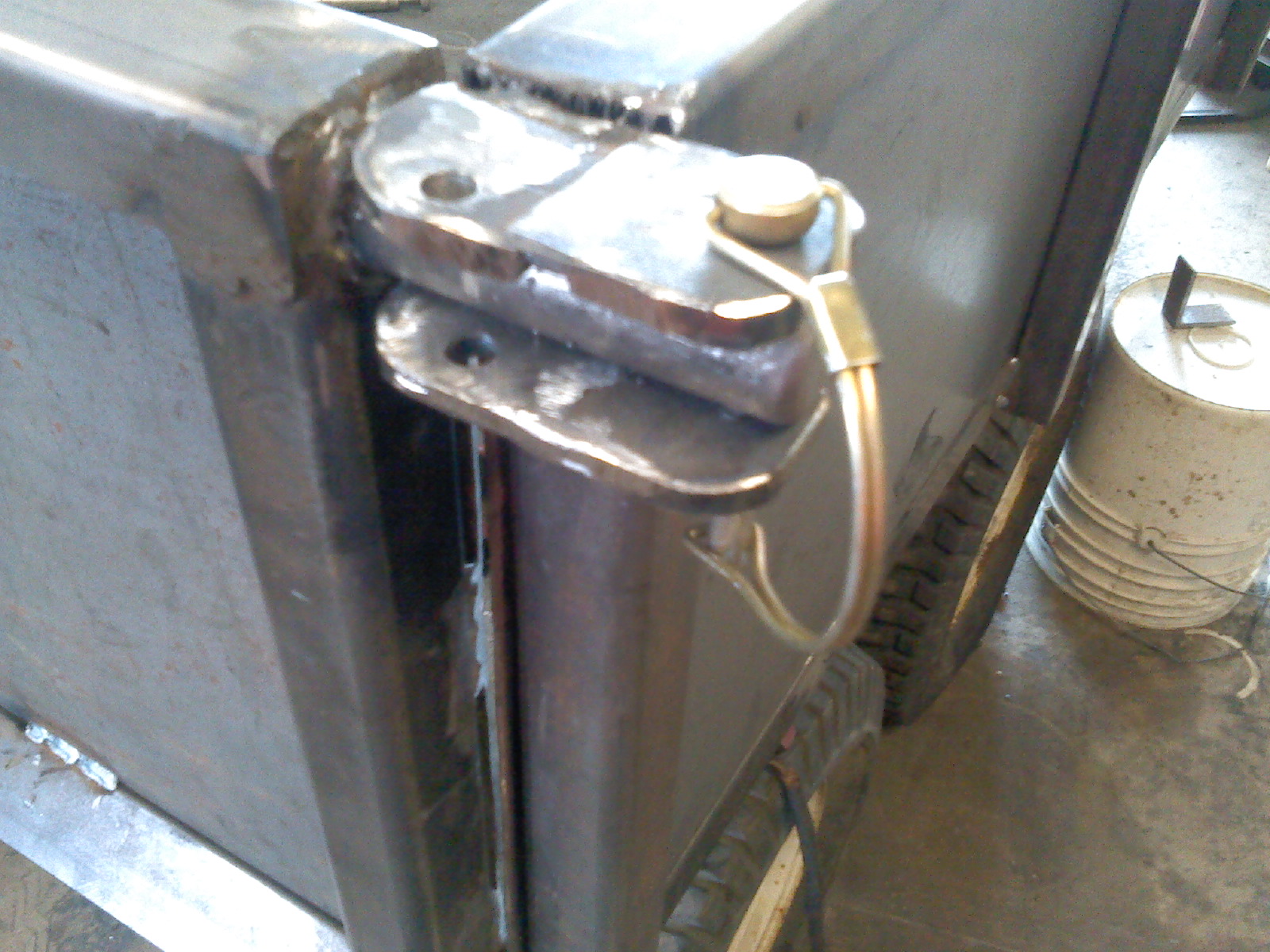

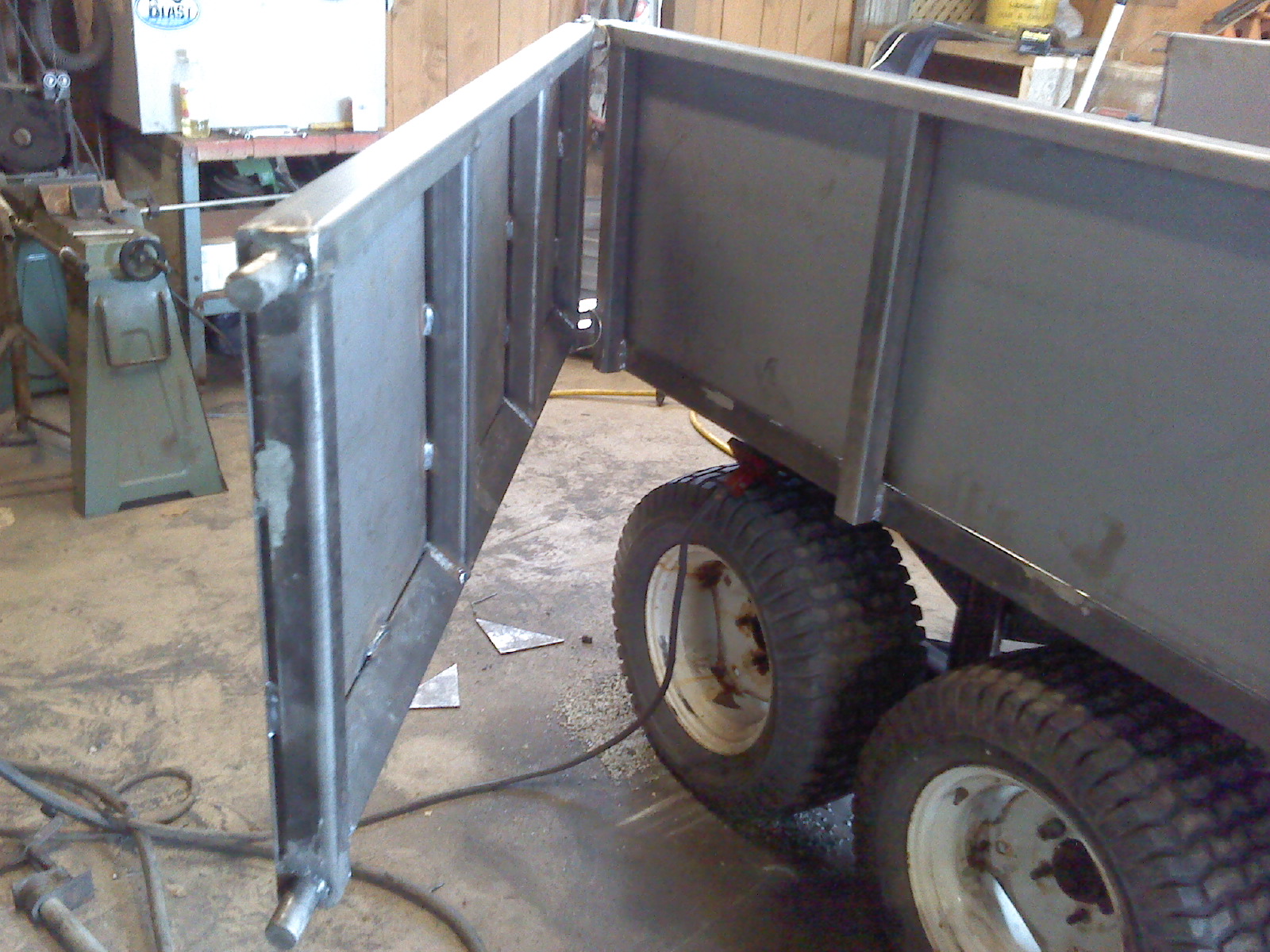

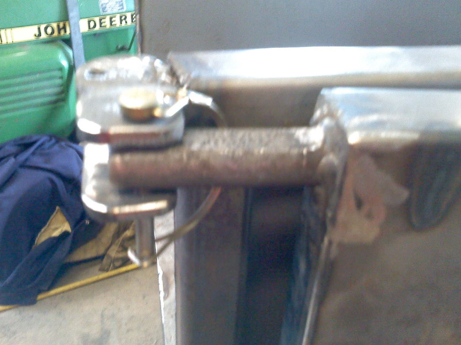

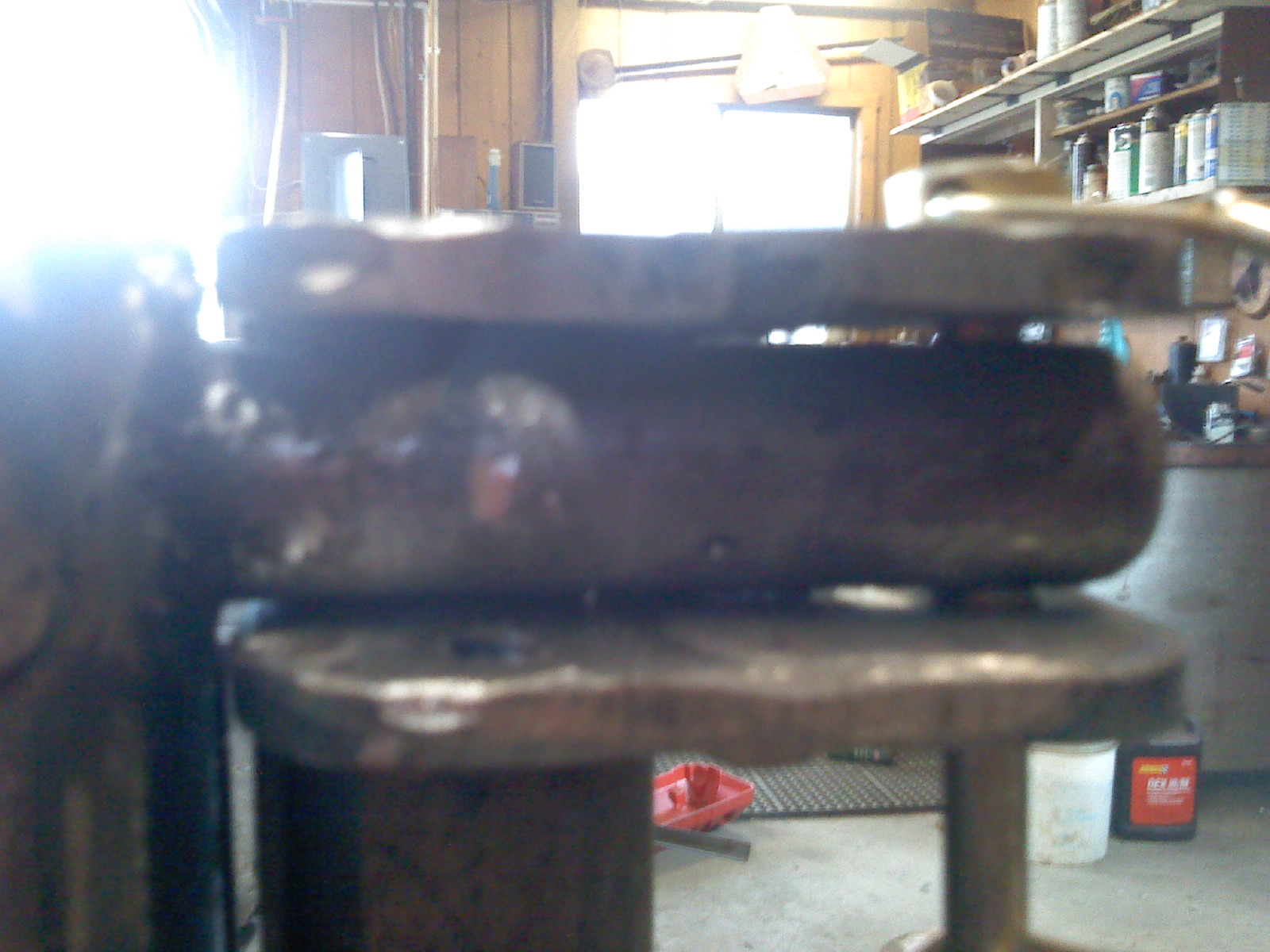

I got the hinges cleaned up and the corners rounded off and I had to "tweak" the tailgate so it would opperate smoothly, it was warpped just a little from welding but It worrks great now! :thumbsup:
Looking at your latest photos it does not appear as much an issue. What I was suggesting was to position something to act as a deflector when someone walks by just a bit too close and could hook onto that ear. The deflector I'm thinking of would not cover any part of the ear; just be there in front of the ear to protect yourself from possible injury. Because you latest photos show more of the surrounding aspects of the gate area I can see that the ear does not protrude quite as far as I thought. That trailer really looks indestructible!!

I am having bad dreams about my hinges on my trailer and I am going to redo the lower set on either side. The way it is right now when the tailgate is lowered like a pickup tailgate it is not flat it sticks up about 2" so I will remount the lower hinge on the botom of the gate and that should let it lay flat even with the dump floor.

600rider:
OK, now I see what you meant where you wondered what I was talking about! I took a closer look at the last photo where you have the gate folded right around to the side of the trailer. Anything placed there would be an obstruction to the swing of the gate. Sorry about the confusion:eek:
