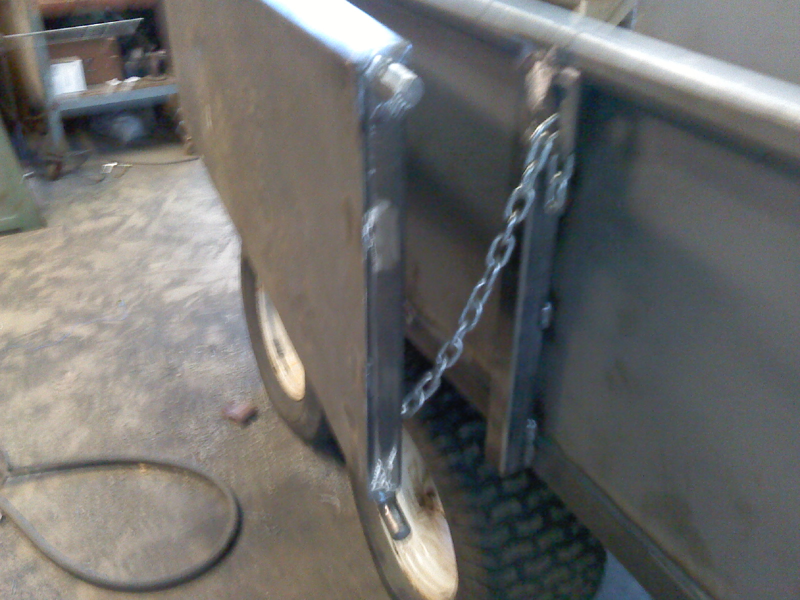

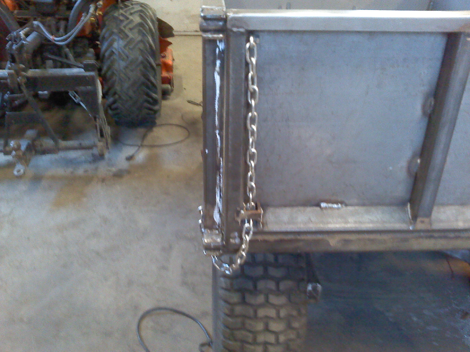

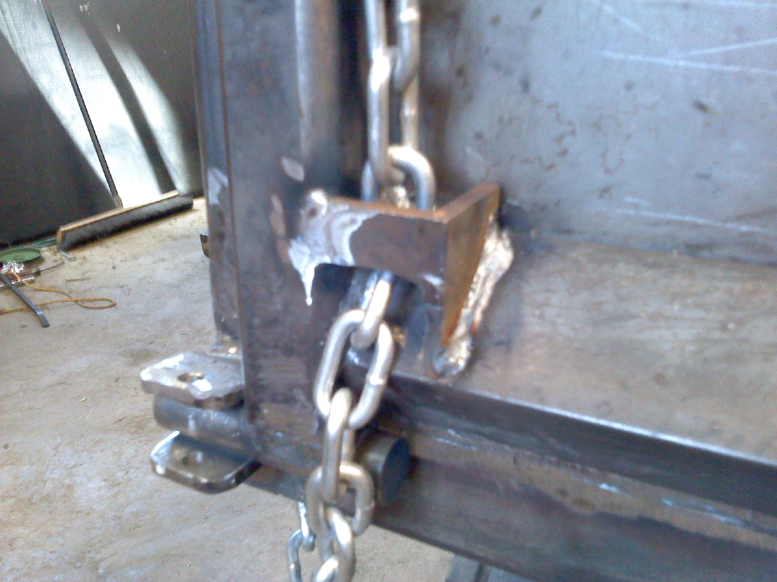

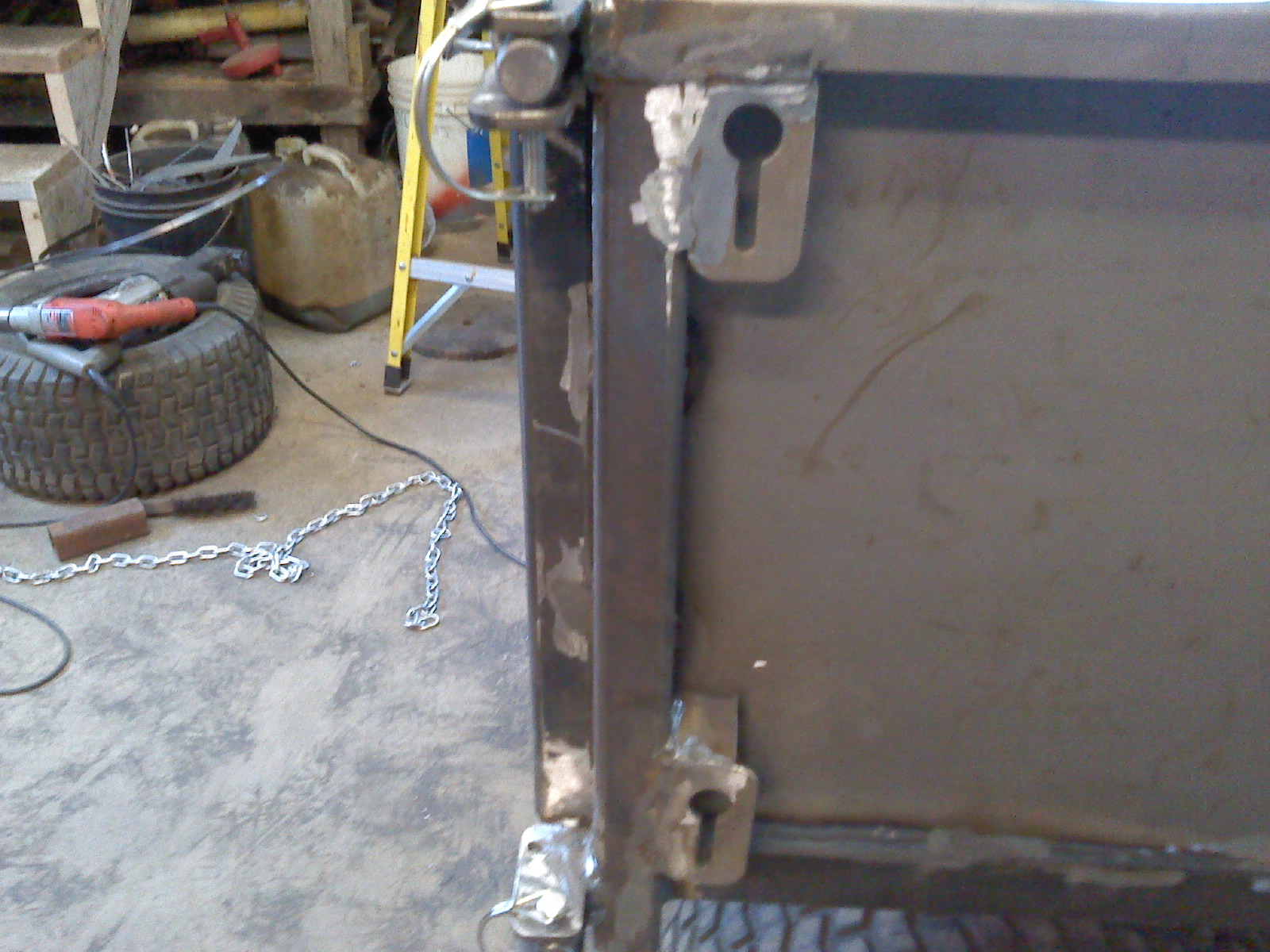

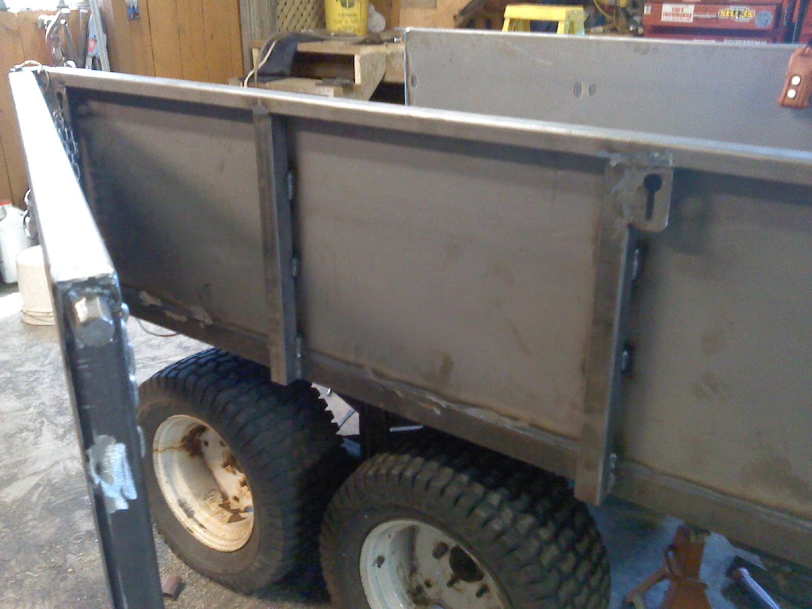

Here are some of pics of the keyhole slots for the chains and how they are going to work. I wish I had made the round hole a little bigger around, still might! I used 3/16 steel with a 7/8 hole and a 5/16 x 1 1/4 slot to make the keyholes. There are five of them on the dump, 2 on each side at the rear and 1 on the right side about 4' from the back to hold the gate when I open it sidways.The keyhole lets me adjust the amount of angle either up or out for tailgating gravel .

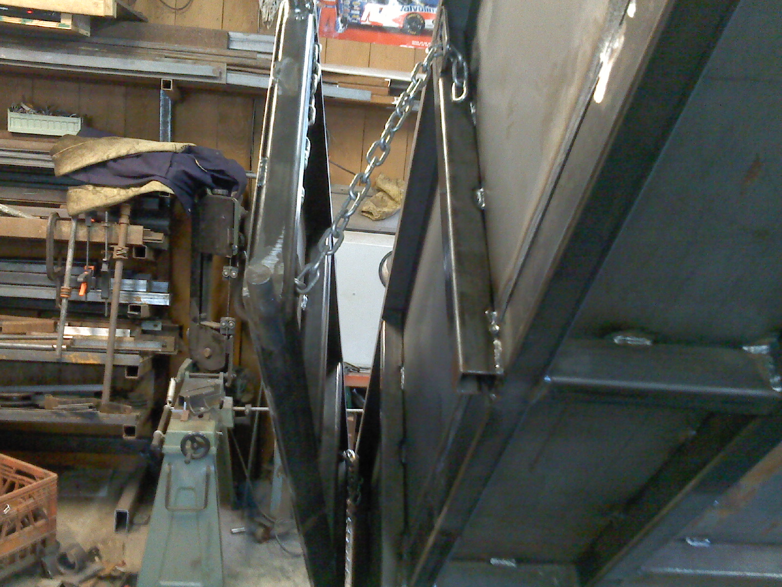

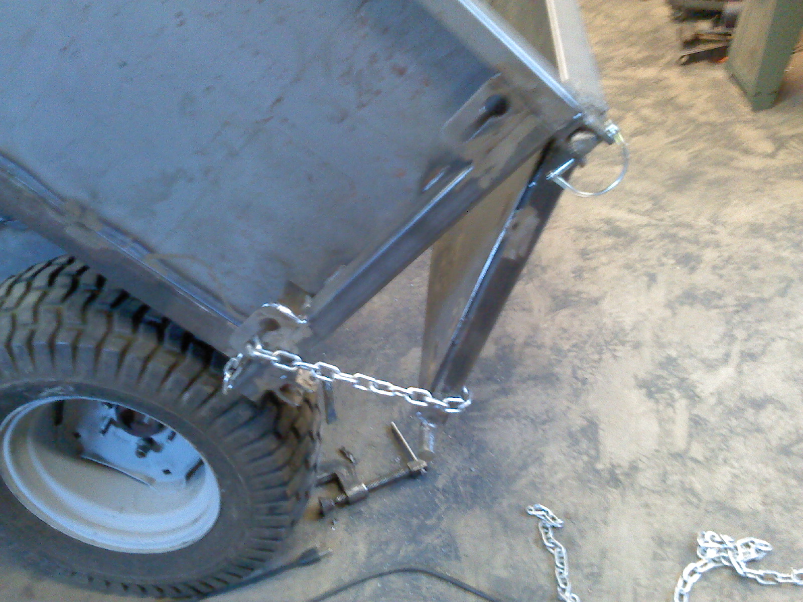

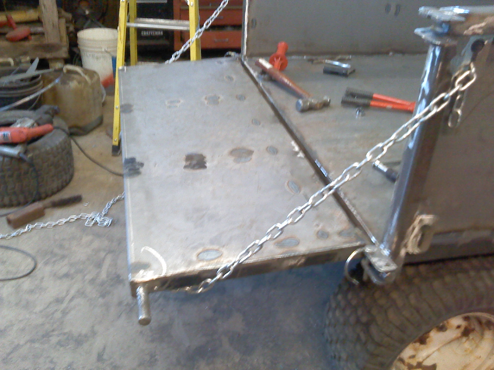

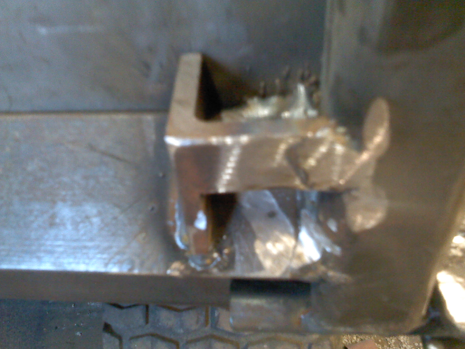

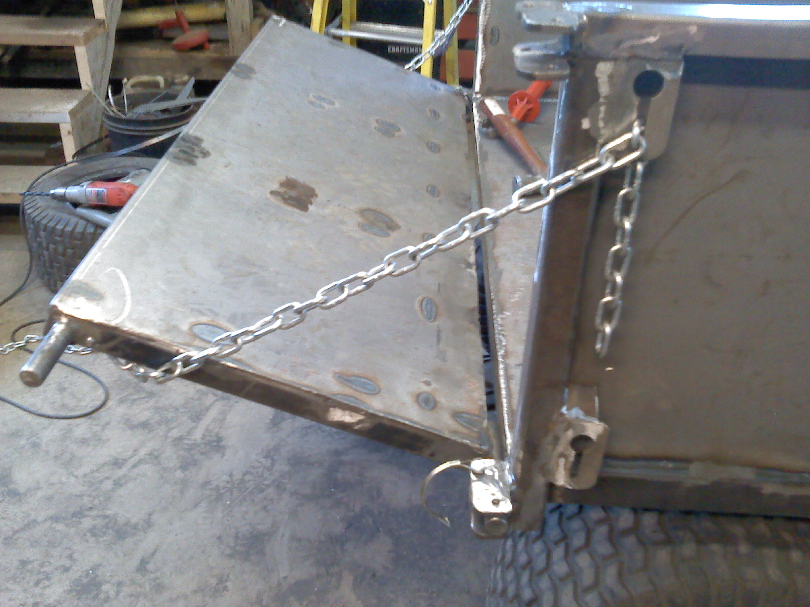

To use the tailgate like a trucks is pretty straight forward, Chains in the top keyholes but to get it to "tailgate" gravel I welded a pc of angle iron in the corner of the support and notched it so the chain would go through and out the bottom and to the lower keyholes. If you want more gravel let the chains out, less you shorten up the chain. Works great
When I swing the gate to the side I wanted something to hold it open so I could dump and decided to put a keyhole on the side and just slip a chain through and it holds it
