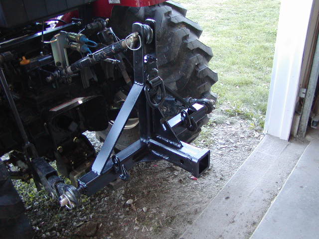

Here is the hitch painted and mounted on the DX33. It is one handy unit. Been moving trailers around with it and it works great!

One more.

Is the height of the vertical part (where the top link attaches) critical to keeping the receiver level when you raise and lower the hitch?
   / My welding project.
#38
I actually took the measurements off of another attachment and then did a little comparison to another. Mine is what I would call a standard application. I think I was 15" to the top center from the bottom. I'll have to measure again.
