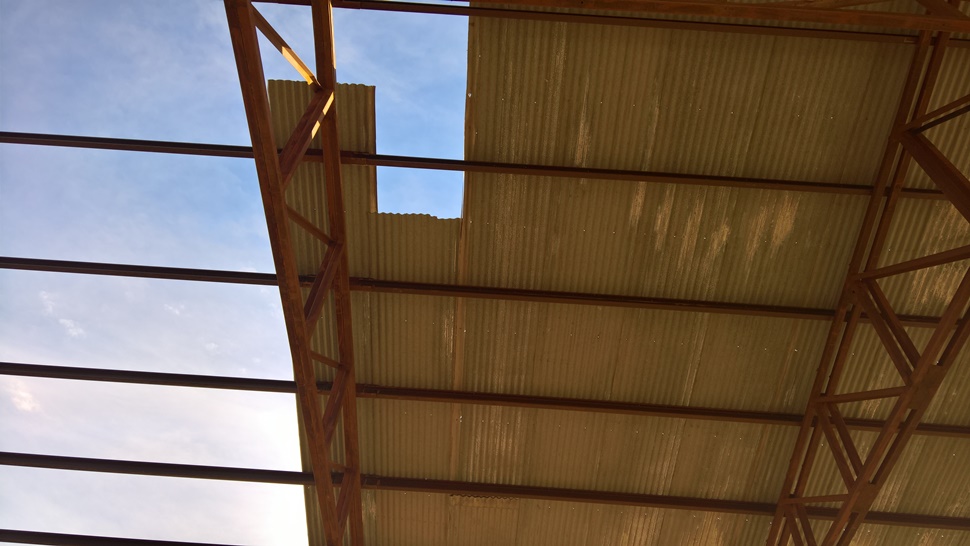

From now on it will be piece meal for the roof the longest sheets I have left are under 25 feet long This would be just about right as the old building I tore down was 68 feet by 120 feet a large part of the roof had caved in due to Ice and snow there was only about 100 feet of one side that the sheet metal was not bent up due to the collapse of the roof I have used 22 sheets on the north side and 9 on the south so that would just about account for the full length sheets I had.
I managed to get 2 sheets down to make a full length run and 2 more for a partial before the cold front started to come in kicking the wind up to some 25 MPH gusts maybe the wind will be more favorable tomorrow.
