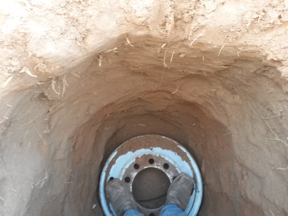

What foundation did you make?
   / My work shop build in progress
#80

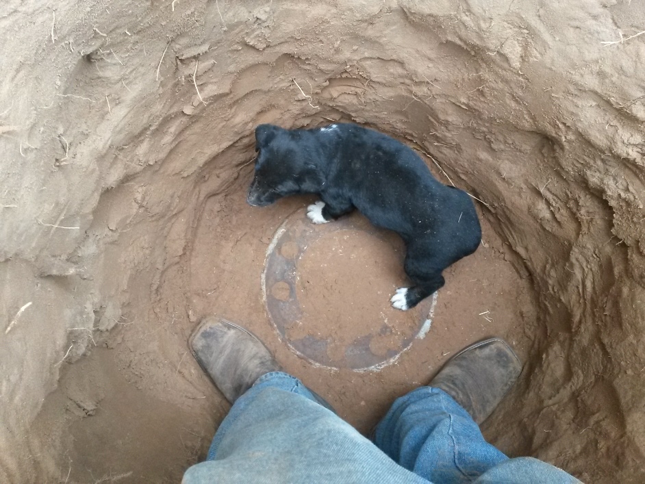

Its built pole barn style each column are in the ground between 6 and 8 feet with semi truck rims welded to the bottoms of them vibrated into the ground with my plate packer then back filled with some Portland mixed in with the back fill packed in 6 inch layers
one of my puppies had to check things out

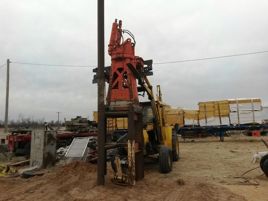

this is the other Hero Column of the building
It will be the roots for the base for a 10,000 lb brick crane removed from a 50 ft flat bed trailer
