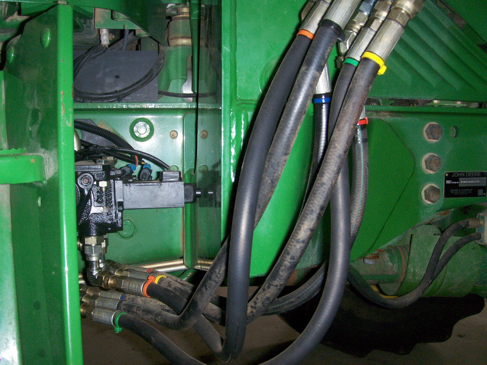

Zebra,
How are your hoses routed to your single point connection?
Here's what mine looks like:
They are rather exposed to getting snagged by brush/slash in the woods.
The installation manual shows a hose holder as seen here:
Does your tractor have this? I looked at my mounting frame, and I don't see bolt holes for such a bracket, which I suppose is why it wasn't installed.
I plan to re-orient the hose fittings to be more horizontal instead of being angled down, and then figure out some way to tuck the hoses against the frame.

My loader valve is mounted horizonal compared to yours. (I'll take some pictures and post later). The outlets for the hoses face down. From the frame out, two rows of three. The forward row has 90s the rear row has long sweep 90s. My hoses do not hang below the frame at all.
Your hoses look too long.
My loader does not have the lower hose holder.
No idea on the two lights. If the oil level is OK and they go out after 10 seconds hard to say what is going on.
/ MY2012 5085M ordered today! #335
With the length of your hoses I would try routing them up at about a 45 degree angle forward (between 1 & 2 O'clock) then let them loop down, then back up to your MultiCoupler.
Looks like your third function has flow control? Black knob. Make sure you don't run a hose over or too close, so you can still adjust it.
Looks you like you also have 90s on the forward row and long sweep 90s on the rear row. Should be easy to change.

I'll play with routing the hoses up at an angle instead of down or horizontal and then tie them in towards the frame to get rid of the slack. It sure would have been nice if they had a hardline option for the single-point connector.

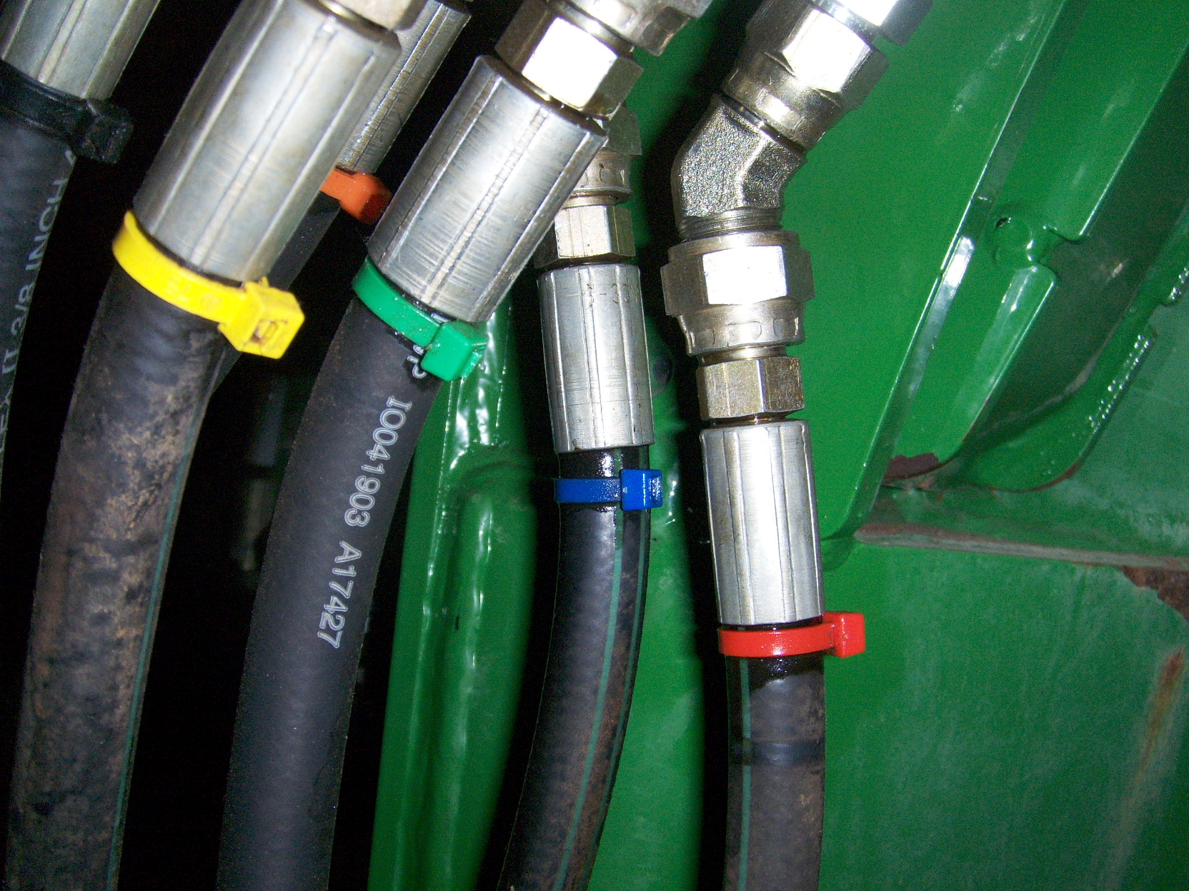

Here are pictures of the hoses from the mid valve to the multicoupler. There were two big wide tie wraps on the hoses. I cut them off when I swapped from quick couplers to the multicoupler. I have not bought replacement large tie wraps yet. The boom hoses were too tight so I added some 45 degree fittings to make them longer (cheaper than new hoses) I also had to adapt from JIC to ORFS. My hoses were JIC, the multicoupler is ORFS. This is not as clean/simple as I would have liked, but I did not want to buy 12 new hoses.
I been working on an idea for a different bracket for the multicoupler to turn it 90 degrees, like yours is. Then it will stick out almost 6" less.
