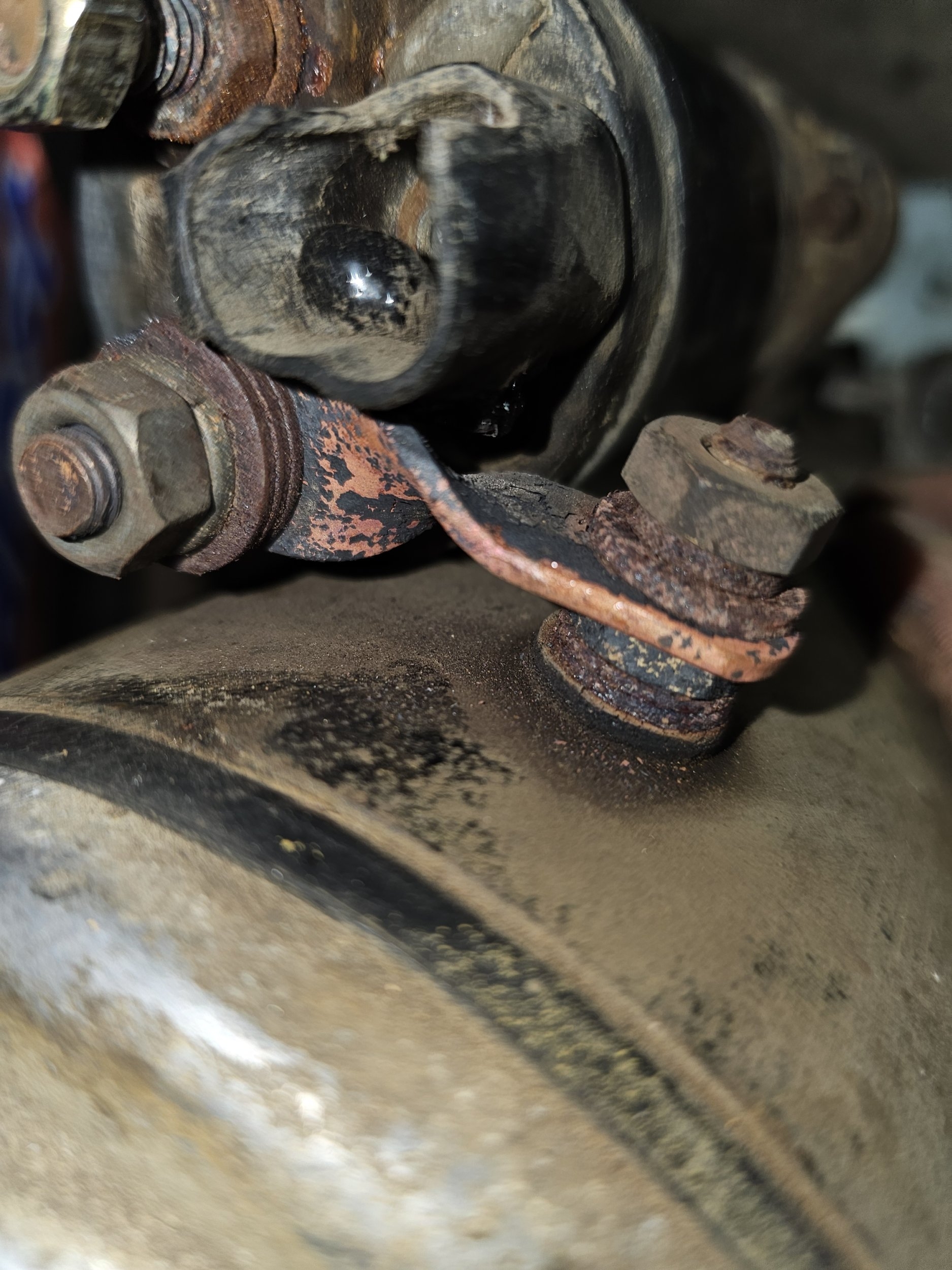

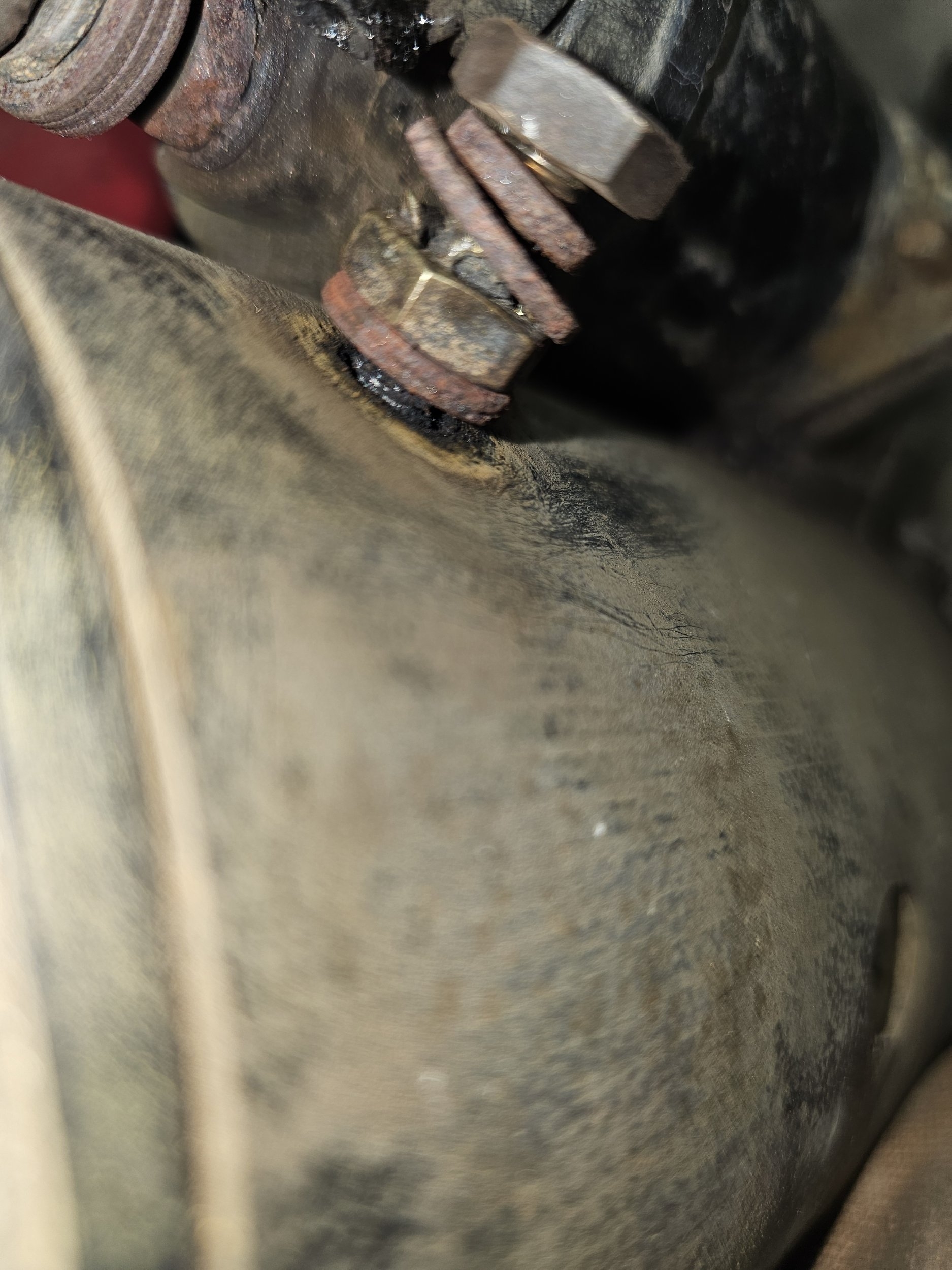

Well, that turned out to be much easier than I was fearing. 15 minutes and it was out. Partly helped by Fred's idea of removing the filter bracket bolts and pivoting the filters out of the way - but I didn't need to loosen any fittings. The lines were already loose as a goose and pretty freely spinning in the fittings! One more thing to add to the list.
I did a quick bench test a couple times and it activated the starter but it was spinning very slowly and sluggishly. Then I touched the + side lug and darned near burned my finger. I could see that the connecting strap has gotten extremely hot over the last who knows how many years, to the point that it has basically annealed the copper and even melted part of the nearby plastic housing around the solenoid trigger wire. Further disassembly brought me to the finding that the base of the positive lug of the starter was completely loose. The insulator or whatever had been in the hole was completely charred and burnt out. Might have been able to get away with rebuilding this one, but my order is already in, so maybe I'll just rebuild and keep it as a spare.
