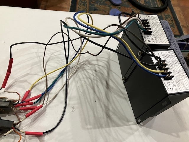

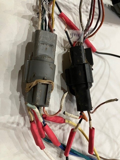

You should get power on the gray or brown wires only when the key is on and the shuttle shifter is moved to forward or reverse. You should have a list of the settable parameters on the paper that came in the box and also there's a reference sticker by the terminals. To cycle through the options you need to hit the button that looks like a gear while the controller is powered up. That gets you to the first option, then you can either use the arrow keys to adjust or hit the gear button again to move to the next one. When finished, press the on/off button to exit the setup menu.
I would advise not connecting any of the solenoid wires to anything while you're just powered up from the temporary wire. The way I have this set up, the controllers will be completely off unless the machine is shifted into forward or reverse. Then an individual controller will be powered up by the gray or brown wire, as applicable, and immediately turn on to soft start the corresponding solenoid circuit. That is a built-in feature of these controllers, and is the only reason they can be used with the shuttle shifter with no other circuitry and no alteration of the original wiring.
Thanks for the solenoid's hookup warning. I only used the ground on the connector and a hot wire from my starter key, which is just hanging. So, nothing disturbed the solenoids. I sure appreciate that serious set of warnings. I'm biting at the bit to set the controllers, but you know, chores and there's the weather.
