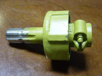

On my DK45 i can turn the pto shaft by hand with the tractor off. You can also add an overrunning clutch (which i use on my rototiller and mower dur to shafts being too short) . This allows for real east freewheeling of pto.
A good overruning clutch had a hand detente to keep it attached and is easily removable. I didnt want the kind that perminantly attach.
