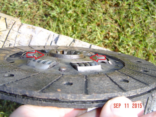

My Guy working on the clutch and pressure plate called me last night, after getting to the clutch/pressure plate. One of the previous owners, had installed flat washers (shims) between the pressure plate mounting ears and the fly wheel. :confused: We aren't sure why. The clutch and pressure plate looked good. The pressure plate was clean on the back of the mounting ears and had additional marks where the washer were. In any case, we'll put a new assembly on. If it hadn't been for the washers, the clutch probably would have worked fine.

The clutch plate, inner disc was pushed out, from where it was supposed to be. My guess, maybe they put the clutch in backwards and as the pressure plate was being tightened, the fly wheel pushed the center section out. I'll get a picture of it, when I gather things up.

Here's a pic of the "warped" side of the clutch disc.

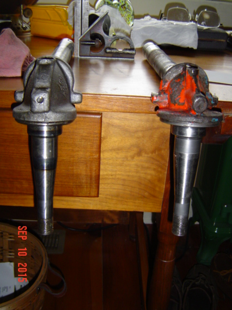

My tractor mechanic called and said "the new spindles wouldn't work and they must be the wrong part number, as the wheel toed in about 3 inches". So he put the old ones back in for me to bring the tractor home. He did change the clutch/pressure plate, the bushings in the front spindles and the center pivot bushing, which I was totally thankful for!

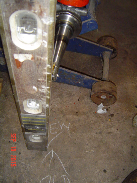

I pulled the left spindle, when I got home, so I could compare old to new, to see the difference and try to figure out what I needed. For the life of me, I couldn't see or measure any notable difference ... maybe, an 1/8" difference in the key-way radial placement!
Then I went to tractor and it was obvious that the new spindle created a tow-in, when dropping the steering arm in place. I plumbed down to the floor, from the end/center of the spindle stub and there was about a 3/4" difference, new to old.
This spindle/stub difference, created, like a 3" difference to the wheel alignment. A 5/8" adjustment to the tie rod corrected the problem. ... and only one side/spindle seemed to be an issue. I guess, that's why they made the tie-rods adjustable!
When looking at the situation, it's very hard to imagine, that a 1/8" radial difference in the key-way placement, would cause an "amplified" difference of 3" in the wheel alignment! :shocked:
