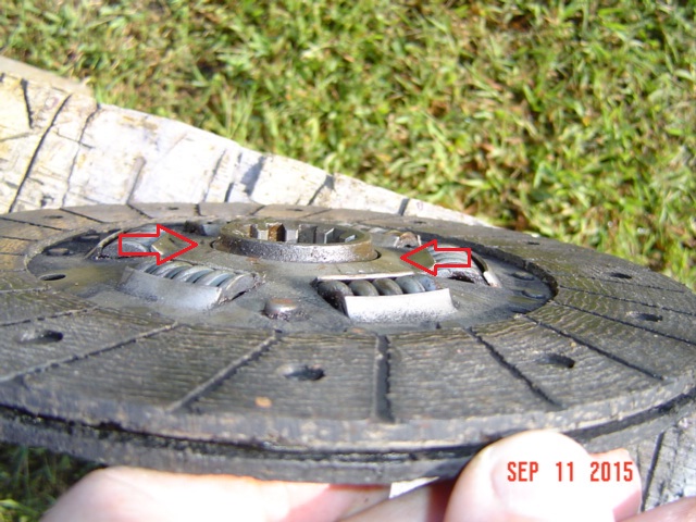

Here's a pic of the "warped" side of the clutch disc.

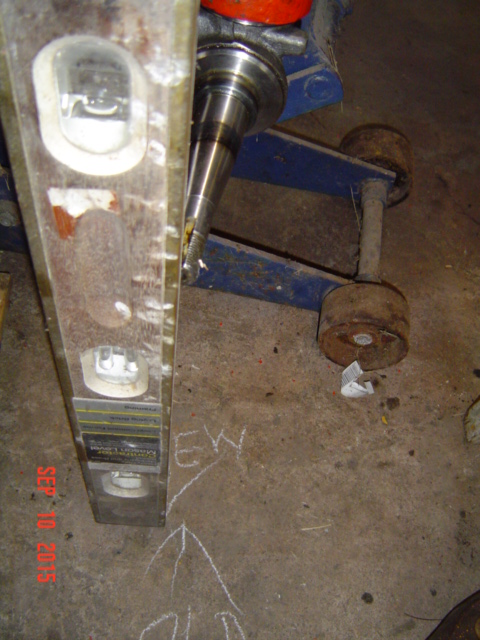

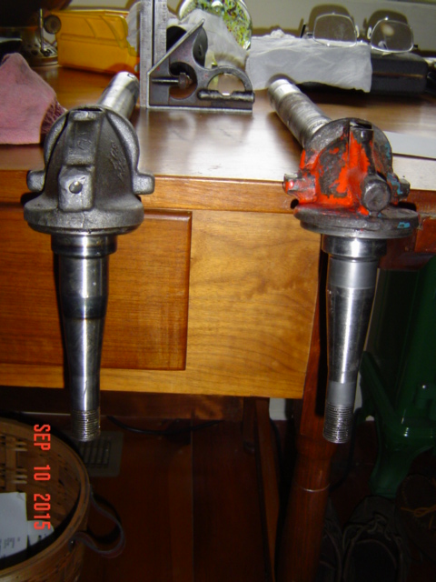

My tractor mechanic called and said "the new spindles wouldn't work and they must be the wrong part number, as the wheel toed in about 3 inches". So he put the old ones back in for me to bring the tractor home. He did change the clutch/pressure plate, the bushings in the front spindles and the center pivot bushing, which I was totally thankful for!
I pulled the left spindle, when I got home, so I could compare old to new, to see the difference and try to figure out what I needed. For the life of me, I couldn't see or measure any notable difference ... maybe, an 1/8" difference in the key-way radial placement!
Then I went to tractor and it was obvious that the new spindle created a tow-in, when dropping the steering arm in place. I plumbed down to the floor, from the end/center of the spindle stub and there was about a 3/4" difference, new to old.
View attachment 440433 View attachment 440434
This spindle/stub difference, created, like a 3" difference to the wheel alignment. A 5/8" adjustment to the tie rod corrected the problem. ... and only one side/spindle seemed to be an issue. I guess, that's why they made the tie-rods adjustable!
When looking at the situation, it's very hard to imagine, that a 1/8" radial difference in the key-way placement, would cause an "amplified" difference of 3" in the wheel alignment! :shocked:

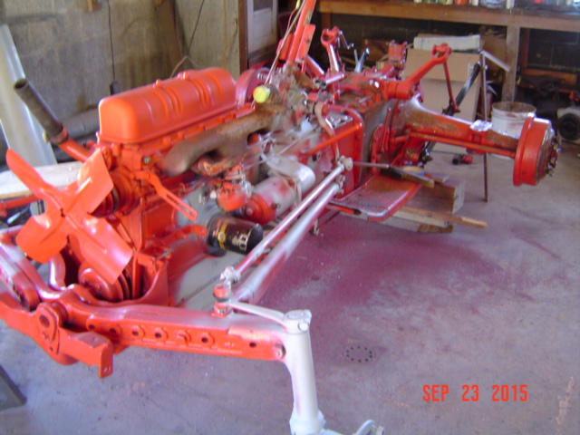

Just an up-date .... I've been adding new parts, "hand over fist", it seems (whatever that means). New front wheel seals, new battery tray ....., which just arrived, as I was typing. Some little parts, such as steering wheel grommet, starter wire grommet, throttle grommet and the like. I've got one new rim coming and going to pick up a pair of rear tires on Sat. Hopefully, I'll be satisfied enough with the prep work on the red, to paint this week. The sheet metal has all been repaired and primed. I never intended to get into the project, this far, when I started. :mur:
   / ?? NAA Lift Arm Pivot Stud in axle housing spinning
#60

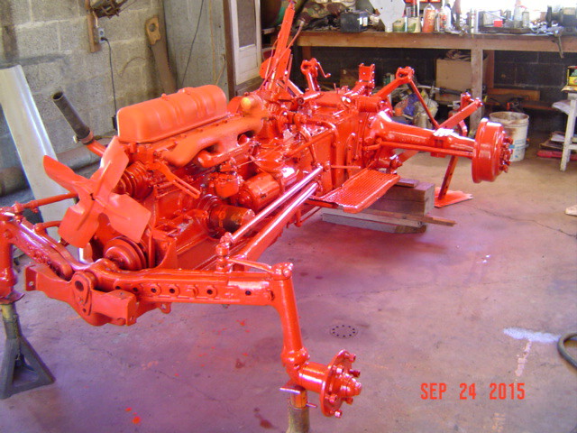

Well, I got some red sprayed, .... but ... ran out of paint! :thumbdown: I had only gotten 1 quart, ... mostly because, I had 1/2 quart left from the 1st paint job. ?? Maybe, it was the remainder of 2 quarts. You have to keep in mind, "every part on a tractor seems to have at least 4 sides to be painted"! The valve cover and exhaust manifold are painted with high temp 2000°, caliper paint, which has a flat finish.
