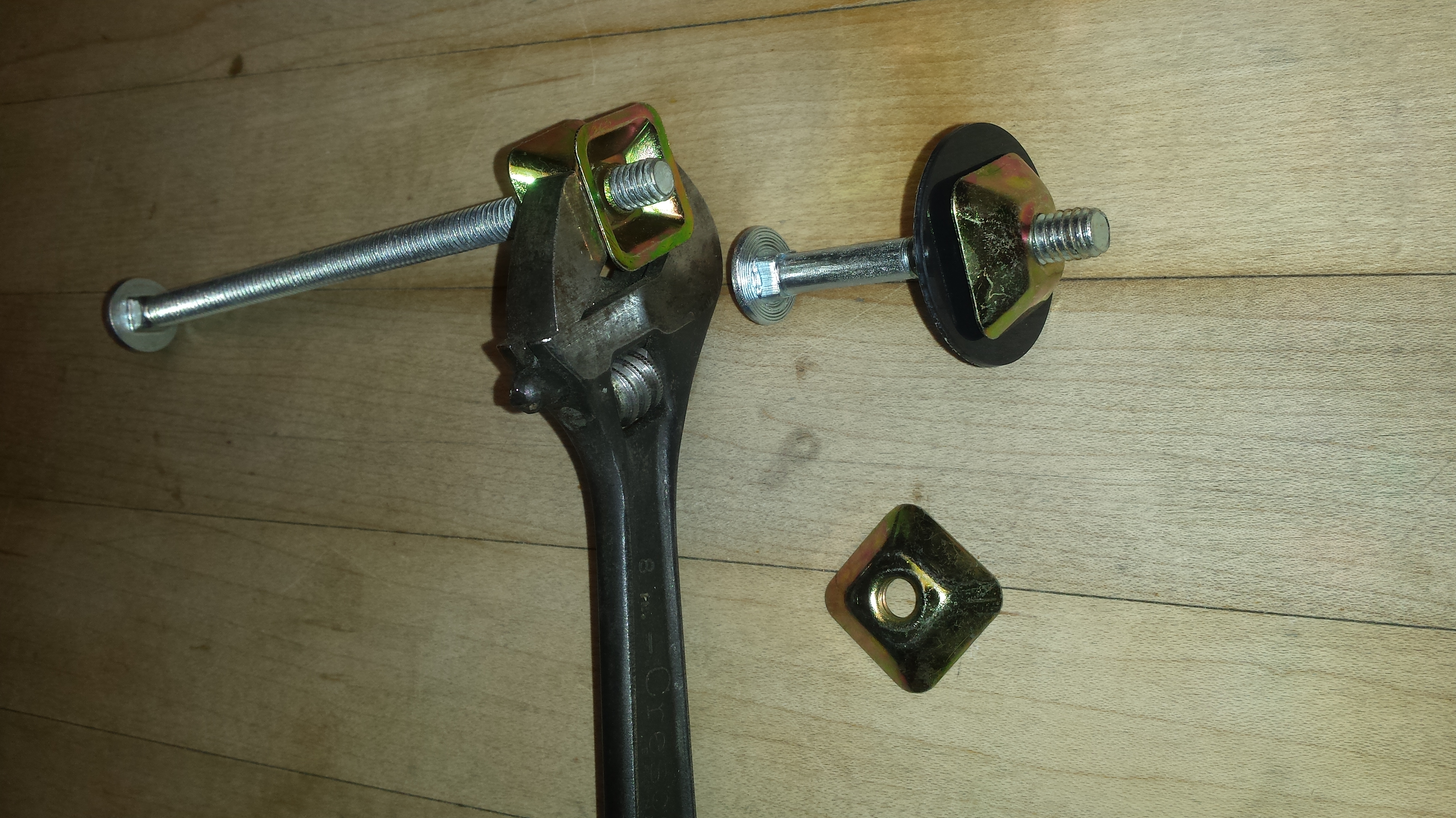

It is time to post No Trespassing signs on the perimeter of my property. <snip>. Finally, do you have any suggestions on how to mount them? I could affix them to trees, but spacing would not be very uniform. Are there good systems to affix a sign to a T-post? Or some other method?
As others have said, check state and local ordinances as to what constitutes proper posting. It is conceivable that the trespasser's lawyer (if it comes to that) will argue a "reasonable" person could not "reasonably see" a sign that was posted above eye level, obscured by foliage, weathered to illegibility, etc. Placing signs at eye level means within a vandal's reach. Of course a determined vandal can destroy whatever you put out there, but you can make it more difficult.
Wire clips, U-bolts around a T-bolt would be exposed to bolt cutters, cold chisels, battery powered grinders. Better would be threaded studs welded to T-posts or carriage bolts through a wooden or square-tube steel post. I have had success against pilferers with "Tuff Nuts". These are elegant but cost $0.60 to $1.00 each in 1/4-20 or 5/16-18. (I have no commercial connection with Tuff-Nuts.) You might find one per sign sufficient, plus at least one extra to use as a tool.
