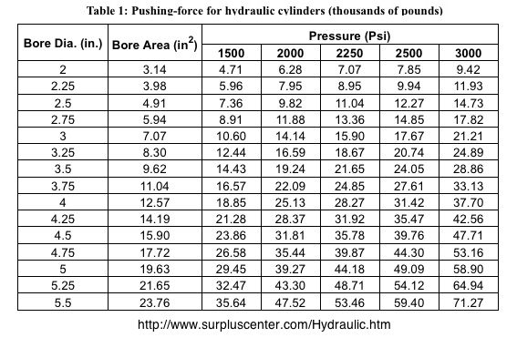

I think I would buy or borrow a hydraulic cylinder whose bore & stroke would be enough to do the job with one push, and use it for a jack.
Something like this, but with the cylinder inside the pipe:
http://dart.arc.nasa.gov/Rescue/CSRC-2008/day2/DSC04304.html
