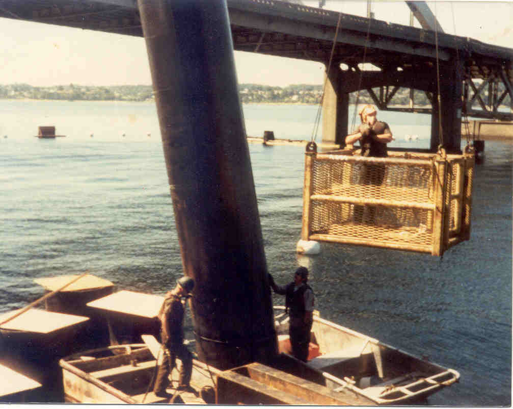

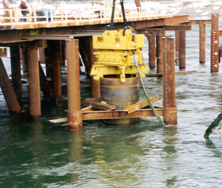

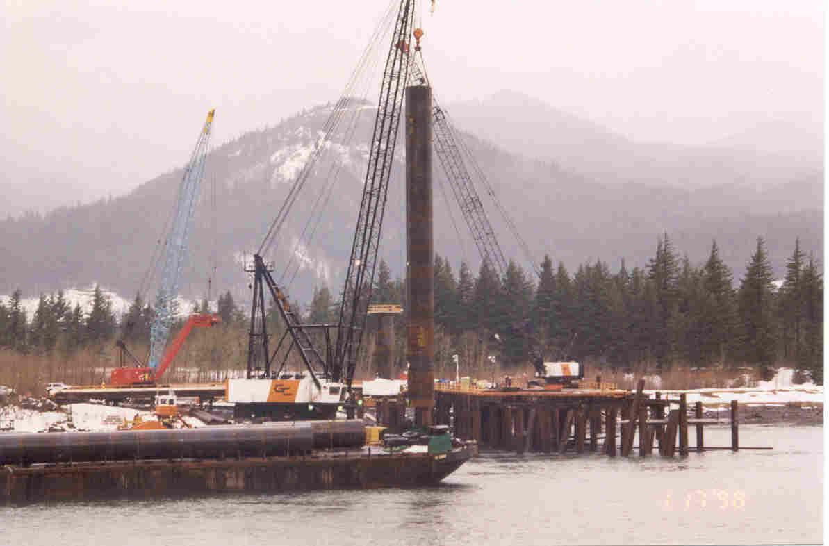

Don't forget the pictures! We like pictures!:thumbsup:
I've cut some pipe in my day, here are a few pictures of some pipe I've worked with.;)
