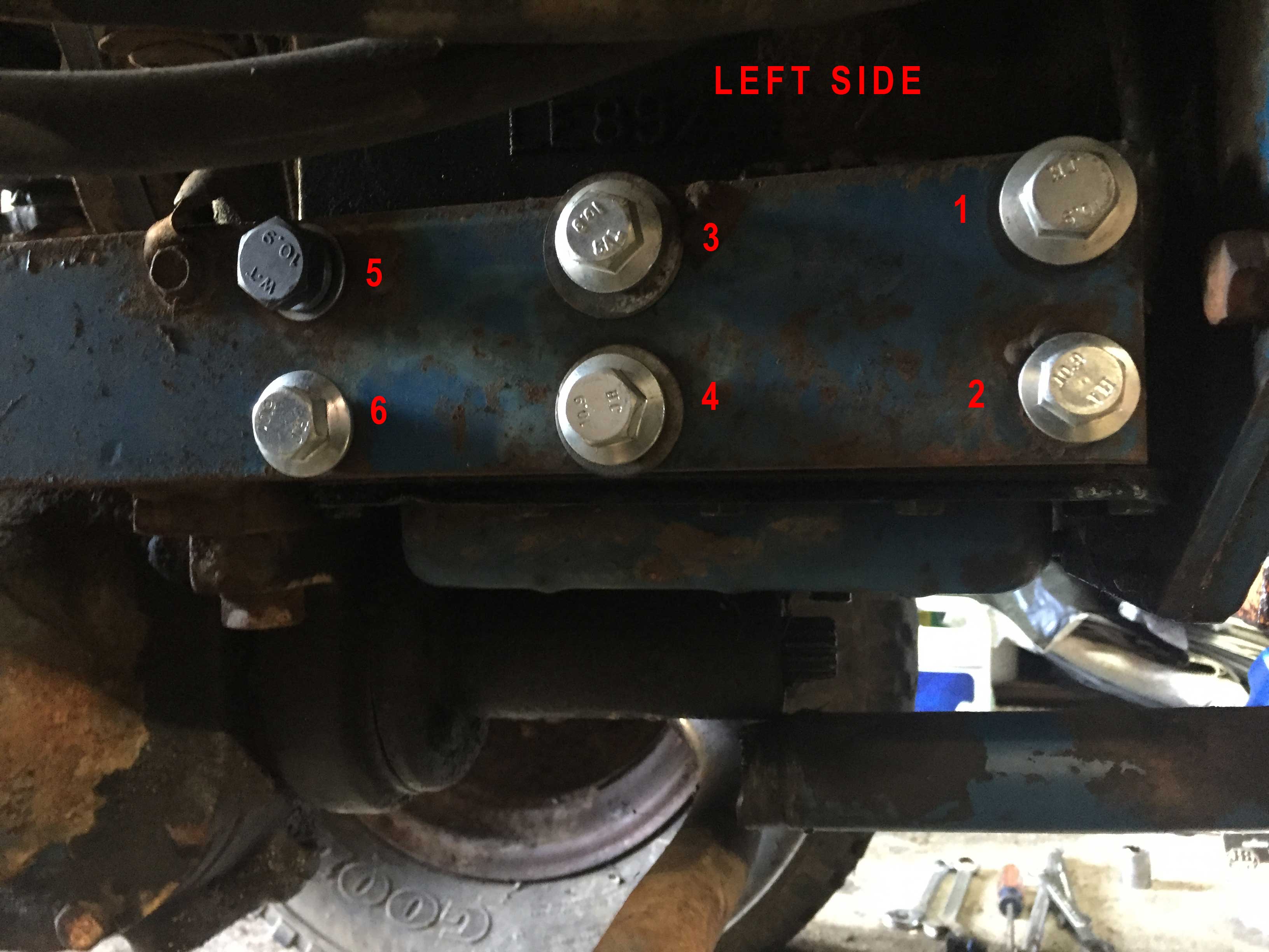

Update! We're getting closer

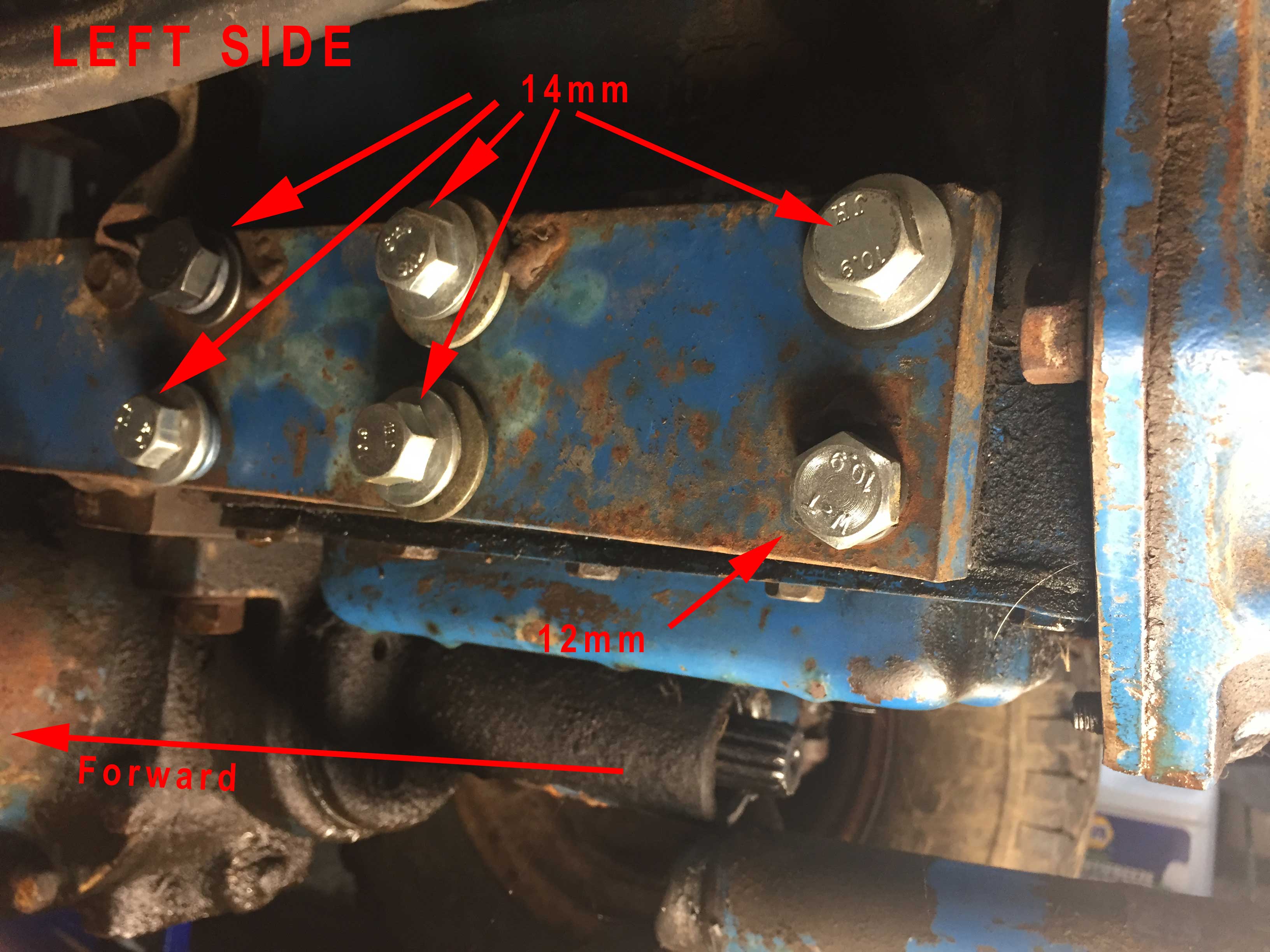

As of tomorrow, Left side will have all six holes bolted! I have what looks like six bolts but the 12mm needs to be replaced with a longer bolt and washers between the bent arm and engine block. I'm using two different bolts only because the silver ones I got from Ace Hardware and the darker bolts I got a Parkrose Hardware. All are rated 10.9. If I did it again, I would've gotten all the bolts at Parkrose because of their selection, but didn't know about the store until a couple of days ago!
The right side is a little tricky. I've got 4 bolts somewhat lined up, but need to start the tractor and wiggle the hydraulics a little more to get it precise. I loosened the lines as recommended and only lost about a 1/4 cup of fluid.
Interesting to find that two holes on the right and one on the left are 12mm. I would've thought they were all the same. Also interesting is that if you look closely, someone did weld the washers and lock washers to the assembly.
I have not added Locktight and won't until I have everything secured and lined up.
Tomorrow I'll get the bolts that I need, install them add Locktight to all fittings. I'll try fitting the hood back on tomorrow also.
Next project - fixing the front drivetrain.
Thanks again!

Left side looks good. Right side needs more help. Once you got things lined up as good as you can then take one bolt at a time criss cross, tighten but don't torque. Tighten all the rest in the same way and then torque. Like I said, this just did not happen out of the blue, you see tell tale sign of abuse and willful intent. I am still surprised this tractor is not busted in half @ the clutch housing. Hope you can line up the drive shaft without putting it in a bind. if you end up stripping a thread during the torquing then welding would very last resort as much as I hate it.

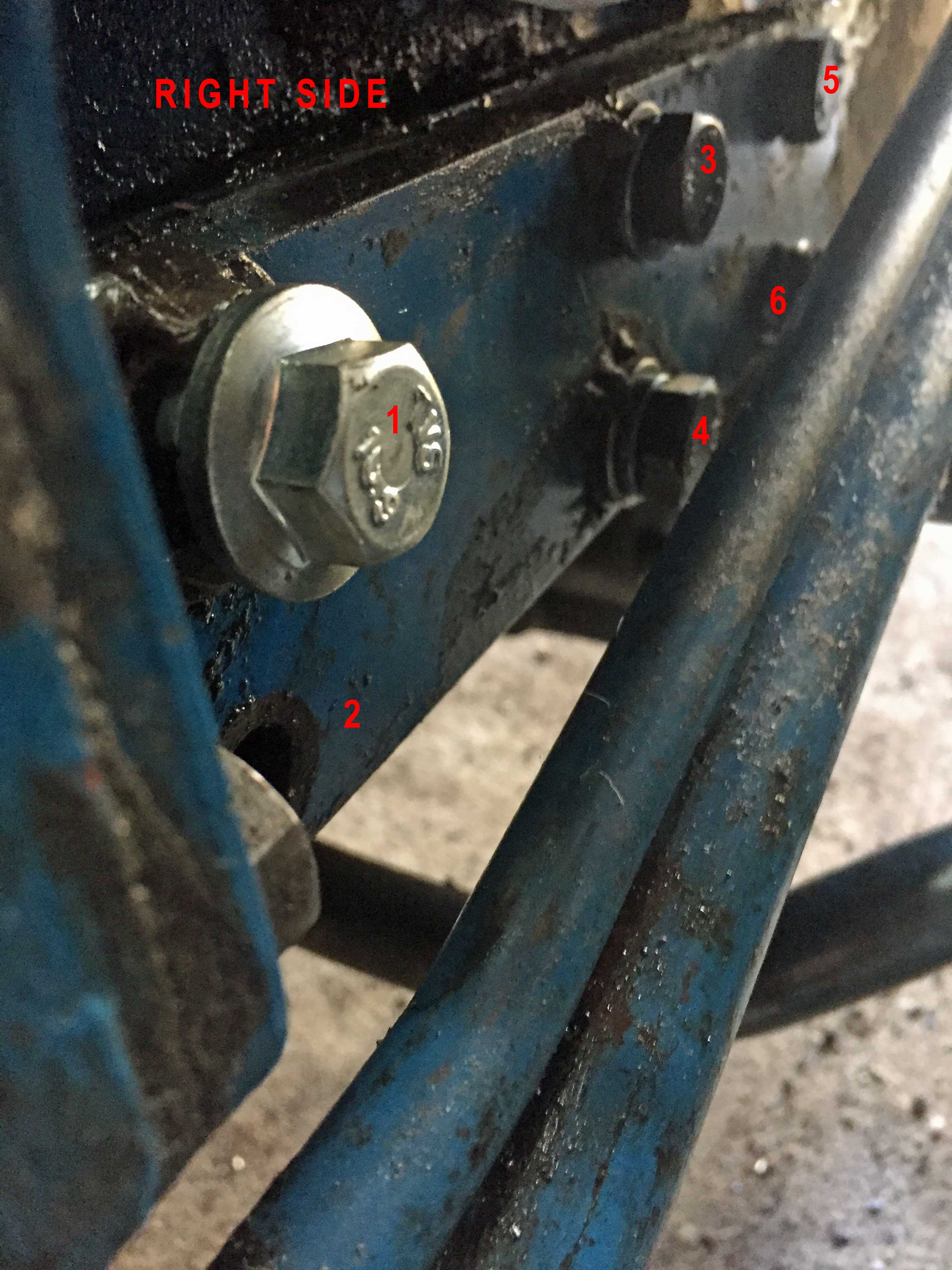

Next Steps Complete!
I would say I'm about 70% of the 90% I'm striving for. I'll never have it at 100%!!
Right Side:
I was able to work some of the other bolts in. I have them tight, but not torqued down or with locktight. Right side 5 of 6 are in. They all need to be readdressed. #2 I'll try and get something in there, but very little to work with in the engine block hole. Looks like they may have tried to weld the bolt in.
#3 is a weird situation. The bolt hole on the block is about 1/8th of an inch too forward. I have a 12mm bolt in there and it tightens, but it probably should be a 14mm. #5 is rather difficult to get to, but I need a longer bolt to be able to add lock washer and washer to it.
Left Side:
All are fairly snug. #2 is barely hanging on. It's 12mm and not much to thread into.

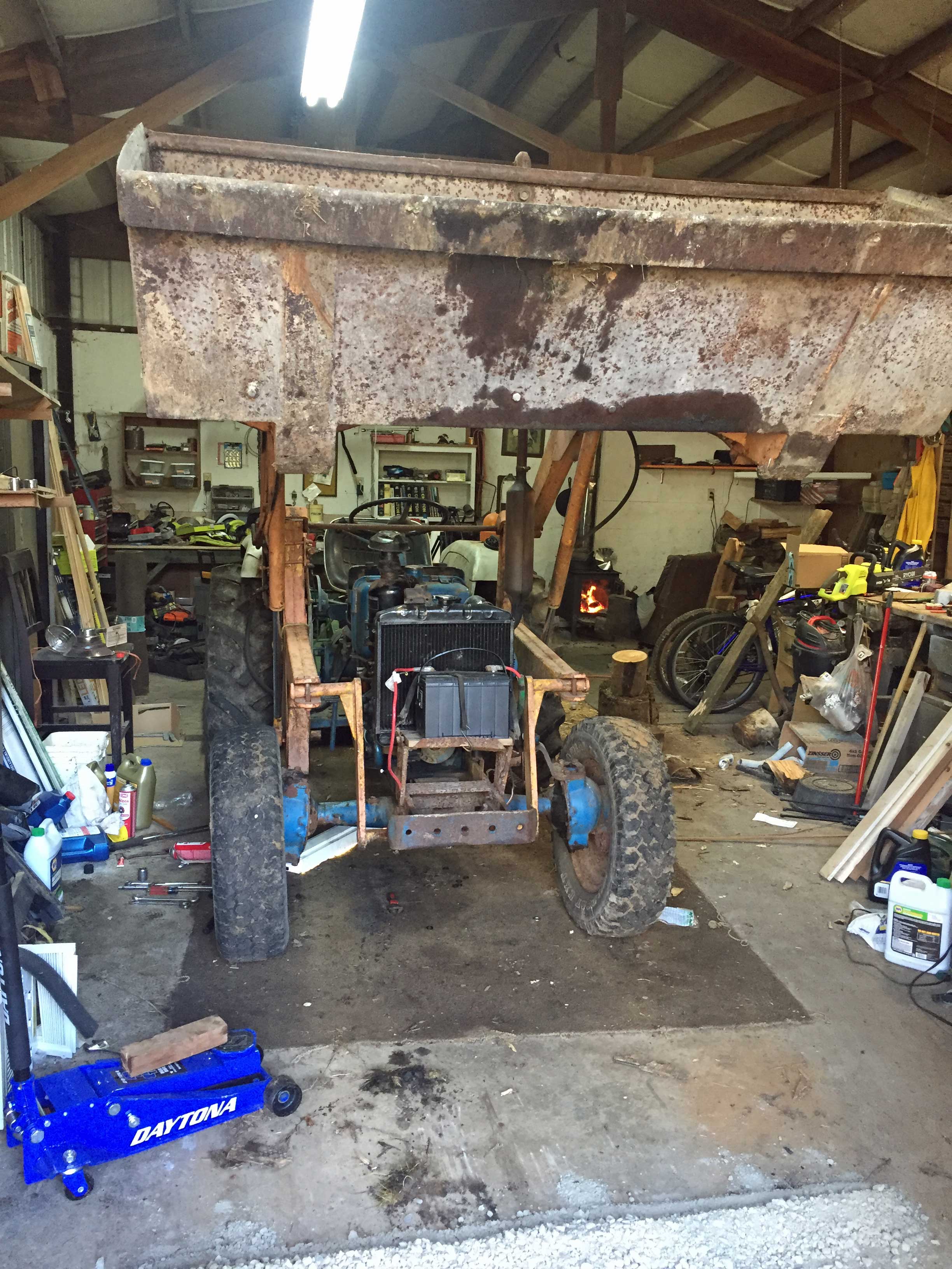

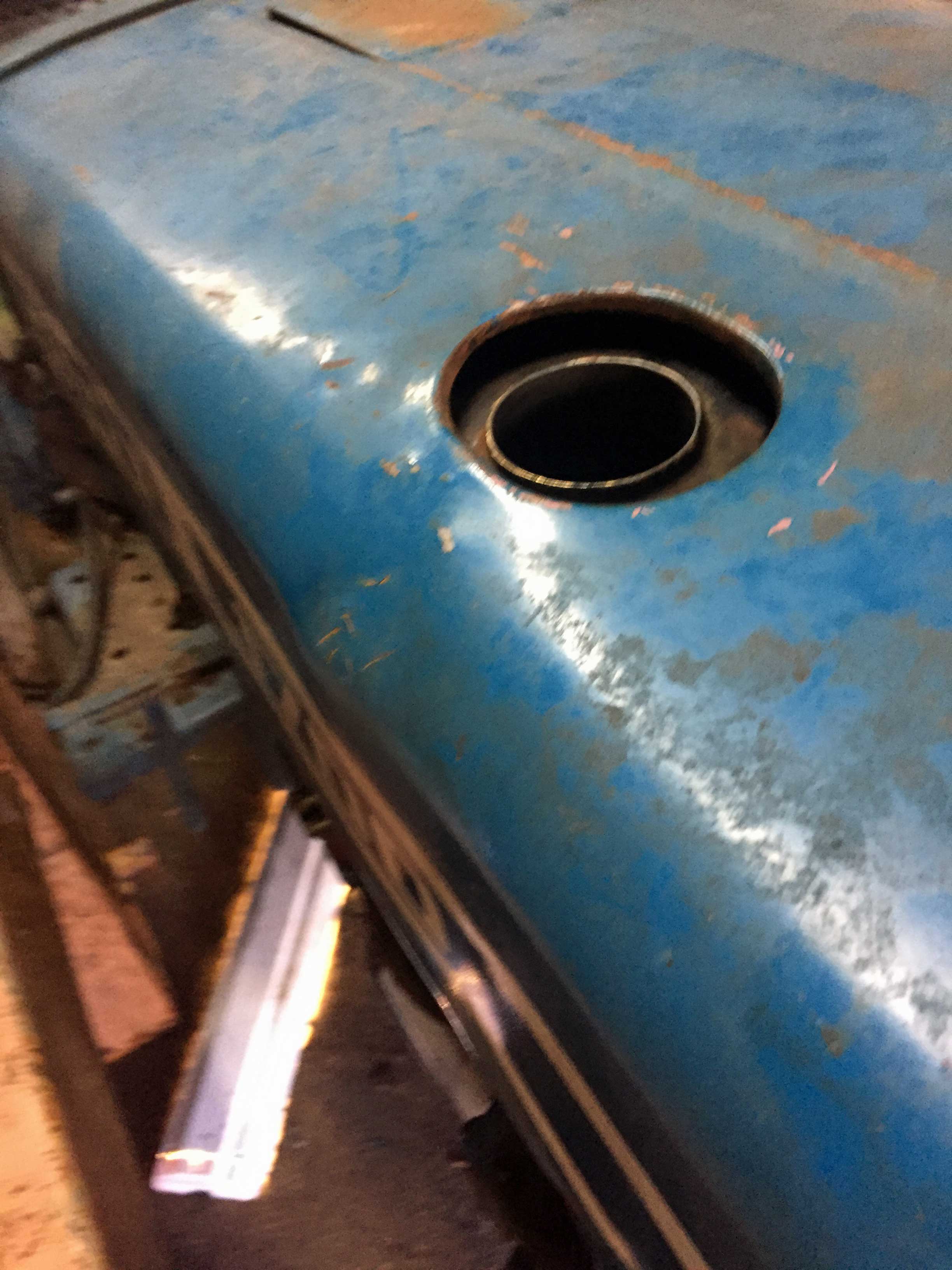

Got them all tightened and decided to do a test that would lead to my next thing on today's list - The HOOD!
Loader up! And once back down on the ground all bolts were in place and tight and no slippage of the assembly

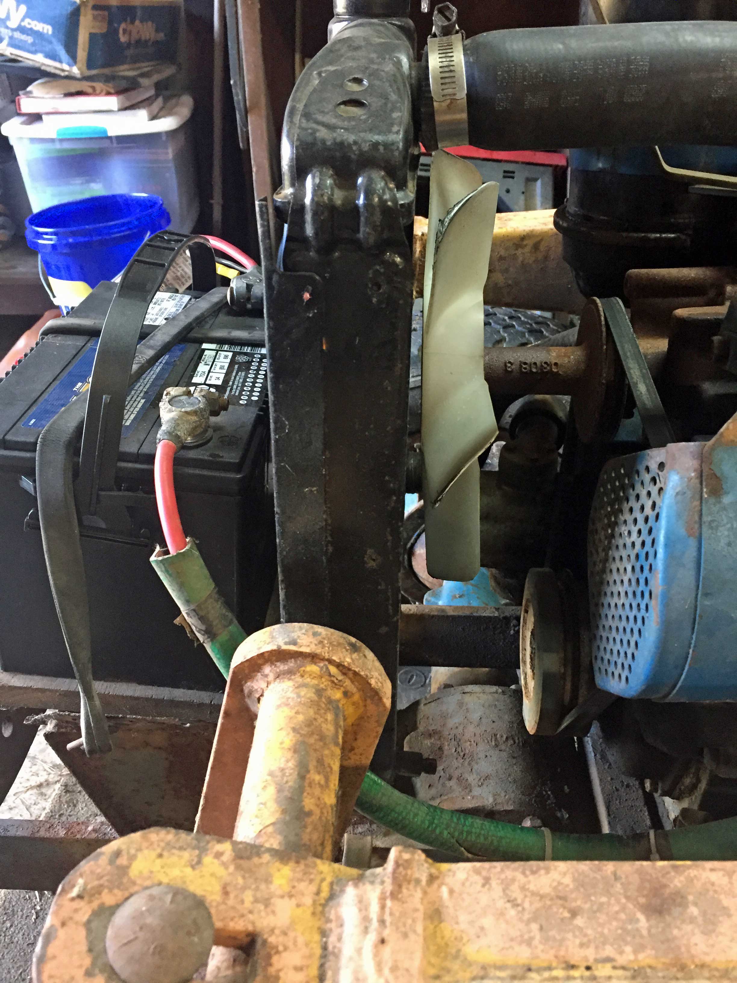

Radiator in right place

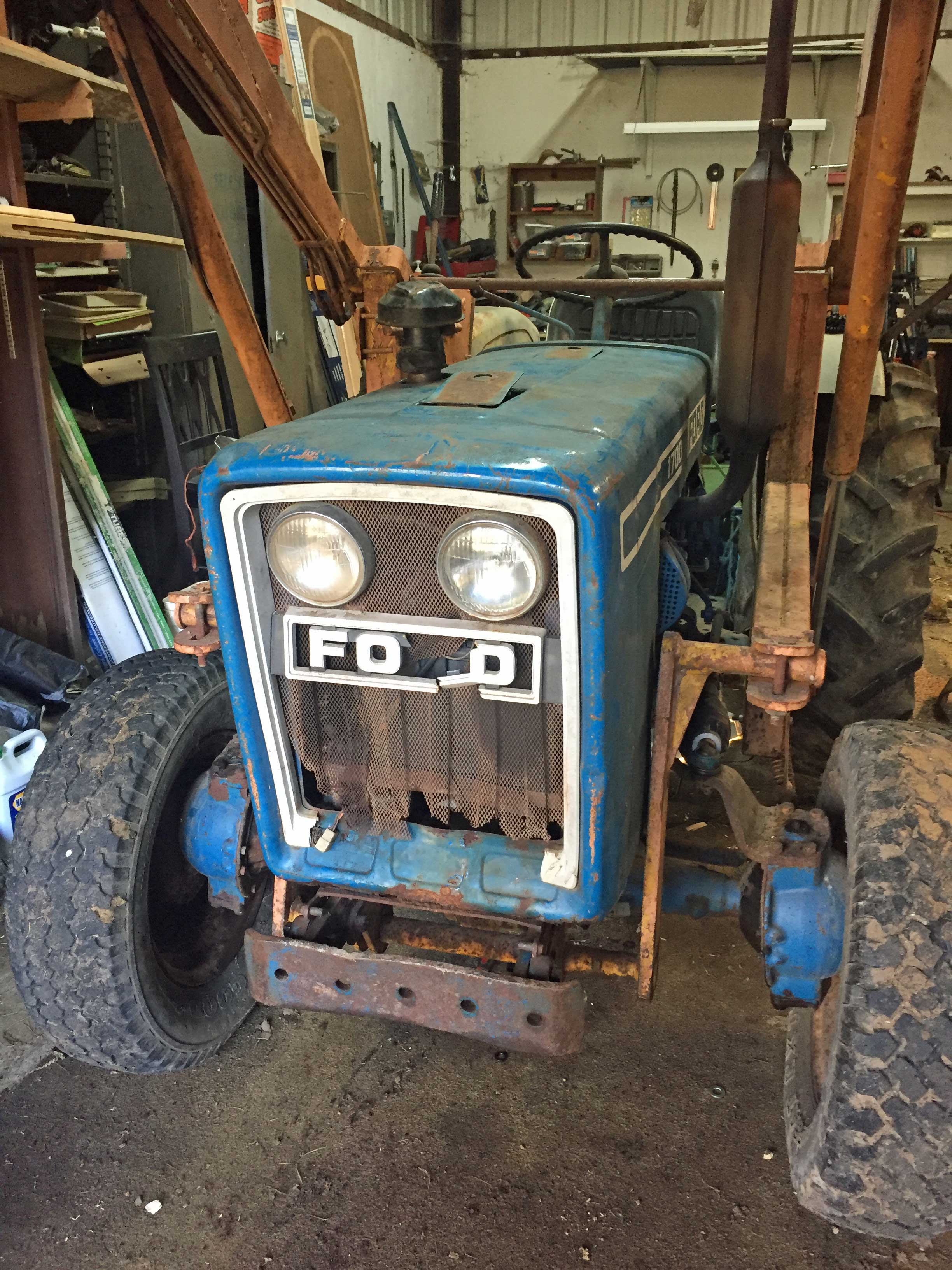

Hood Attaches Correctly!!
I'll make some minor adjustments to the bolts, place locktight and talk to the welder. Other than that, we're looking good!

   / Need Advice Ford 1700 Upper Radiator Hose Burst #48
Right Side:
Ok. what I know , the holes on the block and the matching holes on the chassis frame will not move no matter how much stress it is on them. The only likely cause would be shearing off the bolt in that hole position. In a case like that removing the broken/sheared off bolt can be extremely difficult( not impossible). May be then they drilled new holes in the chassis frame and then in the block. They might have tried to tap the new holes. All of this so crazy but don't know how to interpret differently if holes don't line up and chassis frame is not badly mangled up.
On #2 can you widen the hole using dremmel tool and a stone just enough to allow a bolt to match up the hole?
Left Side:
on #2 , do you think part of the old bolt sheared off in the hole? How many turns can you rotate the bolt before it bottoms out? can you use washers on the bolt to make it tight?
They both looks good considering all the work you have done. it is good that you can move the loader up and down without binding and none of the loose bolts are coming off.
View attachment 688216View attachment 688215View attachment 688214
I agree, Looks a heck of lot better from a where you were thinking just the upper radiator hose not lining up. Like I said the cost of what you have done would have been certainly much more the market value of this tractor. That required a competent shop and their willingness to take on this job. I don't think yo can find many shop to take on this job with any warranty at all. I think you have done well so far.

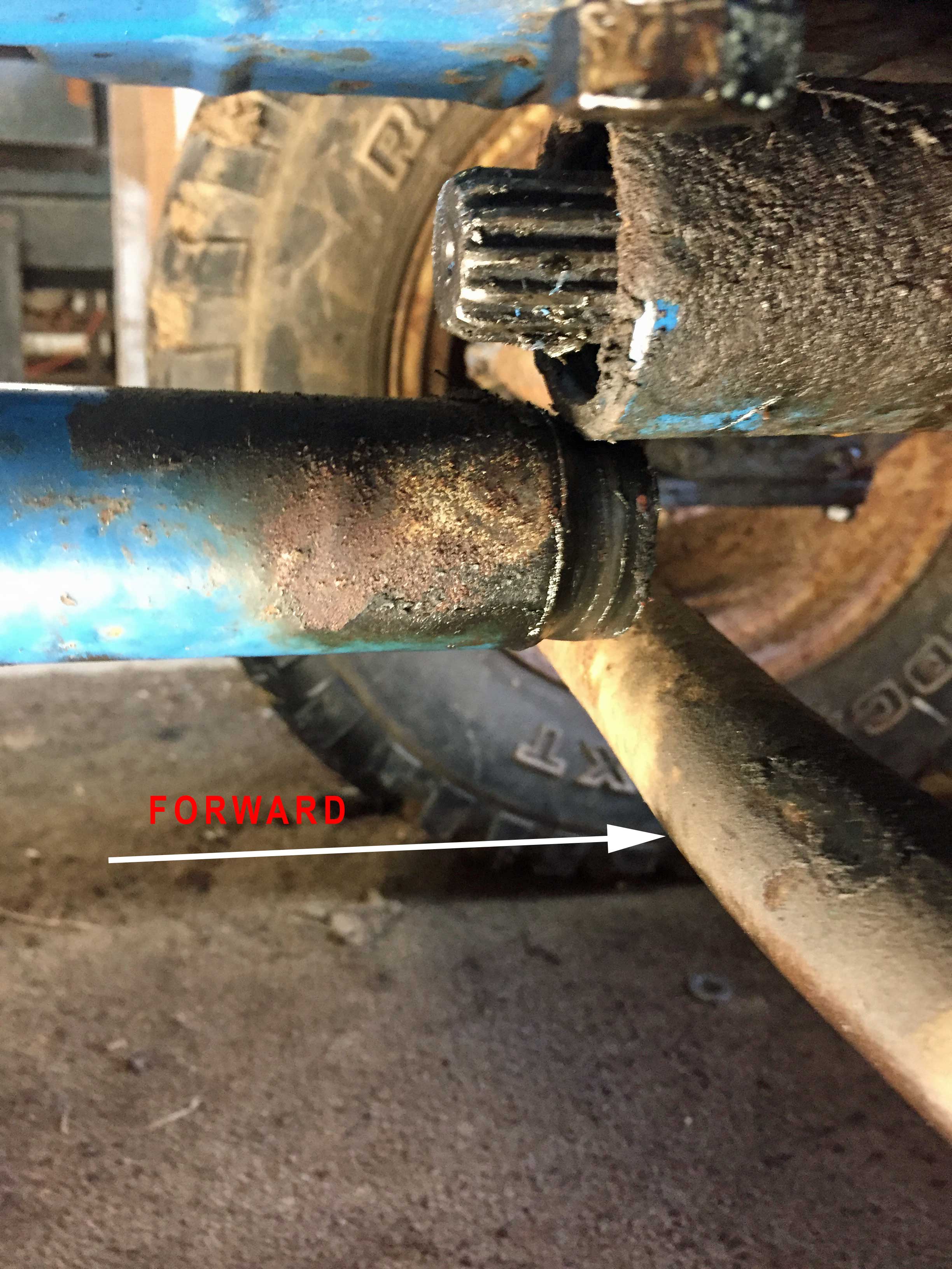

As for the forward drive shaft, here's a photo of the rear portion.
I'm hoping the front portion can slide back into place somehow.
