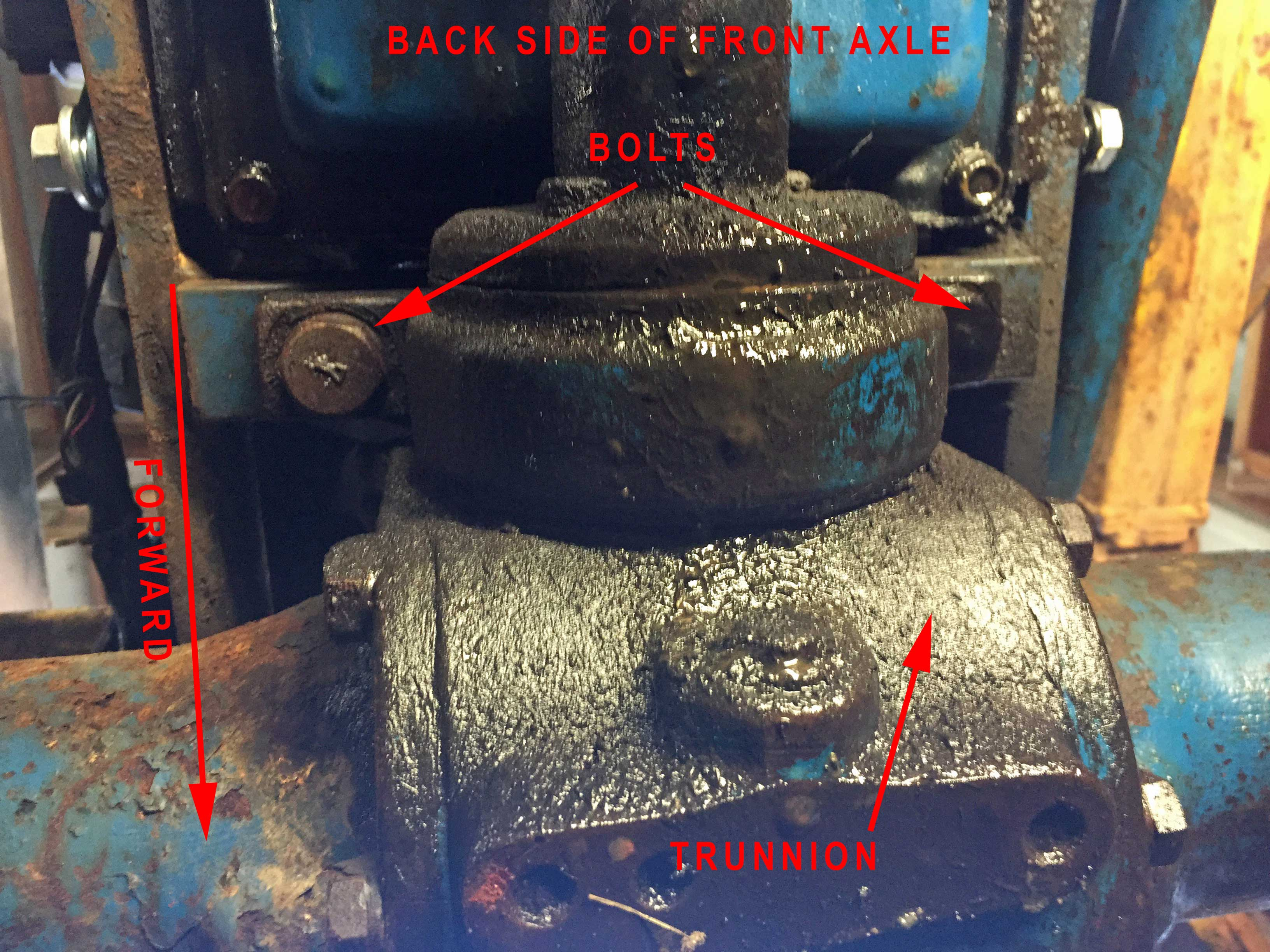

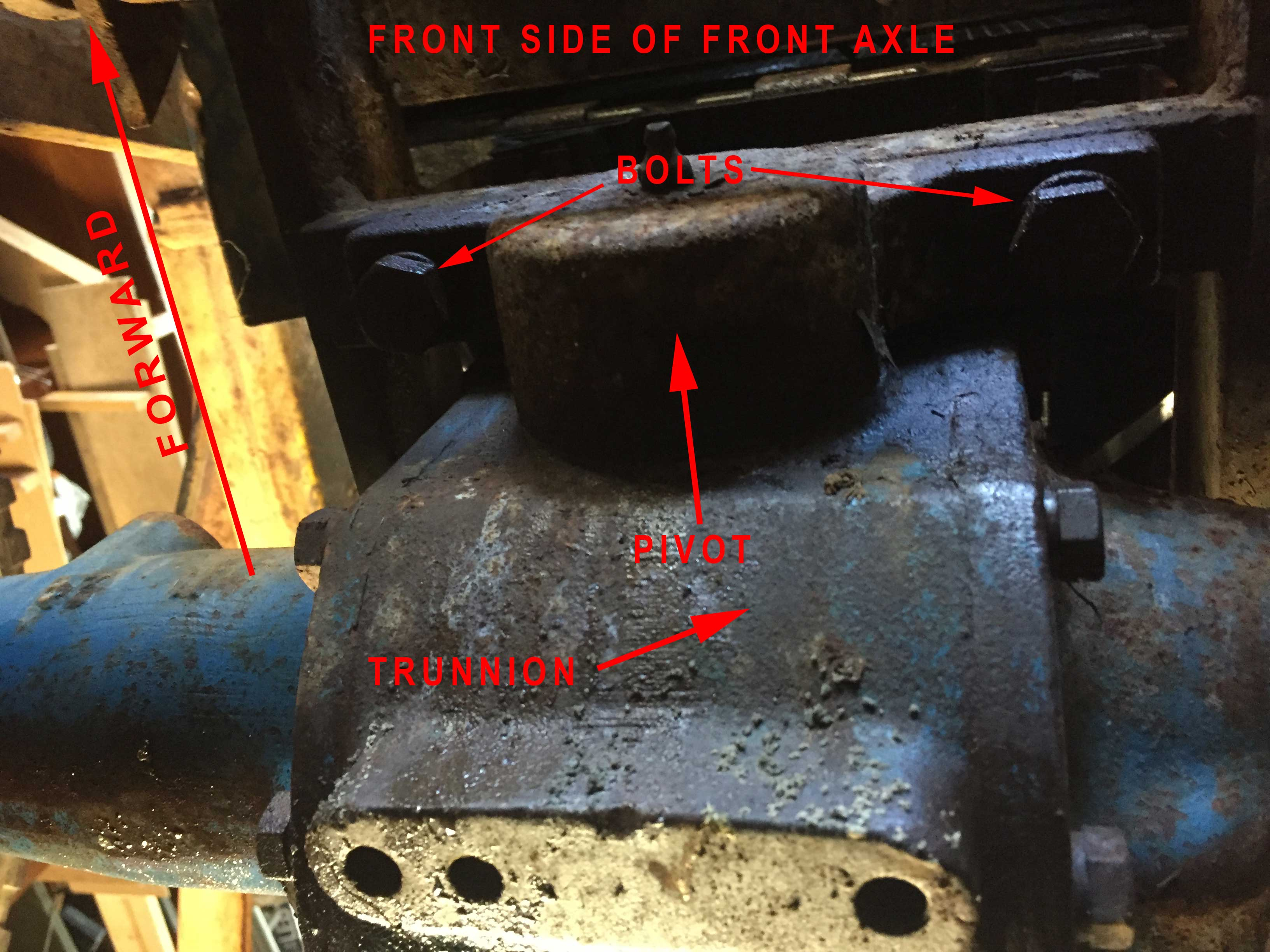

So I'm in the process of figuring out what the pivot trunnions are and from what I've seen, it's what these bolts are holding:
So if I have this correct:
  1. Jack and support the front end.
  2. Remove these 4 bolts,
  3. lift the front end some more,
  4. move the axle forward,
  5. lift the drive connector up,
  6. move the axle back inserting the part into the drive connector,
  7. Move axle back into place
  8. reconnect the removed bolts into existing holes.
  9. tighten the living bageezus out of the bolts.
Am I in the ballpark?
Thanks!

1- That Picture appears to be the front axle. Right? usually when you raise the tracotr in front the you support it on two jack stands and on either side of the pivot. in thi scase it is quite different. You can raise the tractor on the pivot point with a floor jack but you have to lower and set on jack stand on the front bumper of the tractor. Your bumper is wide enough for two jack stands. You raise and lower on jack stands on the front axle would pivot up and down, just like a teeter totter. You can use the loader to raise the front, but I do not all recommend it as it is real dangerous specially with your rig. When you loosen the trunion bolt the front axle wants t drop and is quit heavy so you need to have a jack stand on the bottom to not only slowly lower it but also push a bit forward to line up the shaft and couplerup and then you have to reverse or basically push it all back together and put the trunion bolt in place and tighten it beetter than gooten tight. Easier said that done.
2- Pivot point is at the trnion. About the same mechanism that you have table saw blade assembly, being able to raise and tit the blade. kind of, sort of 1/2 bearing that allows for pivoting of the axle so front axle would follow the contour of the front wheel as they travel. No spring there in tractors.

JC, when I posted the photos, there was a glitch in the new forum and I couldn't write anything. Since I don't know any of the parts, I had spent all day yesterday trying to figure out where the Pivot was and trunnion sounds like something I should eat as a last resort. At about 1am pst, I had an ah-ha moment looking up the parts on Ebay of all places. Once I saw a used pivot for the Ford 1700, it all made sense.
In posting the photos, which I'll post again here, I was making sure that these are the bolts needed to be loosened to then lower the front axle and roll it forward to attach everything. Roll it back into position, lift with jack and bolt everything back together.
I tried to just start to loosen these and it's gonna be a tough one.

Ok. I Looked at second pic very quickly when I got back home last night and did not go back and look at the separated joint to see the lip is part of trunion. Yup, you are right on the procedure. Remember I had two PDFs that showed complete breakdown of front diffy. Remember you have to lift the tractor from the front bumper so there would be no load on the axle and need to support the pivot point of the axle on floor jack. Don't try to eat trunion as it will give you a stomach ache, he he:). I don't know if you have 3/4" ratchet set, that along with proper respectable cheater bar would be adequate to loosen those two bolts unless you have a very high torque impact wrench. A breaker bar and a cheater and deep impact socket would also work. Use a propane torch and put a bit of heat on the bolts and then use some penetrating oil to help loosening things up a bit. Most likely they have some loctite on those two bolts. just take your time and make sure the tractor back wheel is chocked well and bumper is supported on jack stands (two ) and front tires are off of floor. Good luck.
