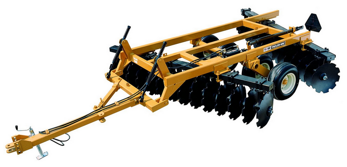

My experience is that these are primary tillage and used for prepping the ground for planting trees. You will have significant soil loss and make it soft (and muddy) if using this on fire breaks. Deep tillage loosens the soil making it a muddy mess with rain. Also the deeper tillage can hurt the tree roots. Your goal with a dirt fire break is to remove the fuel from the surface, so go with a tandem disc, it will remove the fuel, and require a smaller tractor. Big tractors in the woods are not fun to run. We never took the 250 hp or 400 hp tractors in the woods for this reason.
offset disc
Tandem Disc

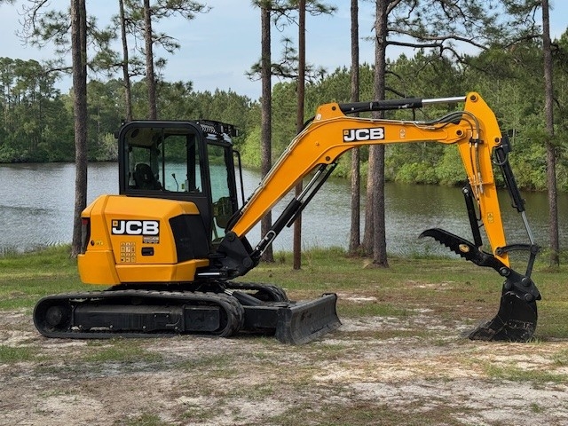

Much smaller scale here as I only maintain 62 acres, but it is in GA, has pine trees, and lots of red clay and sand. I built my perimeter and interior roads which cover somewhere around 1.5 miles in total. We also have two lakes and some elevation change. I've been through a bunch of equipment trying to find the best setup for my use.
I've tried numerous sized tractors, we've owned a Deere 310k backhoe, and mini excavators. What I've settled on is a 60hp tractor with hydrostatic drive. Its a Kioti, but approximate size of a Deere 4 series. I've owned larger frame and higher horsepower tractors but the issue I always face is fitting through the woods. They just become too big when you have to maneuver or get into the woods with them. While they certainly have more power and more capability, they do have some downsides.
With ponds and trees, we area always needing to dig something. A large backhoe like a 310k is great, but I've found an excavator to be more useful. Much less ground pressure on tracks than 4 tires. I can get into softer ground areas without sinking. The 310k is around 15,000 lbs and my excavator is approximately 12,500 lbs.
Reading the posts, and looking at your pictures, and then trying to put myself into your shoes, I would probably be looking at something like this:
> 100hp to 150hp range tractor - geared transmission - with removable front loader - for pulling heavier equipment for road work and material moving. I would add as many rear hydraulic ports as possible. 3 or 4 depending on what tractor supports. Add hydraulic top/tilt links which are invaluable for crowing roads with a tractor.
> 50hp to 60hp range tractor - hydrostatic transmission - with/without loader - for mowing around buildings, fences, tighter access areas, etc. Also, for getting into the woods, and for easier transport on smaller trailers.
> Excavator - with 4 way or 6 way blade - with thumb and dedicated secondary aux hydraulic lines for high flow item like brush cutter or mulcher. Mine is a 5.5 ton unit, but for your property you may want way bigger. That said, you would be surprised what you can accomplish with only a 5 to 8 ton machine.
> Implements
* 6 to 10 foot wide brush mower - depends on how large your open areas are and how narrow your roads are. If you are doing a lot of cutting on fire breaks and roads through woods, a bat wing or large mower might not make as much sense as someone maintaining a pasture. For me, a 7' mower is too large for many areas and I end up hanging it on trees/posts, etc. I stuck with 6'. Your need will be unique to you.
* Land Plane / Grader - May make sense. I have one but rarely use it. Once my roads were formed and grass began to fill in, I find that I mostly only need to cut them to maintain them. If you pull the land plane over those roads, just like a disc/harrow, you may just be inducing new errosion.
* Harrow/Disc - For cutting new fire breaks, and major rework of roads and firebreaks.
* Blade and Box Blade - I have both and use both. A box blade is great for dragging material and moving material, but many tasks can also benefit from an angle blade. Road crowning with an angle blade and top/tilt links on a tractor is a joy. Easy to set your angles and just drive making small adjustments while you go.
* Front Tractor Mower or Excavator Brush Cutter - For tree trimming and maintenance of road edges, these are invaluable. No matter how many times I mow our roads, we constantly have brush growing between the trees that extends out into the roads. About twice a year, I mount the front mower and drive through cleaning them up. Also useful for pond bank maintenance. I've been using a tractor mount version with pto driven hydraulics, but just purchased an excavator model to also supplement harder to reach areas.
Also, if I were to scale up to what you are doing I would not be without a Dump trailer or dump truck - nothing sucks more than moving dirt one tractor scoop at a time. Even on only 62 acres, it takes forever to move any amount of material from one side to the other.

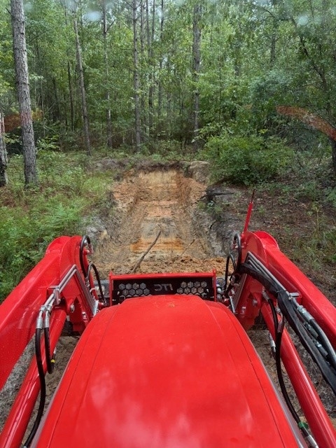

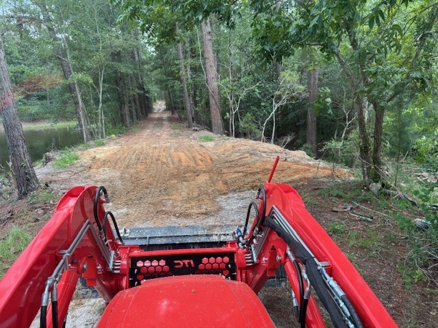

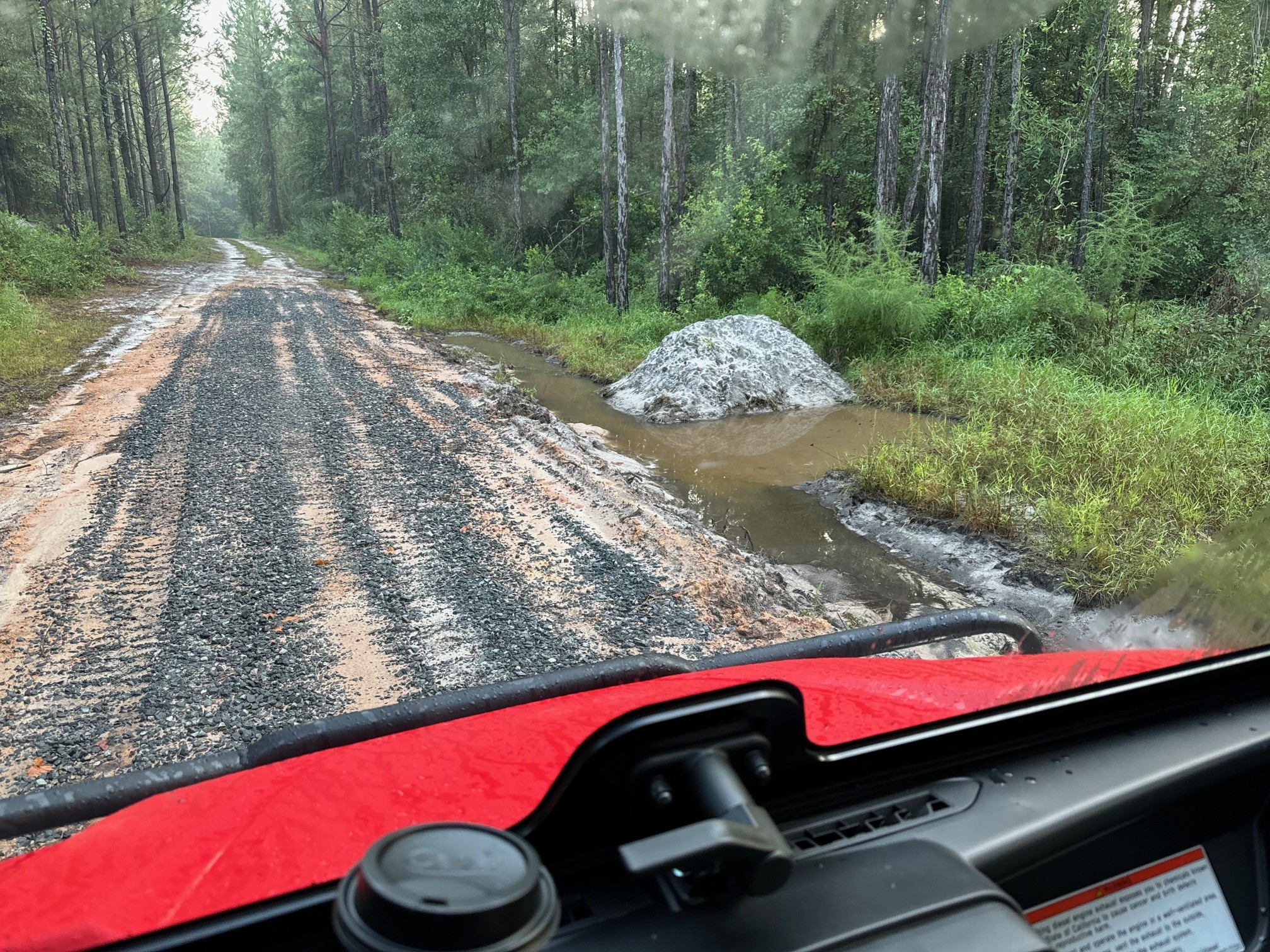

I added some pictures for reference. Just showing property type, road types, material type, etc. Realizing my experience isn't exactly transferable but maybe it adds some additional thinking points to the mix. Good luck!

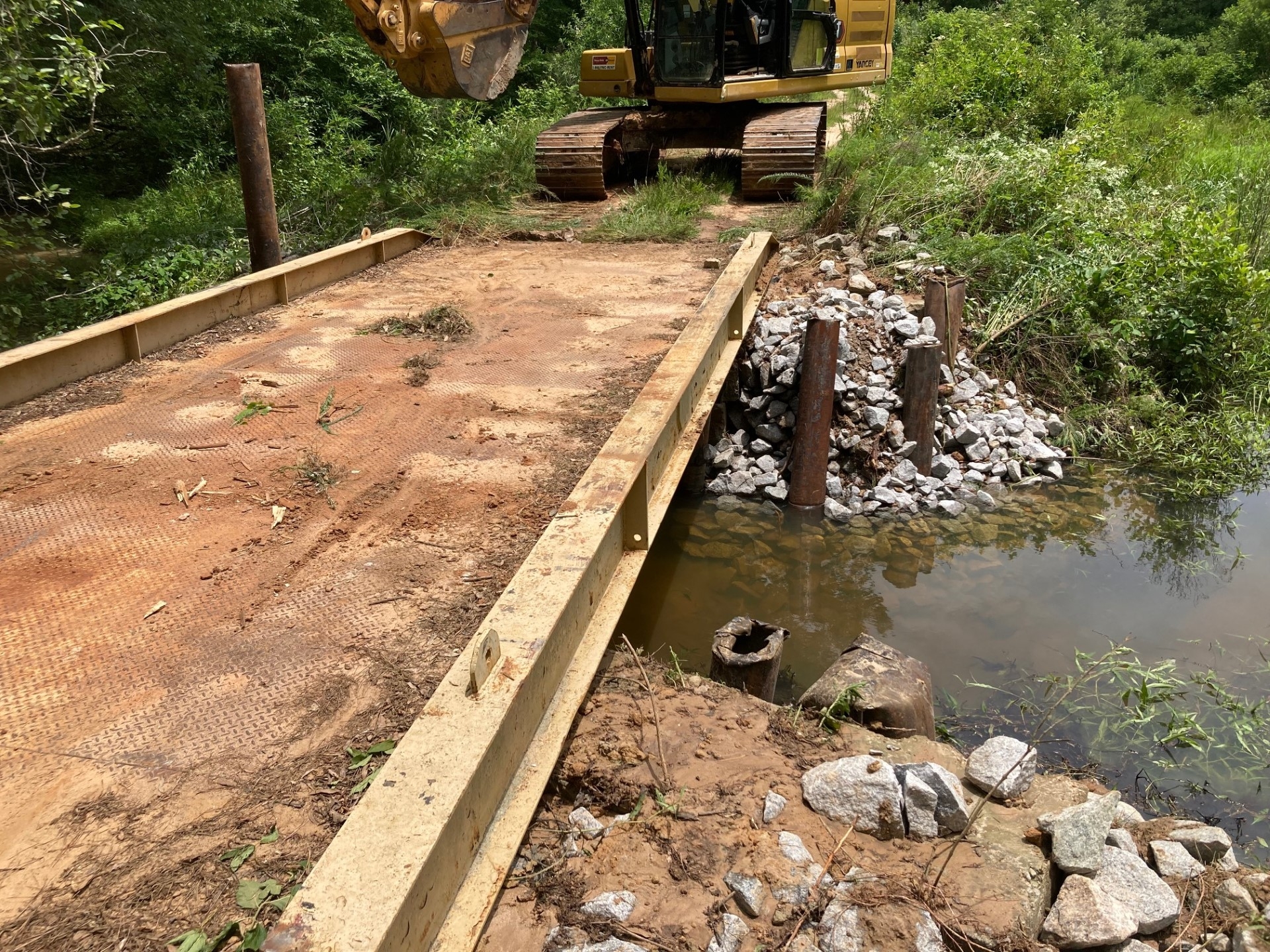

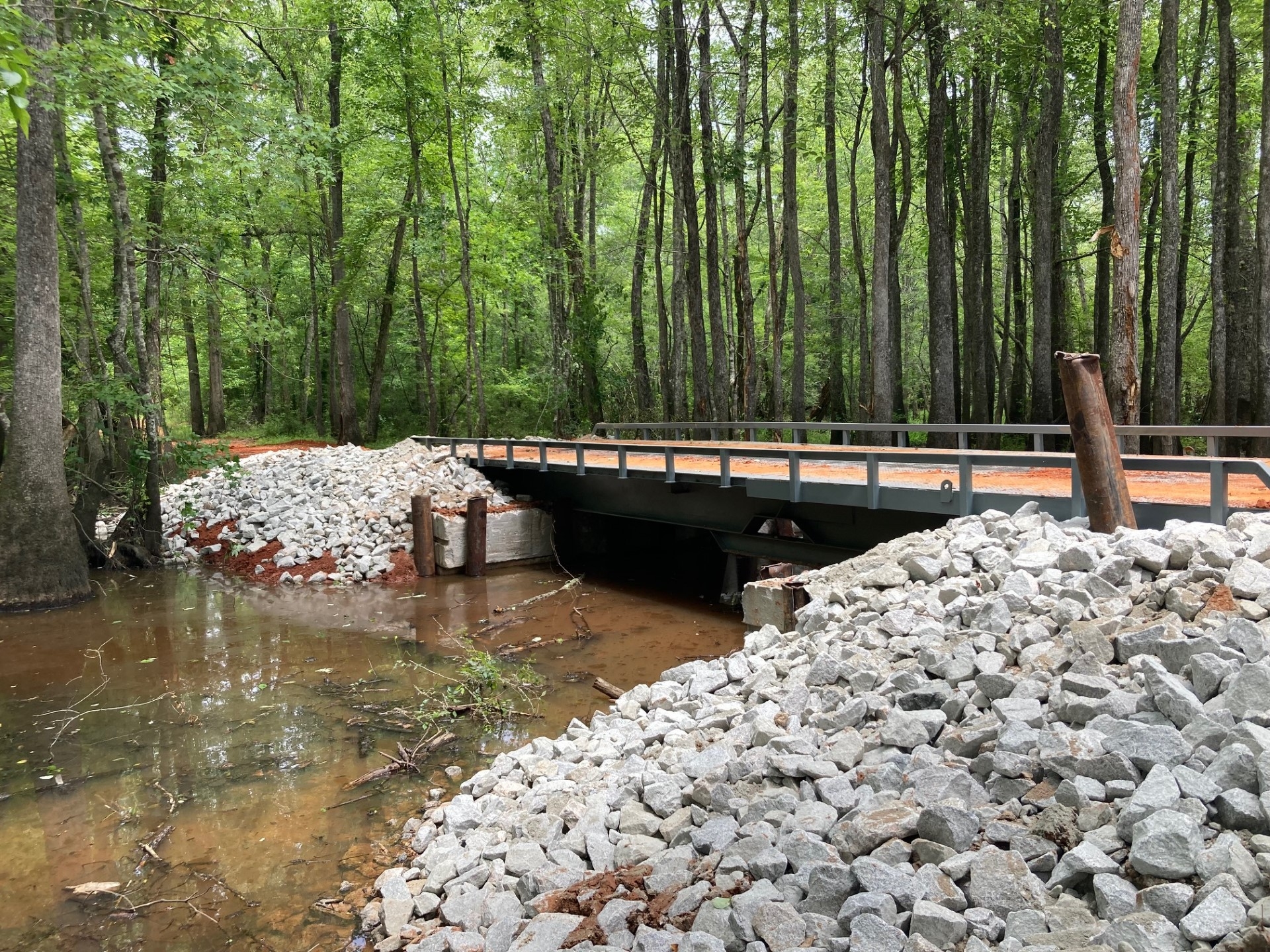

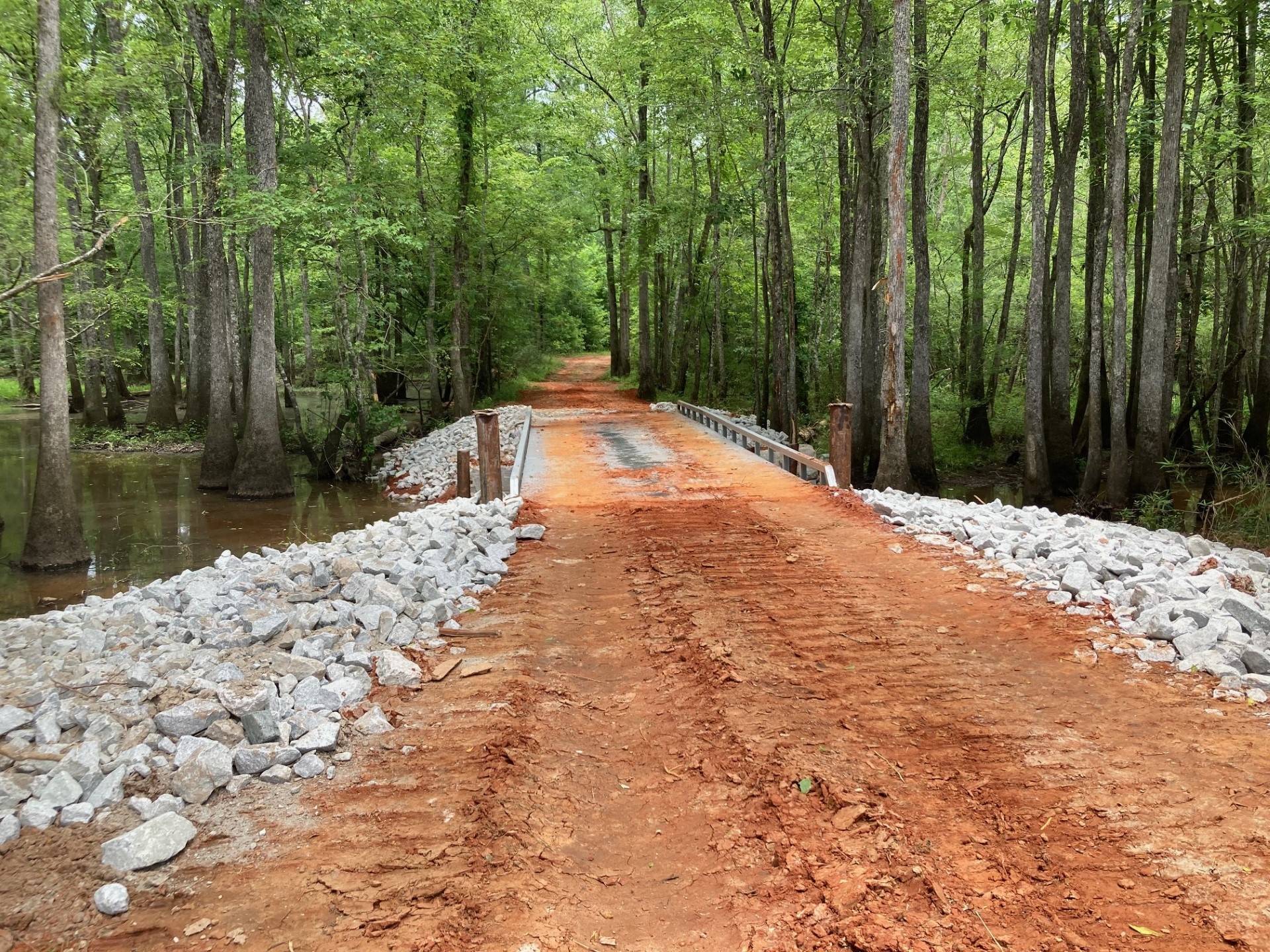

Thanks for your post. I cannot afford to spend $100K on equipment at the start of this adventure. I think I want to start with a 50-60 hp tractor and one or two implements, (tandem disk and land leveler?) that will allow me to break up the hard pan of red clay and make the roads smoother. So $40-50K budget. Would a power rake do the same job as the two implements I have mentioned? I have also attached pictures of our two bridges. About $40K for both plus another $14K to repair one after a flood. I have come to the conclusion that only taxpayers should build bridges. Private citizens should stay out of that business. LOL.

Do you think I could get by with 1 offset disk, (no more than 5 feet wide) and 1 box scraper to start with?

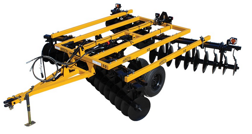

I do not think an offset disc is appropriate for your application. I will use Amco (a competitor of rome) for reference data. A Amco F17-2622 9. tandem disc weighing with 26 blades 3414 lbs needs 68 minimum hp (not sure why they call it an offset as its a tandem and would not do as well for primary tillage). An Amco LOF-2424 9' offset disc with 24 blades weighing 2392 lbs needs 90 hp min.
You do not need to cut that deep. If you have areas that are that rutted a heavy duty box blade to move dirt is the first choice. The rippers on the box blade will let you loosen the soil and move it.
The spaces around the tree parcels are about 20-30 feet in width
A 10-14' heavy duty tandem disc will work great in these widths. Two or three passes and your done. I would not buy one with less than 1-1/8" disc gang axles (they have 1-1/8" threads on the end). If you can find a disc with cushion standards that would be best but they are not common in your area.

I forgot to mention the damage done to the roads by tree harvesting.
A box blade will do a much better job of leveling those significant ruts. Eventually once you get everything level you might want to consider getting a land plane / grader as they handle smaller ruts well, and do an overall better job on smoothing out a road, however the big ruts you have are going to be a challenge for a land place / grader.

Nice bridge! We used two railroad tank cars with the ends cut out as giant culverts to get across the one Bayou.

A few questions - In your neck of the woods do they have many "off lease" tractors for sale? I've read a lot about them, but mainly in the wheat field area up north.
And about your bridges - bridges that are low enough to get wet in a flood gather flotsam and jetsam and act as a DAM. I had one on my land in Vermont. You need to build a simple bridge that is strong enough to be a DAM bridge or to swing away in high water. Attached such that you can readily pull it back with your 60 HP tractor when the water goes down.

The bridge that was damaged by the flood remained intact but some of the concrete "building blocks" were moved and created the need for repairs. The "building blocks" are about 4 feet square and 6 feet long and look sort of like giant Legos. Probably weigh several tons. Mother Nature had the last at bat and moved several out of position. Must have been a helluva flood.
