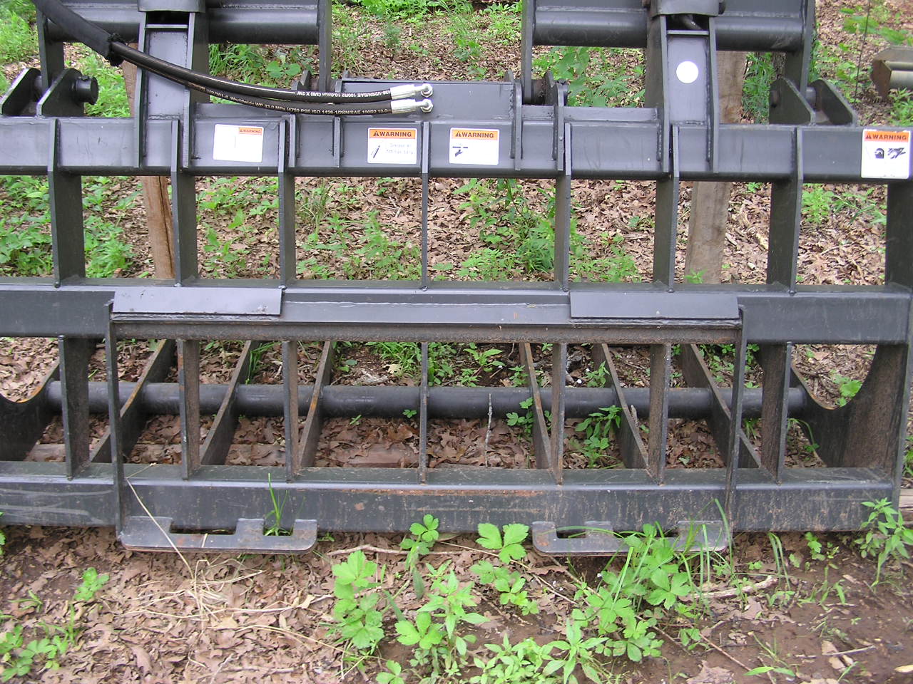

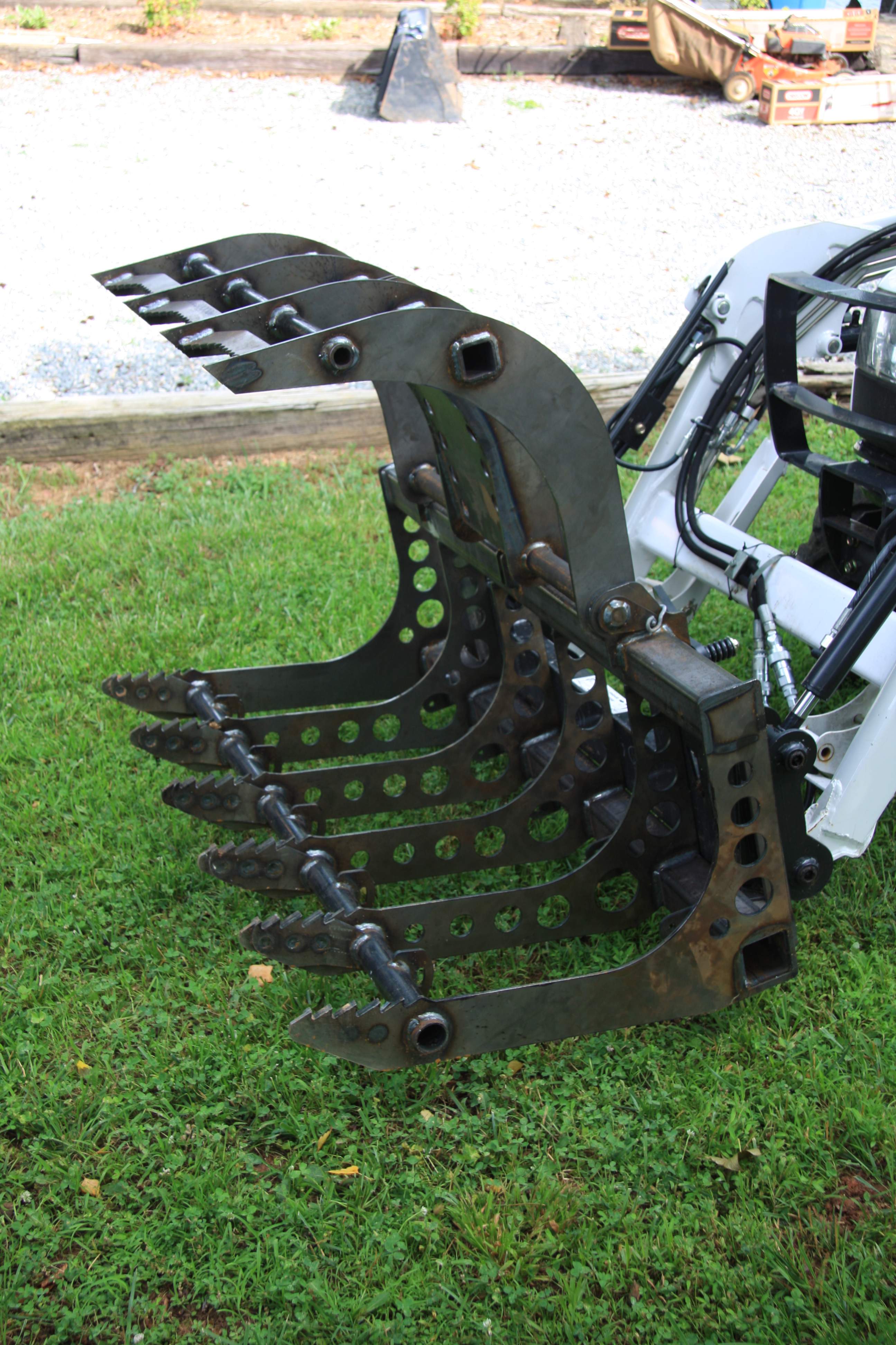

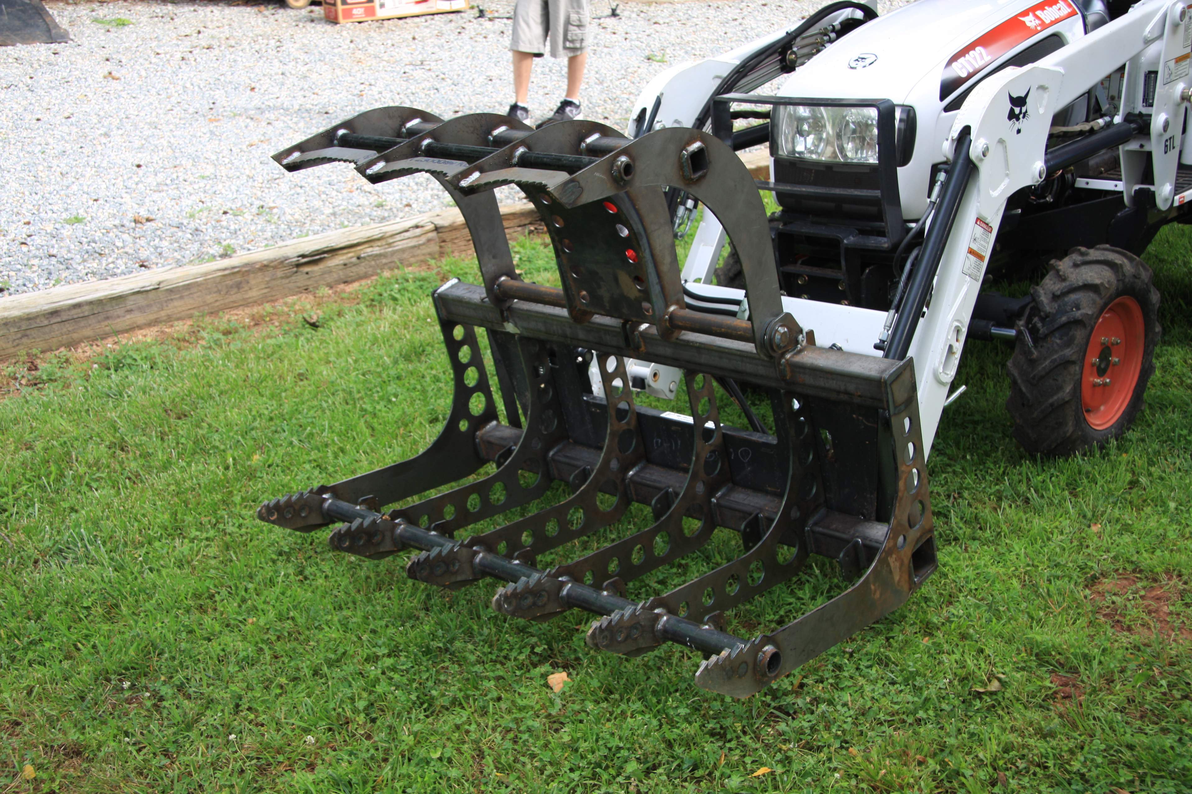

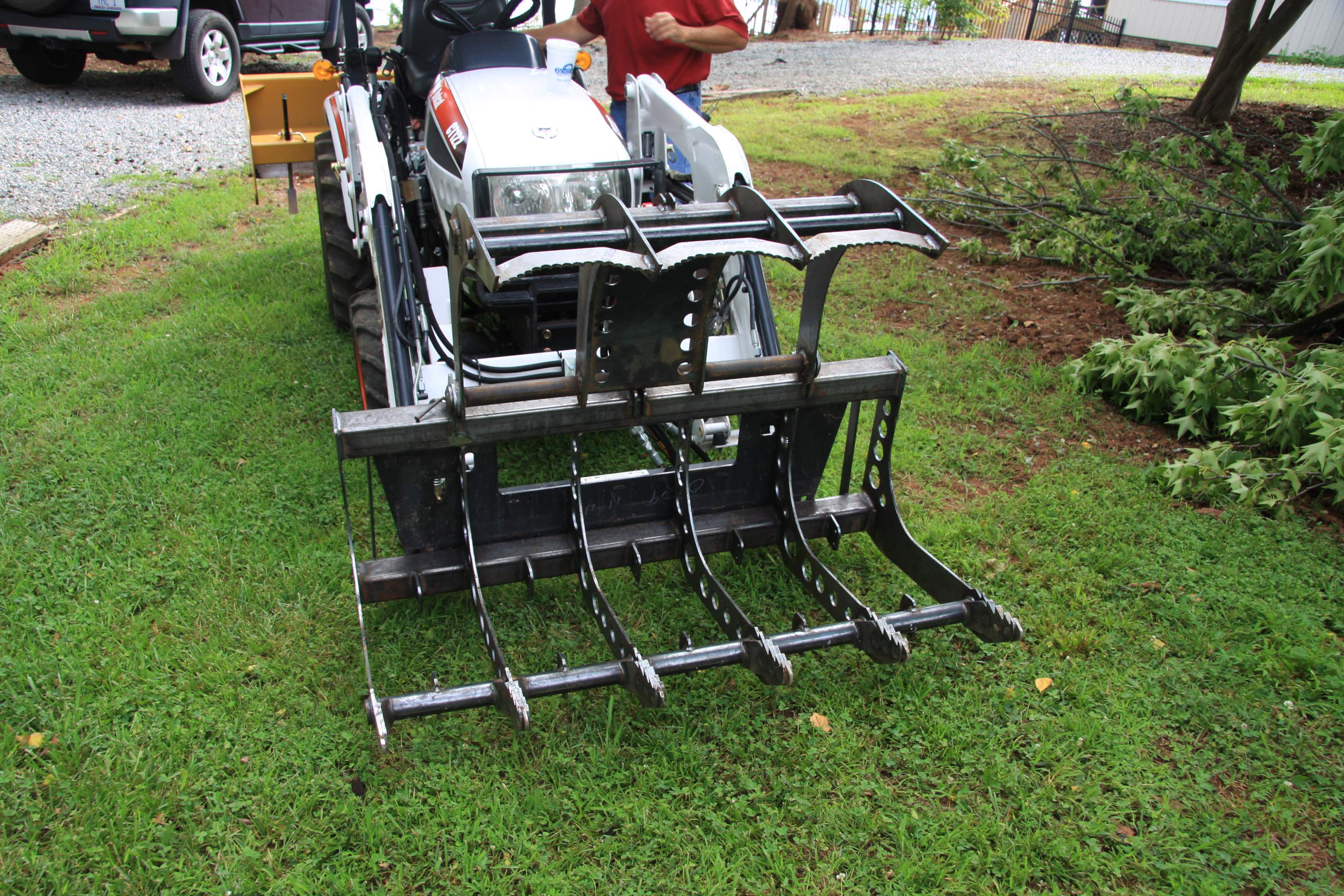

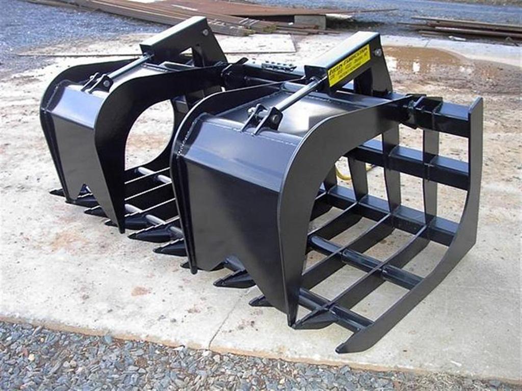

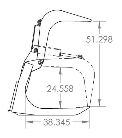

I just don't see the need for one to open wider than this:
View attachment 343884View attachment 343885View attachment 343886View attachment 343887
If it opened wider, the lid would have to be taller and the bottom tines would have to extend out further from the tractor, which would extend the tractor's center of gravity and lessen the lift capacity.
This would be a disadvantage, especially when pinching logs or heavy debris with a small compact tractor.......maybe not so much with a larger tractor.
With more opening it gets the tines away from your head when loading the grapple by hand. [see pics] Wich I do with firewood and to be able to grab larger objects like a stump. The stumps are the biggest problem, I know you don't mess with stuff like that with most compacts but as you know the Kioti has very good lift capacity and I use mine alot for this. I was told by the gent I talked to yesterday you had/have a DK40 so you know what it will pick. With a skidsteer grapple that is in the 800-1k range I loose more lift than I want. As far as the width of the grapple, when digging trees out the wider grapples put too much stress on the loader when popping roots with the edge, even the bucket IMHO is too wide to grub roots with. So after renting a wide one I guess I am the first one to admit it was too wide for my needs. CJ
<img src="http://www.tractorbynet.com/forums/attachment.php?attachmentid=343884"/><img src="http://www.tractorbynet.com/forums/attachment.php?attachmentid=343885"/><img src="http://www.tractorbynet.com/forums/attachment.php?attachmentid=343886"/><img src="http://www.tractorbynet.com/forums/attachment.php?attachmentid=343887"/>
Good points but lift capacity would only be an issue for smaller tractors. A bigger version of your Light Duty for 40+HP CUTs would not suffer. My 48 Millonzi has a 46" opening which is useful for collecting brush and also for big stumps. Maybe use 3/8 mild or high strength steel but keep the single wide lid and the removable slats.
I agree with you for a tractor like the small 22 HP 1400 lb lift unit that you show. You make a good point at the end, larger tractors may be able to take advantage of the larger opening while staying with the narrower grapple.
To me this "which is the best grapple?" question is kind of like asking "which is the best bucket for my excavator?". My answer to the excavator question would be "it depends what you are wanting to do with it".
Narrow L bottoms have an advantage of maximum lift per lb of grapple weight and per dollar spent. And of best digging ability for small to medium machines.
Wide L bottom grapples have an advantage of maximum total volume capacity and maximum cleanup swath. Think storm cleanup or post dozer cleanup.
Rake grapples have an advantage of forward and back raking, with better root grubbing ability.
So my answer to the question about which is the best grapple would be "it depends what you are wanting to do with it".

I agree with you for a tractor like the small 22 HP 1400 lb lift unit that you show. You make a good point at the end, larger tractors may be able to take advantage of the larger opening while staying with the narrower grapple. To me this "which is the best grapple?" question is kind of like asking "which is the best bucket for my excavator?". My answer to the excavator question would be "it depends what you are wanting to do with it". Narrow L bottoms have an advantage of maximum lift per lb of grapple weight and per dollar spent. And of best digging ability for small to medium machines. Wide L bottom grapples have an advantage of maximum total volume capacity and maximum cleanup swath. Think storm cleanup or post dozer cleanup. Rake grapples have an advantage of forward and back raking, with better root grubbing ability. So my answer to the question about which is the best grapple would be "it depends what you are wanting to do with it".
Very well stated tom.
   / Need help deciding on a grapple #118
Good point IT, as you get into the larger CUTs, the difference in weight between narrow/wide or smaller opening/bigger opening is almost irrelevant.

I just don't see the need for one to open wider than this: I do, brush isn't very heavy, if it will grab more, it takes less time to move it.

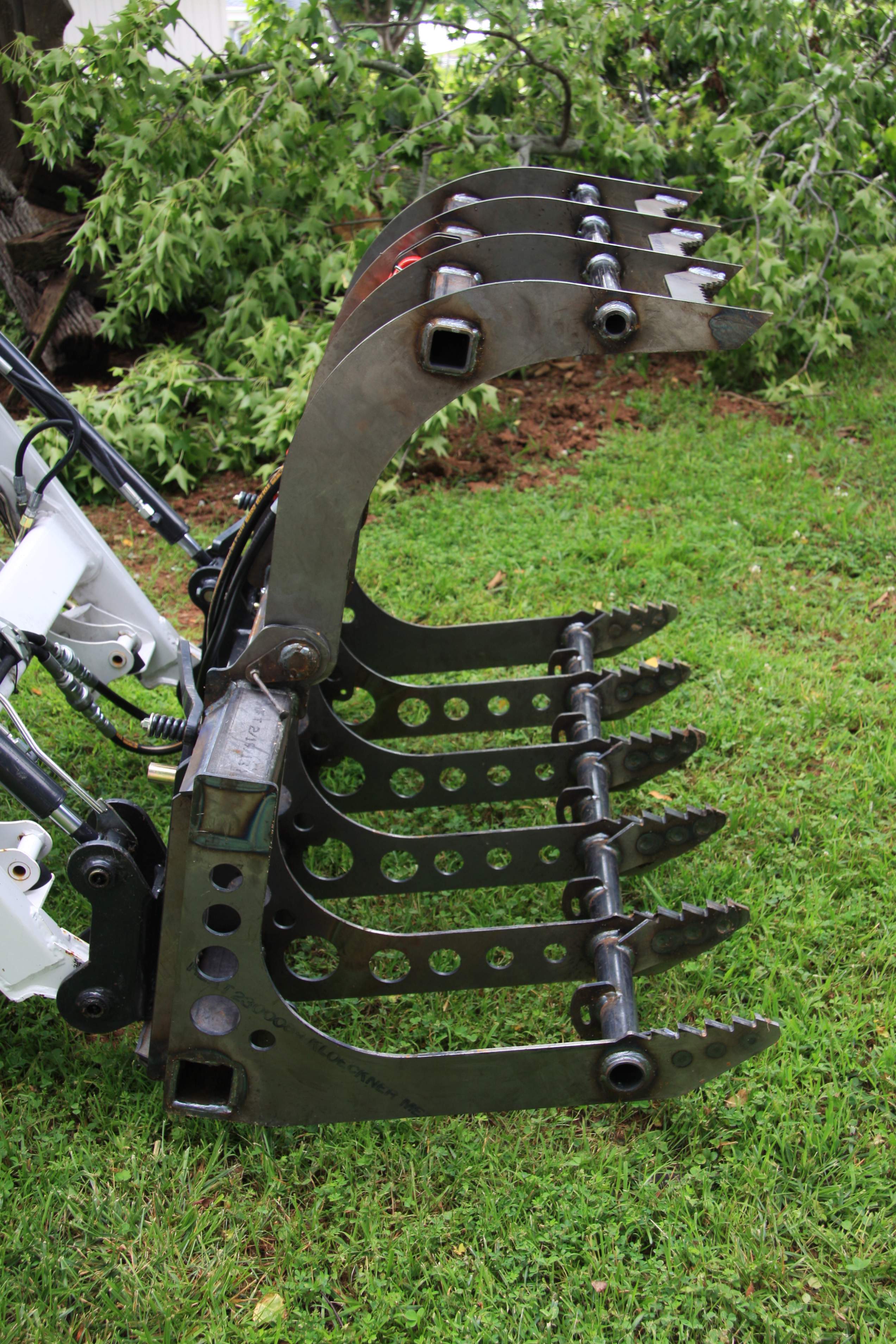

Not true, there is another way to make a wider opening, keeping the same bottom tine length.
Raise the pivot point and extend the top tines back down to the lower tines.
Notice how much higher above the SSQA, the top lid pivot rod is, compared to yours.
Show this to your design engineer for the next heavy duty wicked big mouth grapple! :D :thumbsup:
That setup is so bad asss looking. Very nice. Always impressed with your grapples.
