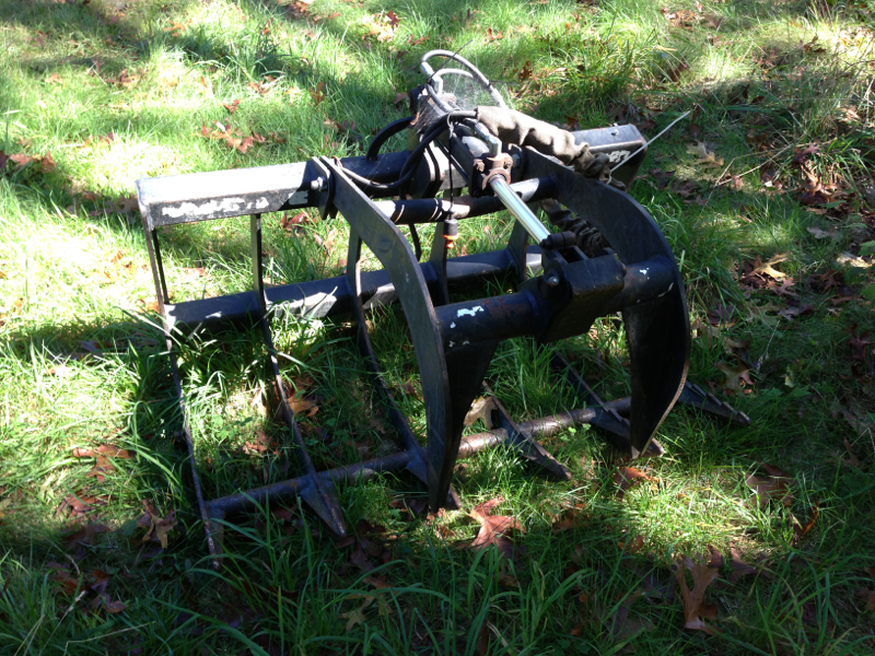

Ive been able to push trees(mainly mesquites) over with my bucket but I few small roots remain intact so I decided a grapple would help me complete the job by breaking few small roots then piling the brush into a burn pile. I would like to push them over with the grapple on the front so I don't have to change between the bucket and the grapple. the ground out here is pretty saturated right now so pushing them over hasn't been a problem for my tractor. My tractor weighs in at 10k its a little larger than CUTs I know FEL aren't designed to push but im only doing a few acres with my loader and the rest I will buy a track loader or contract it out
EDIT: I wouldn't drive through the woods and try to rake 6"to 8" deep with any grapple rake that seems very dangerous... Im talking on a per tree basis where I can already see the roots after I push it over.. these trees are less the 6-8" in diameter too.

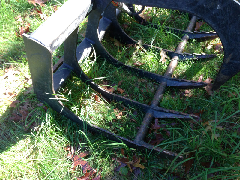

48" light duty grapple is perfect for what you are describing you intend to do. I've been doing it for years with DK40se and 48" 3/8" tines grapple.
This is what my grapple looks like after a couple hundred such tree removals.
Technique I use is to 1) push the tree partly over, 2)push again after moving tractor 90 degrees until roots are exposed, 3) stick the grapple under the roots. Drive forward in 4wd low while lifting plus curling the grapple. Usually they pop right out. If not then push over some more from different angle then repeat #3.

Thanks island tractor u put my mind to ease ...the 48" Titan unit should be perfect!!! I'm going get it ordered today !! :)
