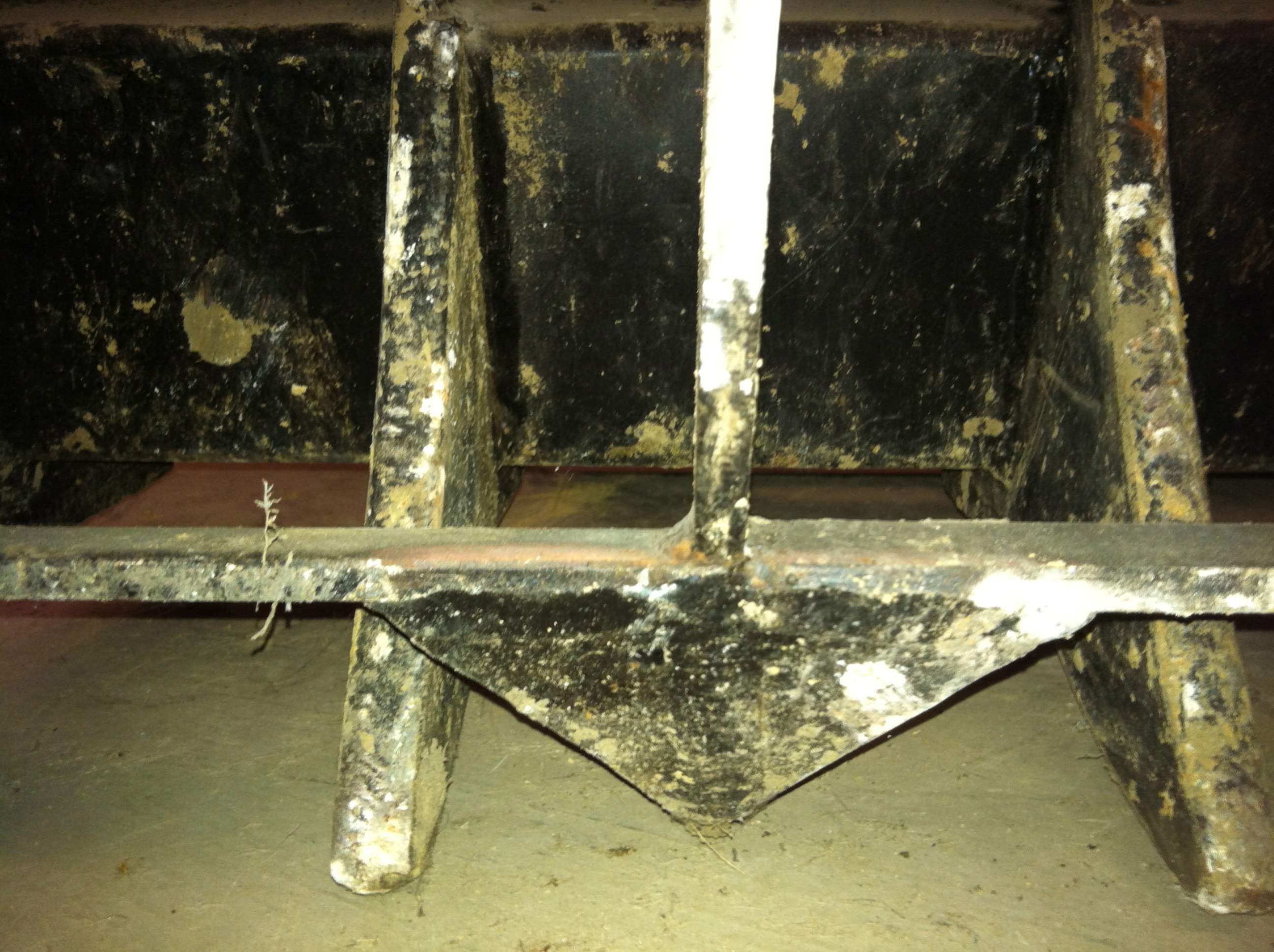

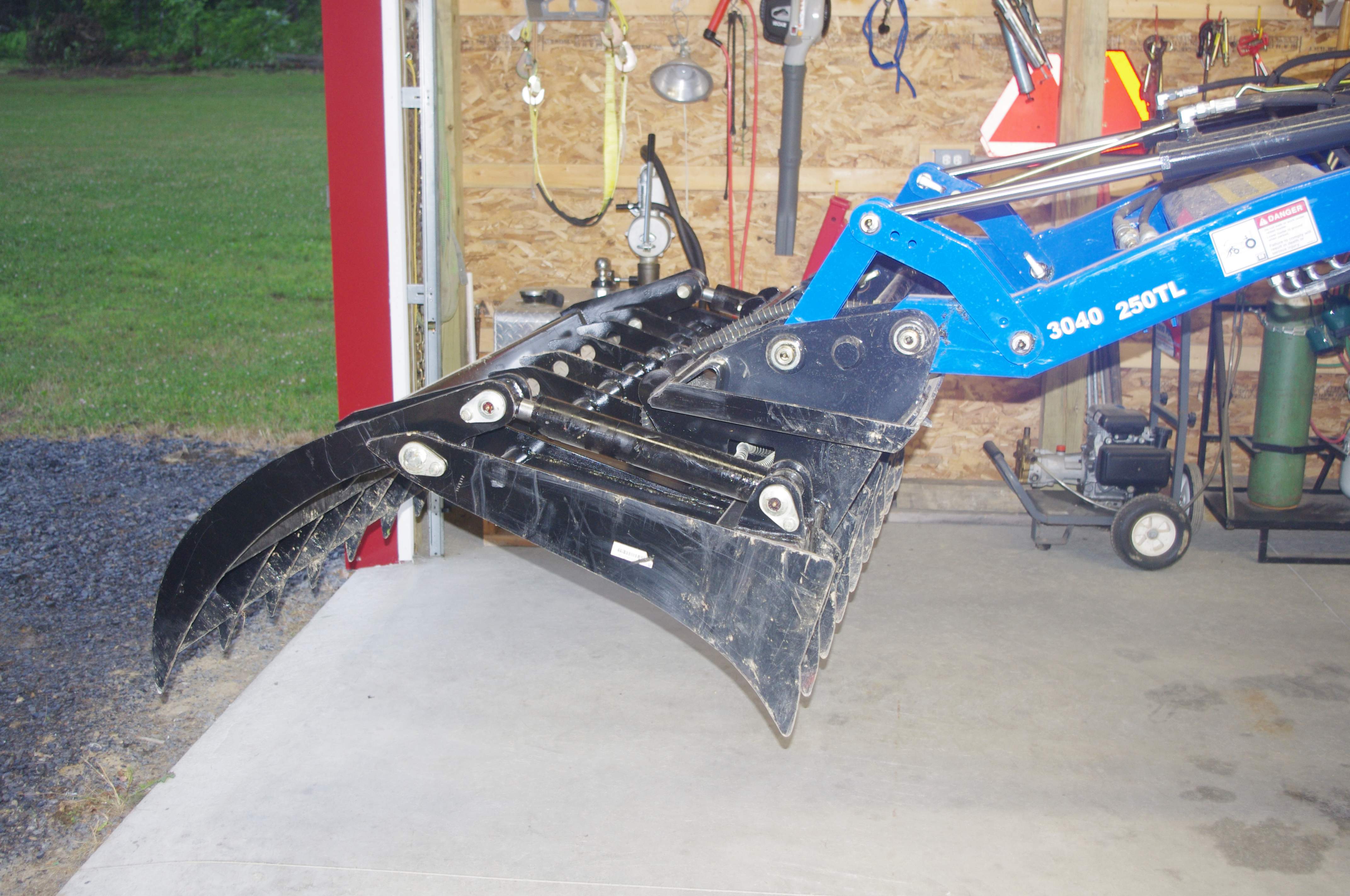

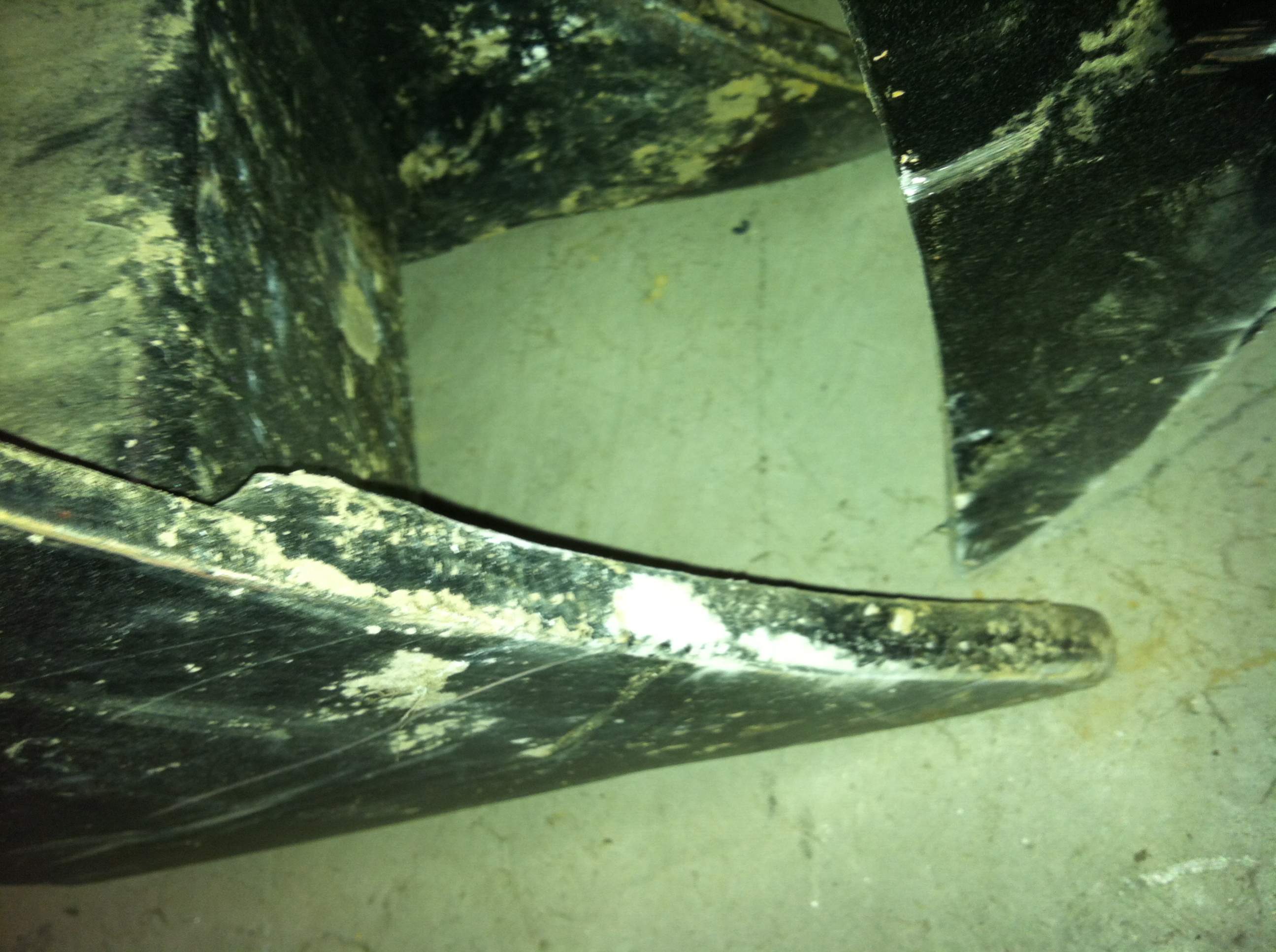

I bought this style Grapple for my needs. Worked great on brush and limbs for clean up. While moving logs I realized the tines needed reinforced and the tips would bend. No more bending since they were reinforced on top and bottom.
Your reinforcement looks good. What brand is the grapple?
