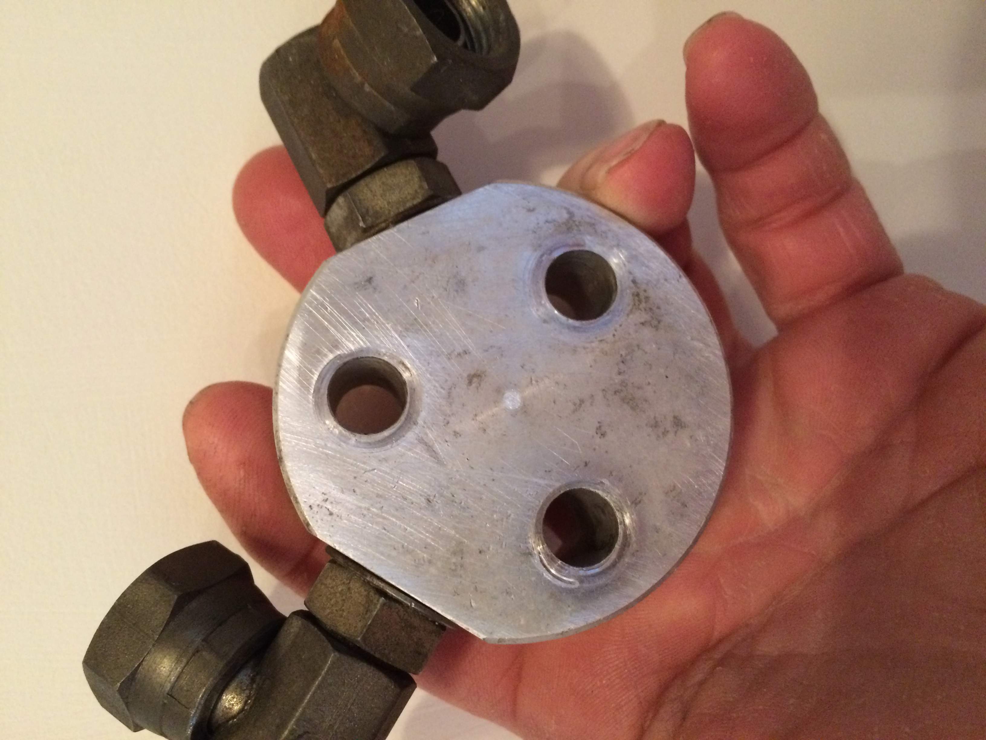

Duwem, thanks for the tip. Called Valley this morning and YES, they do have a local machinist who is manufacturing them on request. It should be here within a couple/three weeks. :cool2::cool2:

What do they charge?
Valley Power charges $175 for the adapter plate. It has one inlet and one outlet port. For this application, I'll need the use of my three point arms for a landscape rake, so the other option you mention wouldn't apply. My dozer blade has one cylinder for up/down and two cylinders for right/left angle. Control valves will be mounted on a pedestal adjacent to the throttle lever, same location as for a FEL.

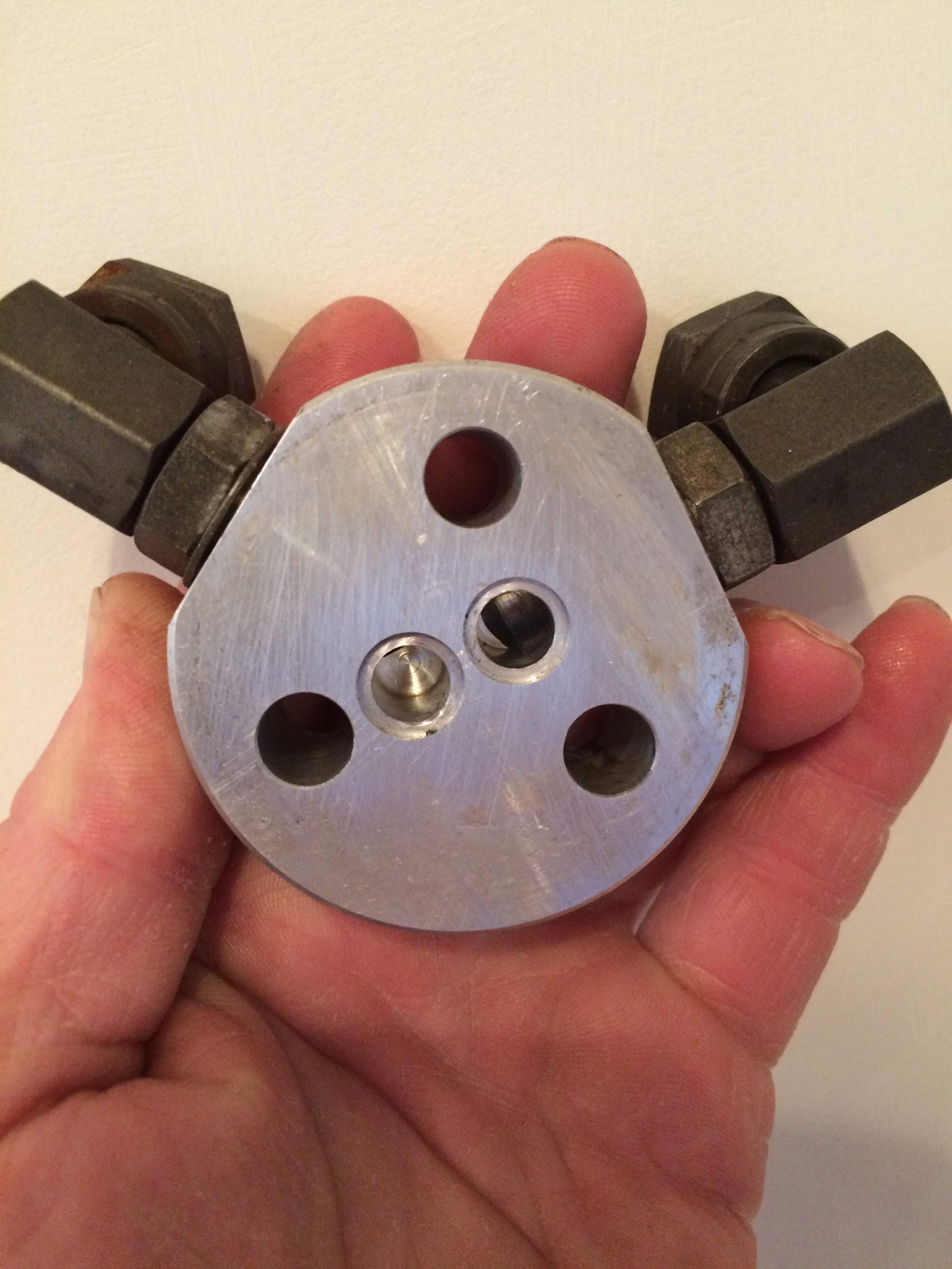

   / need help finding a HYD tap adapter for a Satoh Beaver #44

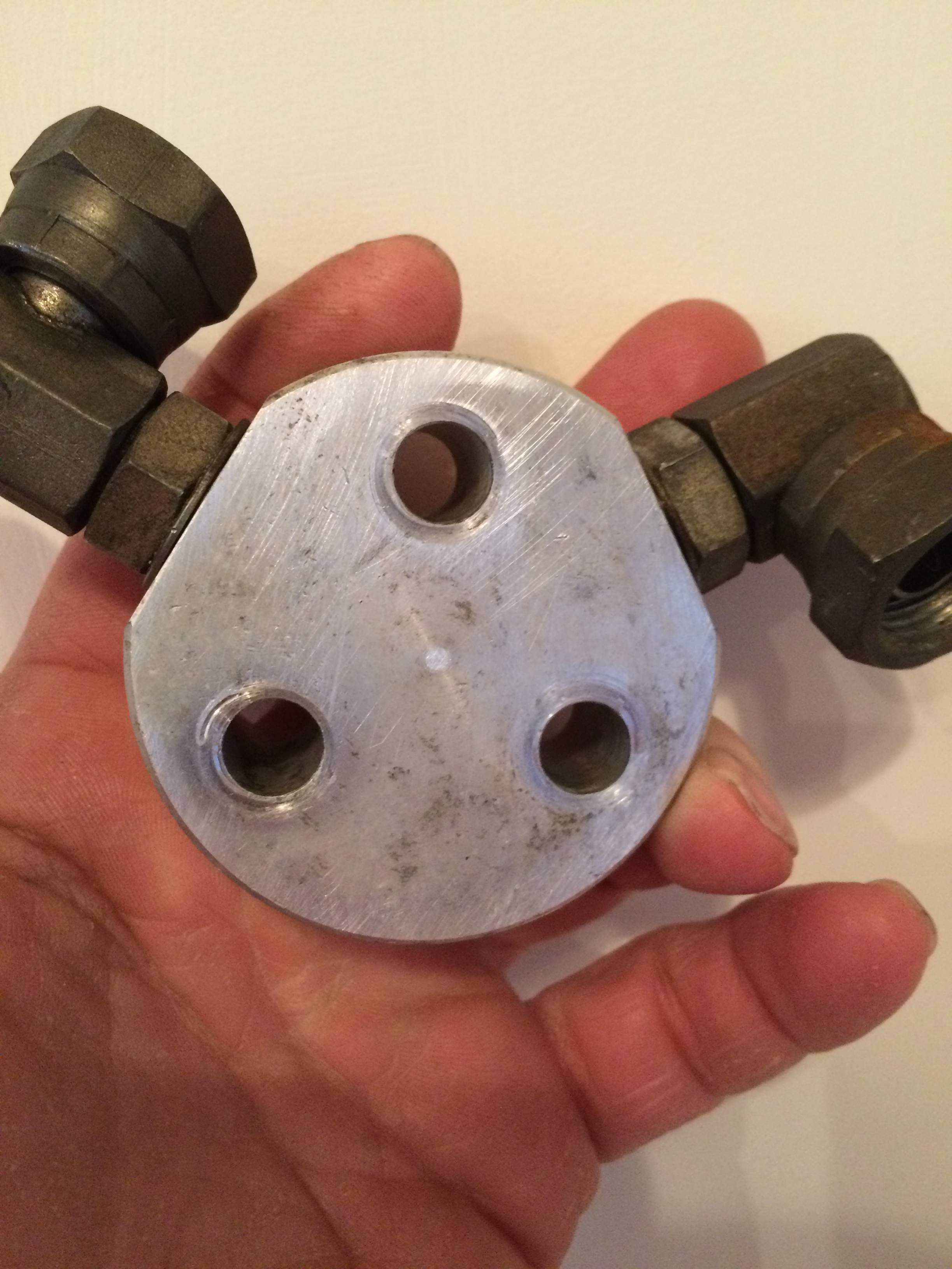

This is the one I was sent. They assured me numerous times that it would work but the bolt hole pattern is about twice the diameter. Any idea what tractor this one fits?
I recognize that one as being what fits a MT180D (and 160D)

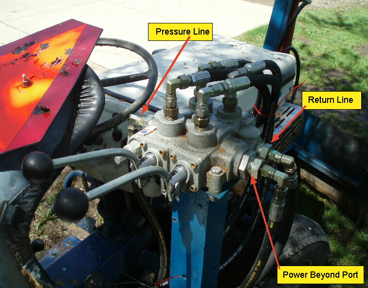

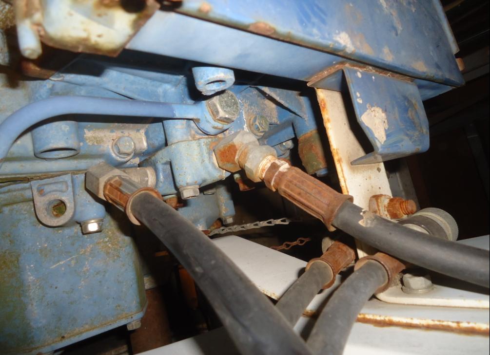

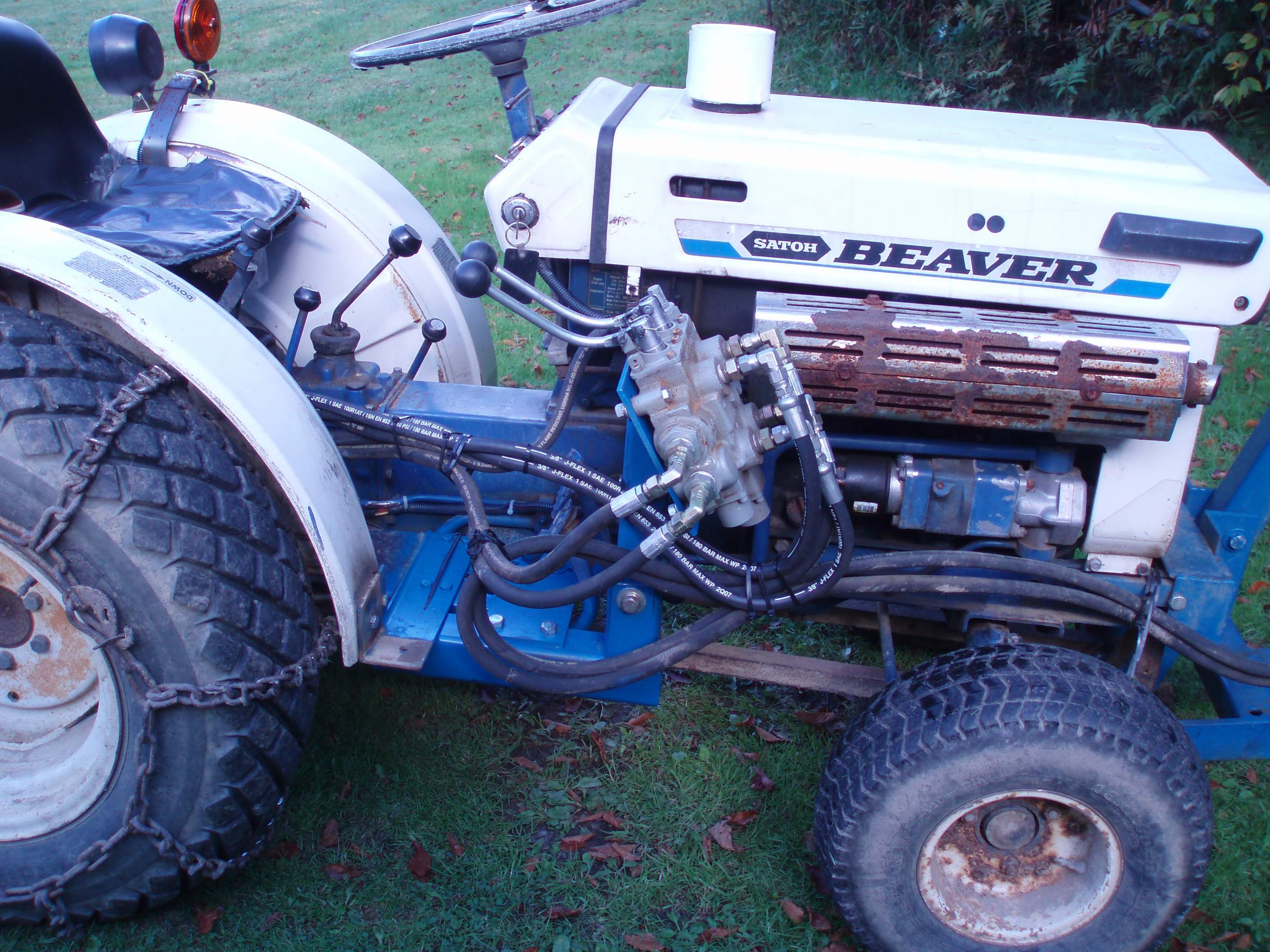

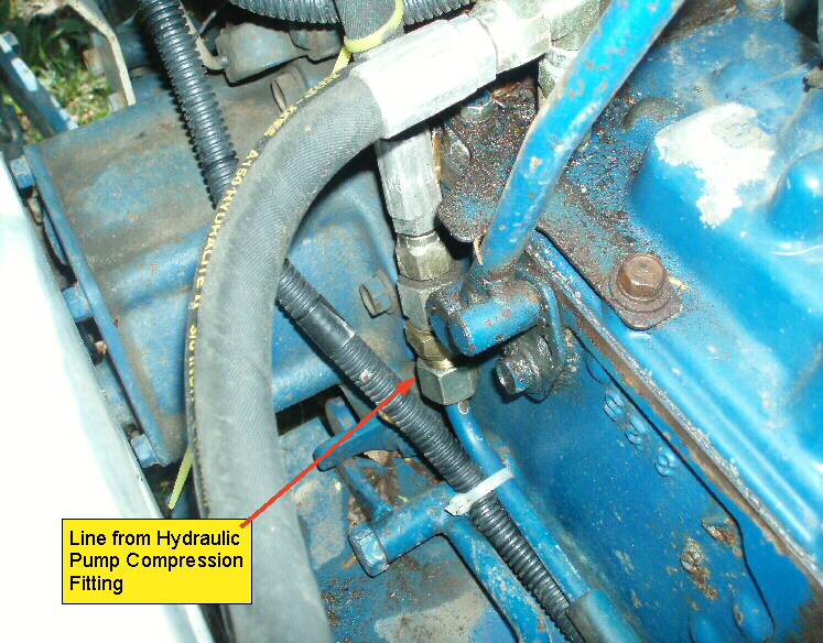

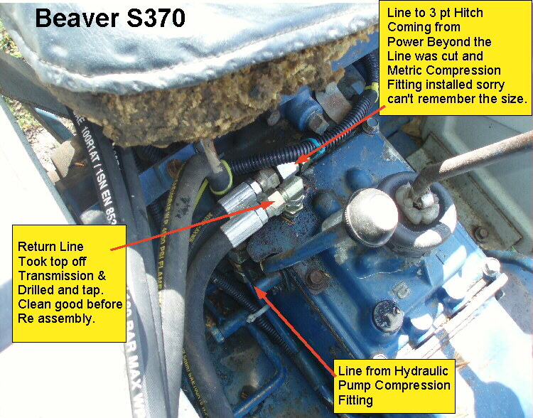

I did this I think 4 years ago and had no problems.
   / need help finding a HYD tap adapter for a Satoh Beaver #46
Things that might be useful or at least interesting.

I have 2 S370's now. A 2wd, and 4wd. I'm putting the FEL from the 2wd to the 4wd. The 2wd had the external hydraulic adapter. I decided to make a second adapter, so I dimensioned it, and have it programmed to run on a CNC on Monday. The pics are of the one off the tractor. I'll post the finished product next week. --------------------------John :drink: 327.jpg
