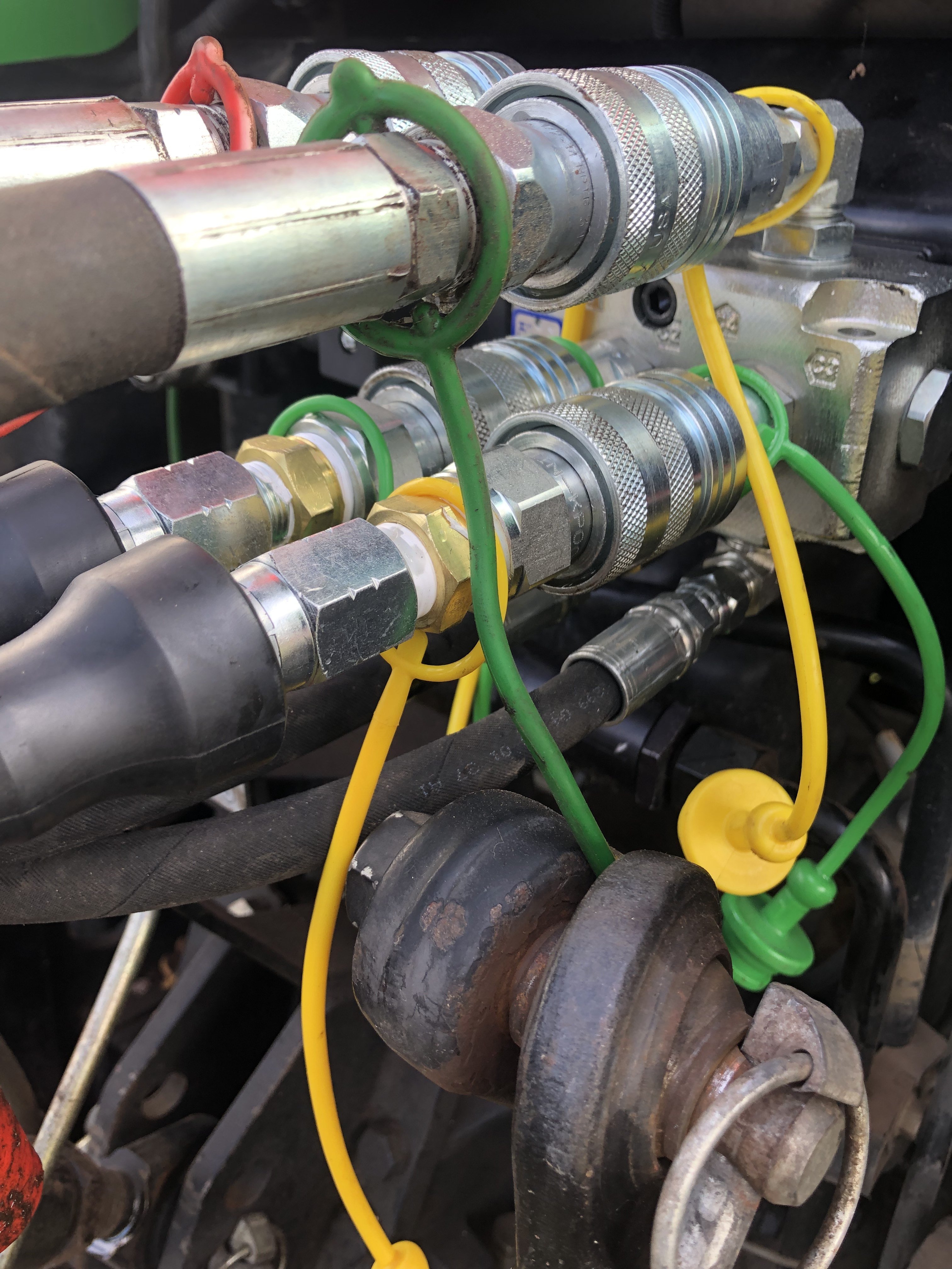

Here are some pictures of a manual diverter set.
Do you want manual or electric?
I'm sure we could work out an electric set.

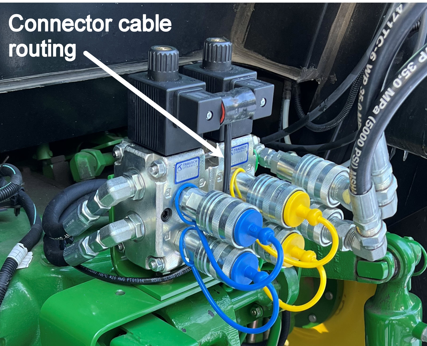

With an electric diverter, you can have the control with a momentary switch on the valve lever so that you can actuate 2 different functions and never take your hand off the lever. :cool: Actually, you can do this type of setup with up to 3 diverters so that you can operate 4 separate functions and never move your hand from the valve control lever. Just an FYI. I think that you only need the one additional set of couplers.
Cost can be a factor and the manual diverters are only good for adding a single set of couplers. The electric units can be stacked for as many as you want actually. I've never done more than 3. Controls can start to become messy when you get too many.
A set of 2 and 3 are pictured for examples.
