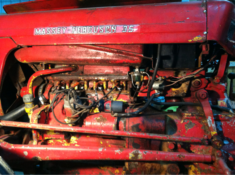

Does this look like an MF35? Are there any other ways to try and identify the year other than the tag? Let me know and I'll try and focus the camera on those areas better when I take pictures today.
The tractor serial tag is a key piece of evidence to idetify the make year of a MF tractor. Without it, one can only guess it's age. The engine I.D. Tag is located just behind the starter on a Z134 gas engine. With proper previous owner documentation would verify as to the tractors true identity. The serial number does not jive with the index photo i posted above. There is no doubt as to what type of tractor it is. The year is still the question. Without a hands on inspection of casing number, would only narrow to maybe within a couple years. I never could figure out the reasoning for not riviting that tag to the frame. Puting sheet metal screws to secure it only encouraged theives to remove them.

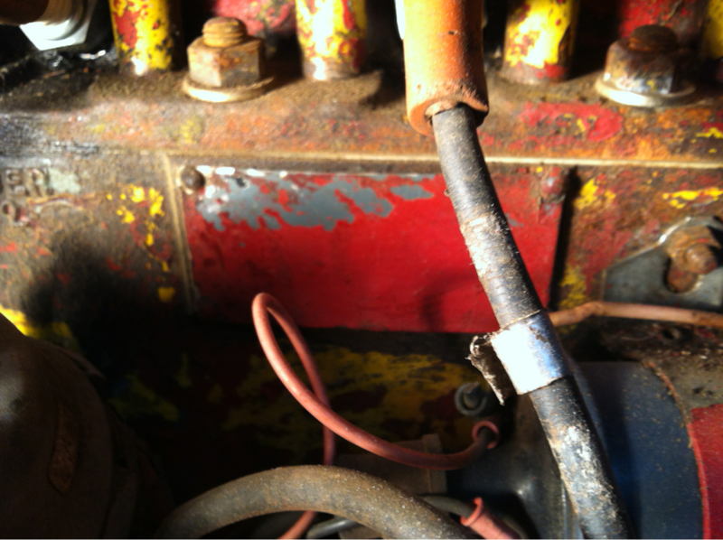

Ok, I finally had a chance to take some pictures today of a little better quality.
The last photo is the plate on the engine. It's been painted over and all I can make out is Racine WI. Is that where the Continental Z134 was made?
I've also found some more letters and numbers. On the back right side of the tractor near the hydraulic fluid dipstick it's stamped: H Ms 23 183253 M5 C 750.
On the left rear axle it's stamped: 183 251 M2 on the right it's stamped 183 248 M2
The other number I wrote down is: CWC 0202 Z134A500 A (I can't make out the next letter). But for the life of me I can't remember where it is on the tractor now.

The serial number is stamped into the metal tag on the engine block. It's not going to reveal the tractors true age. The other numbers your finding are casting numbers which represent part numbers. The Z134 number your referring to is probably on the manifold signifying an original manifold.
