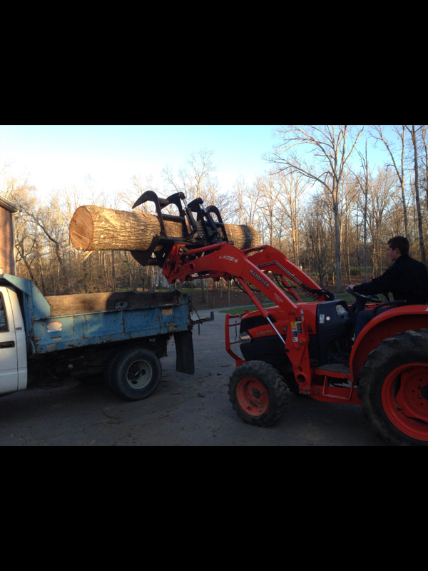

   / Need help on Right Tractor For a Grapple. #25
A cut in the 35-45 hp range is a plenty capable machine. 50 HP plus for 14 acres is way overkill. Lots of guys here including myself have more land and less tractor. Your neighbor doesn't know what he is talking about. This red oak log is bigger than 20 inches on both ends and 10 feet long and I loaded it with a 34 hp tractor. image-1242153857.jpg That looks pretty useful to me. I can spread dirt faster than 2 trucks running a short distance can bring it. If you own a chain saw you can move ever the biggest tree with a BX. I have only met two logs that my 34 hp tractor couldn't lift as is. Both were over 36 inches diameter and over 10 feet long. One was red oak.

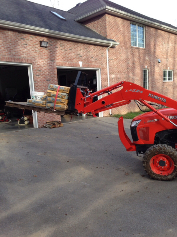

Here is what a L3800 will do with a 1/2 ton.
The red oak log in my previous post was well over 1200 pounds. The L3800 as shown in the above picture can lift 1,000 pounds and it couldn't budge it let alone make a full height lift with it.
