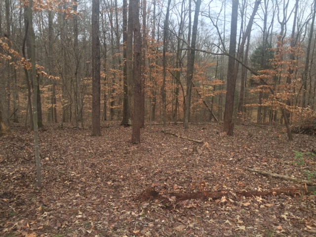

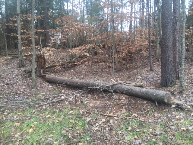

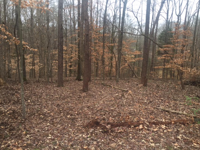

There is no urgency for the purchase at my leisure. Budget is flexible, just concerned as I started at 19K now looking at around 30K+. Mostly hardwoods (oak, hickory, and some clusters of short and Virginia pine) and the short needled pine are the weakest and most prone to fall. The land used to be a tobacco farm about 50+ years ago. Picture below of what it looks like and what has fallen and would like to move.
View attachment 452293View attachment 452294View attachment 452295View attachment 452296
I don't see the need for a tractor and grapple with a high lift capacity looking at your pictures. Also keep in mind that it is easier to maneuver through the trees if you cut them down to about tractor width. A smaller tractor can obviously fit through the trees and you might need to pull them out to a cleared area to manage them.
While I would personally opt for a 50hp tractor for faster work in the fields I don't see where a 35hp tractor would have a problem moving the trees in your pictures. A subcut could pick up most of the trees in your pictures but ground clearance would be a problem (think stump holes), So anywhere between a mid size and larger compact would seem to be a good fir for you.

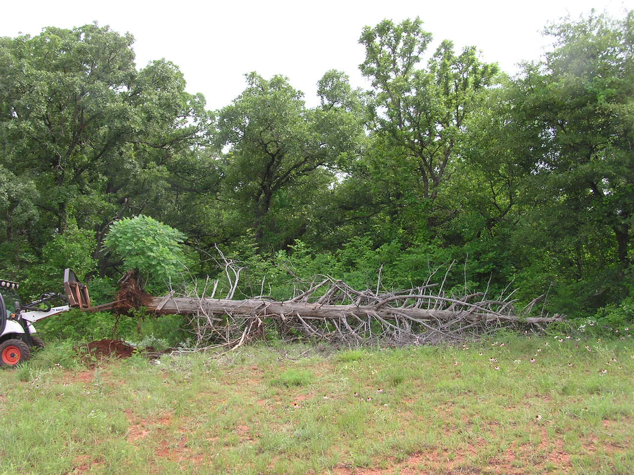

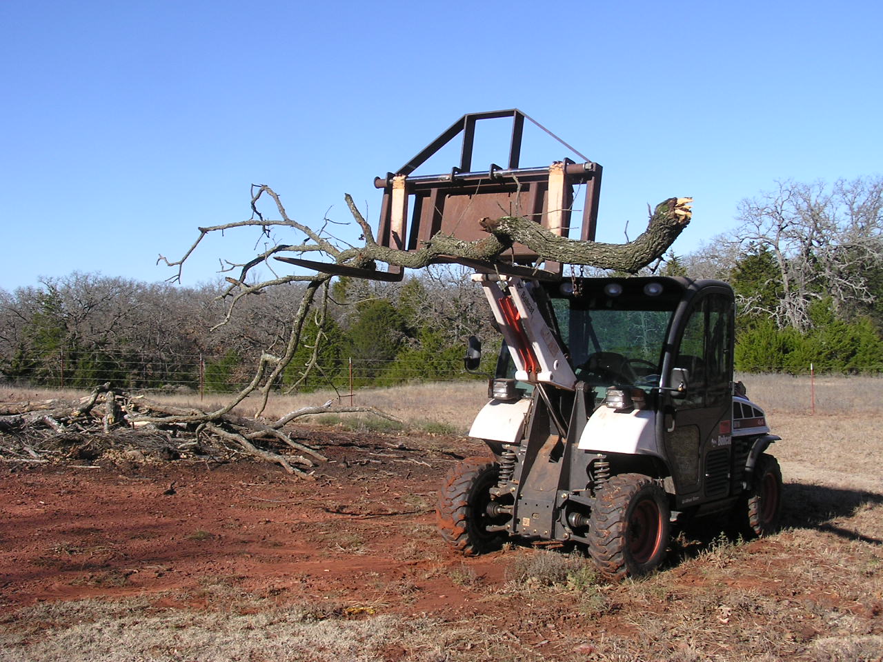

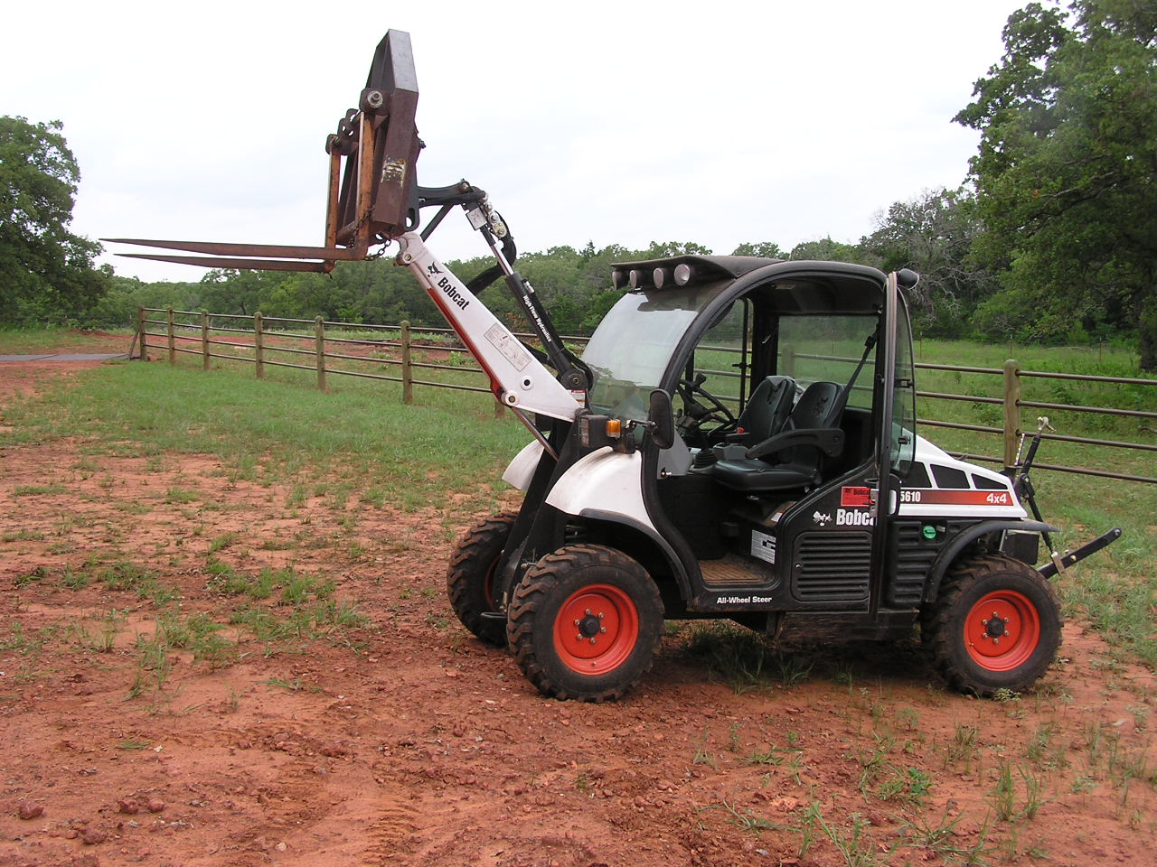

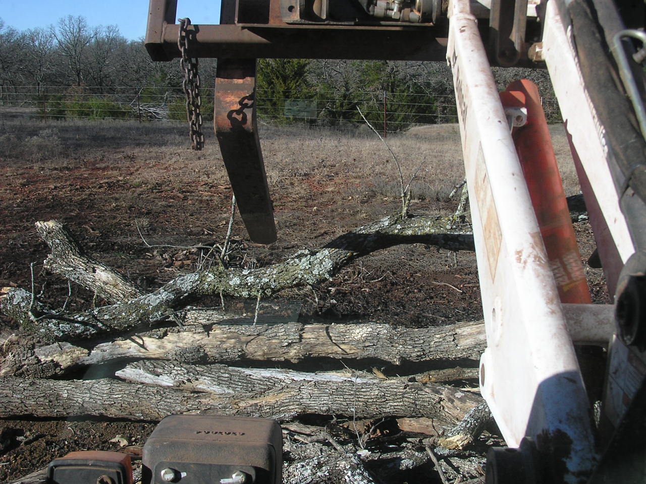

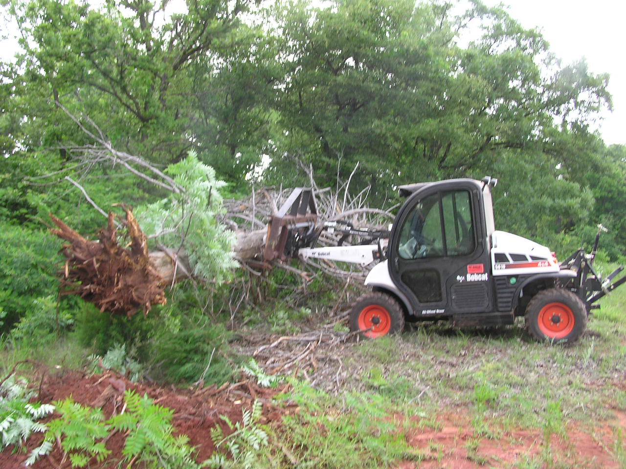

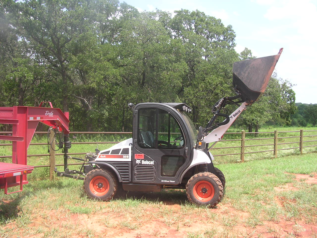

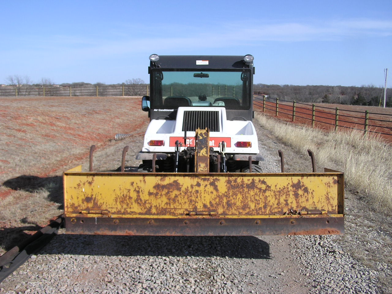

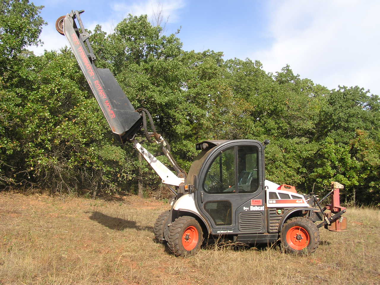

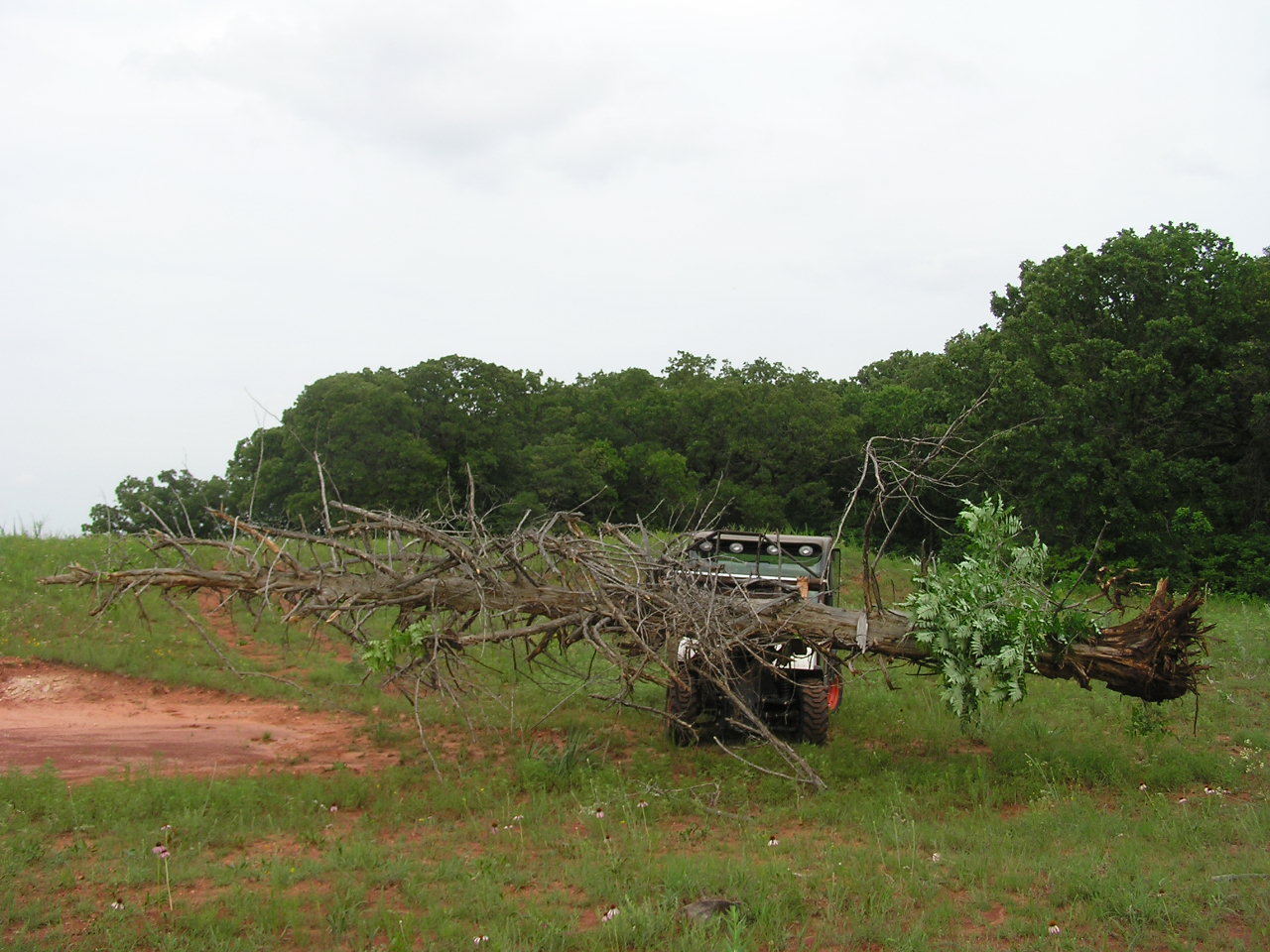

You might consider a used Toolcat. Better view of the grapple or forks, better maneuverability with 4 wheel steer and crab steer, better ride with independent suspension. Two models, 5600 with a dump box and 5610 with a 3 point hitch.
More pictures: http://www.tractorbynet.com/forums/toolcat/270965-toolcat-5610-series-f-pictures.html?highlight=

What is the maximum lift height of a tool cat?
   / Need help on Right Tractor For a Grapple. #37
Can't find it now on the new Bobcat Website, but seems like it was listed at 7.5 feet on the old Website.
I could see it being good for lots of uses including a grapple. Appears to be a thirsty machine because of hydraulic systems but it would definitely be a contender if front grapple work is the main use. Very maneuverable and well appointed. Should be a great tool for building landscapes was my first thought. So what does a new one cost with the three point hitch version?
That depends on your dealer, MSRP here for the new G series is $64,526, My dealer said $56,000.
#40
Great pictures! Very impressive. That though is just way above my budget. I just looked at some use online and even the used (tracked skid steer) are beyond what I want to spend. :-/
