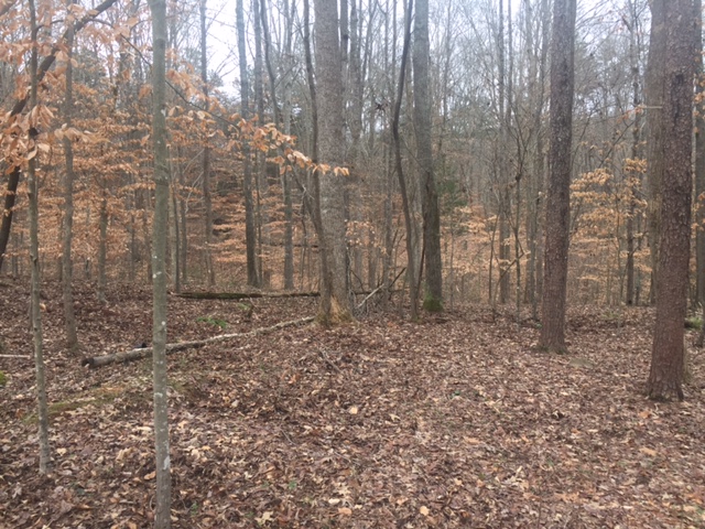

There is no urgency for the purchase at my leisure. Budget is flexible, just concerned as I started at 19K now looking at around 30K+. Mostly hardwoods (oak, hickory, and some clusters of short and Virginia pine) and the short needled pine are the weakest and most prone to fall. The land used to be a tobacco farm about 50+ years ago. Picture below of what it looks like and what has fallen and would like to move.
View attachment 452293View attachment 452294View attachment 452295View attachment 452296
I don't see the need for a tractor and grapple with a high lift capacity looking at your pictures. Also keep in mind that it is easier to maneuver through the trees if you cut them down to about tractor width. A smaller tractor can obviously fit through the trees and you might need to pull them out to a cleared area to manage them.
While I would personally opt for a 50hp tractor for faster work in the fields I don't see where a 35hp tractor would have a problem moving the trees in your pictures. A subcut could pick up most of the trees in your pictures but ground clearance would be a problem (think stump holes), So anywhere between a mid size and larger compact would seem to be a good fir for you.
