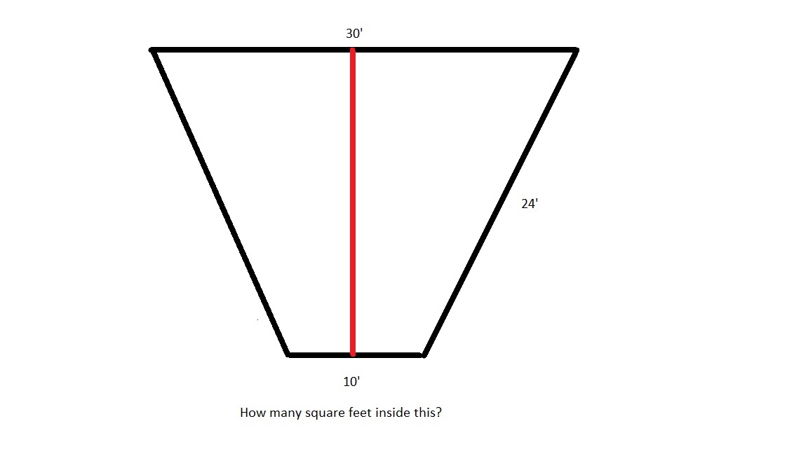

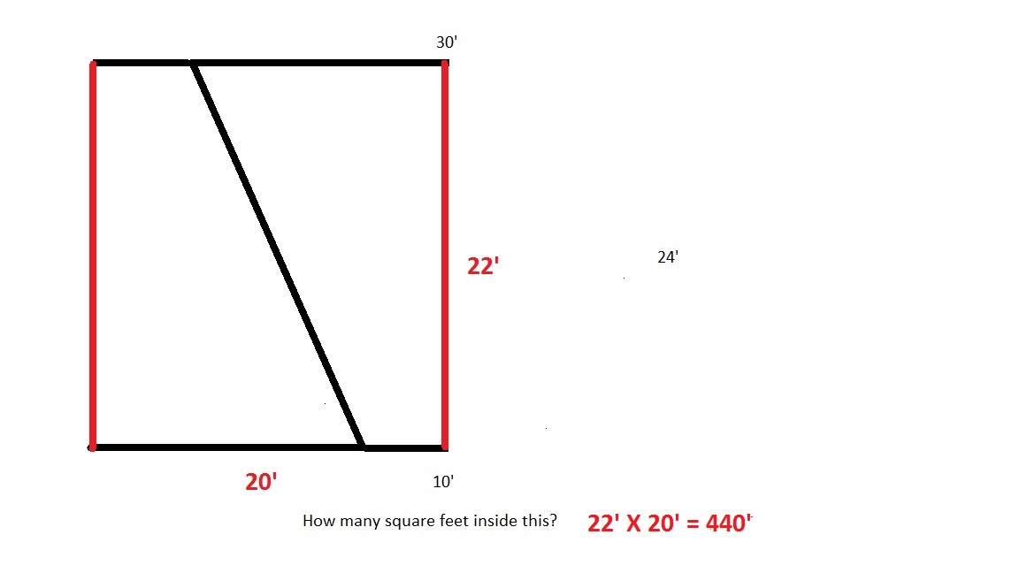

I thank everyone for their help. I was getting so many different answers I had to try to figure it out without using math. I drew it on a piece of paper, cut out the 2 sides, placed them together into a square and measured it.
My answer is 440 square feet.
I hope I am right because I am figuring out how much concrete I need to pour my driveway apron.

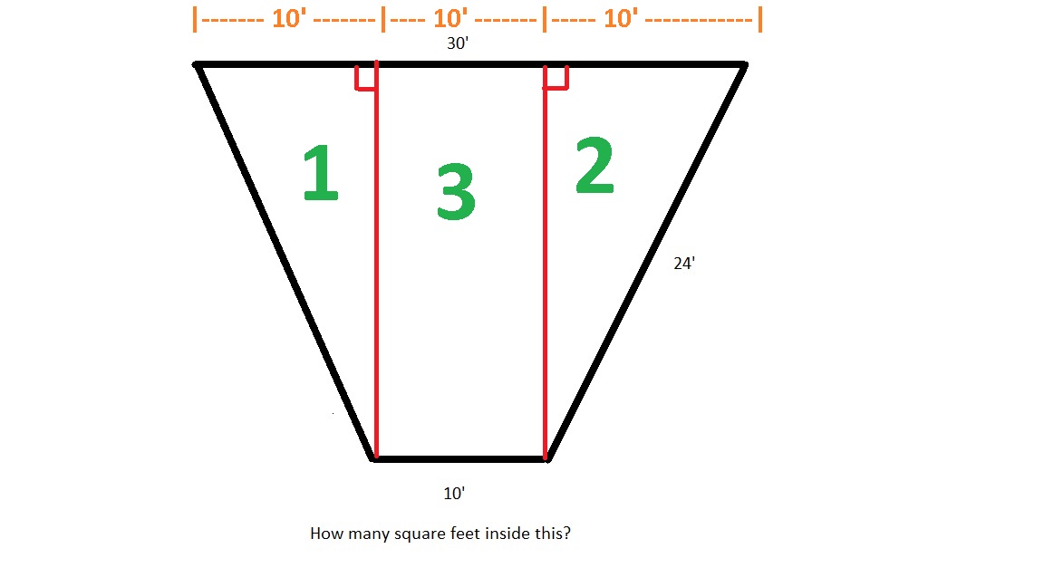

The distance between the two straight lines is 21.8 sqrt (24^2 - 10^2). So 21.8 x 20 = 438.
I'd go with 480 for concrete, I'd rather leave some on the truck than be short.
You're close enough! Dieselcrawer is dead on - 436.35 sq. ft. Your 22' dimension is actual 21.8 feet.

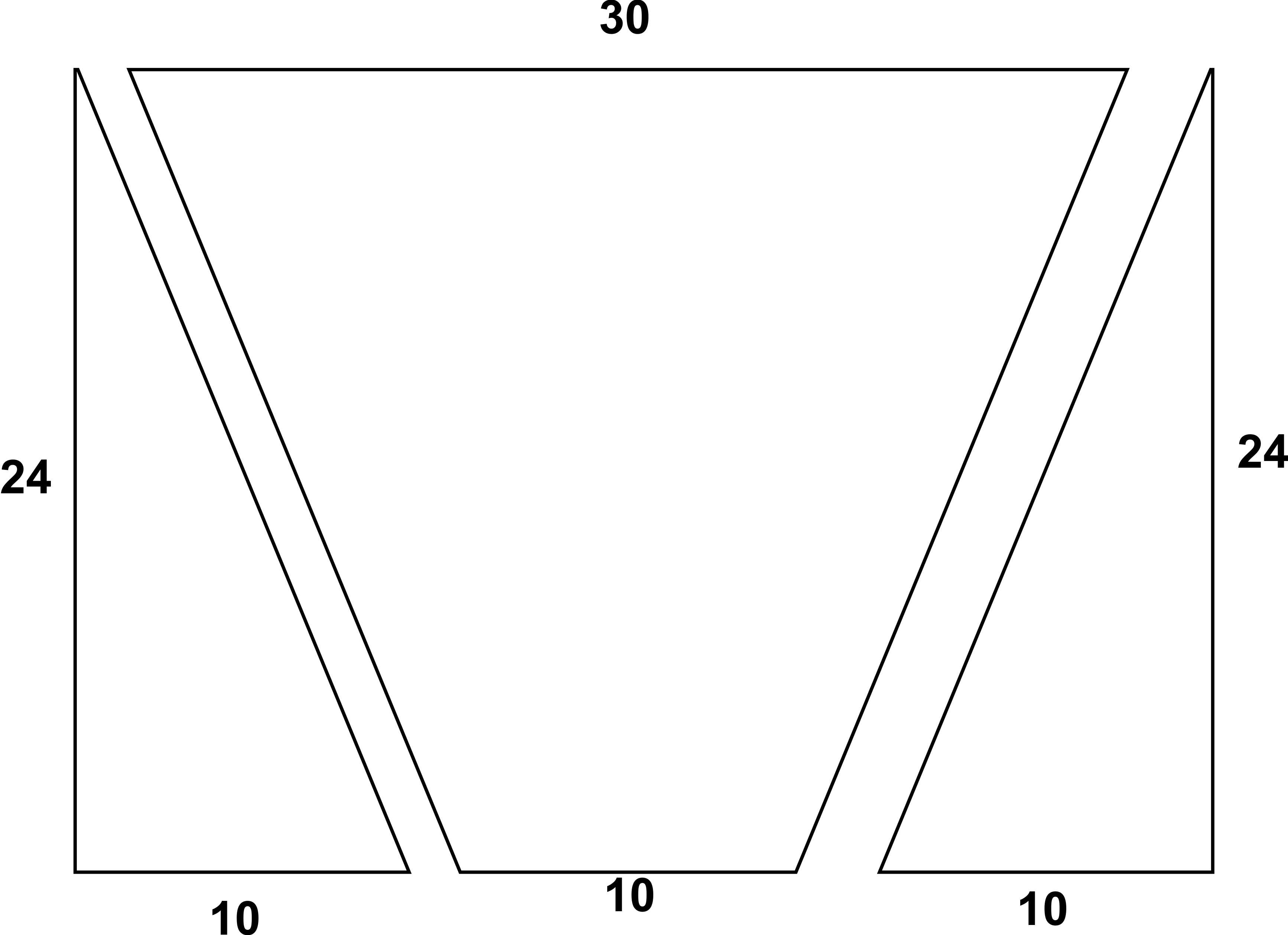

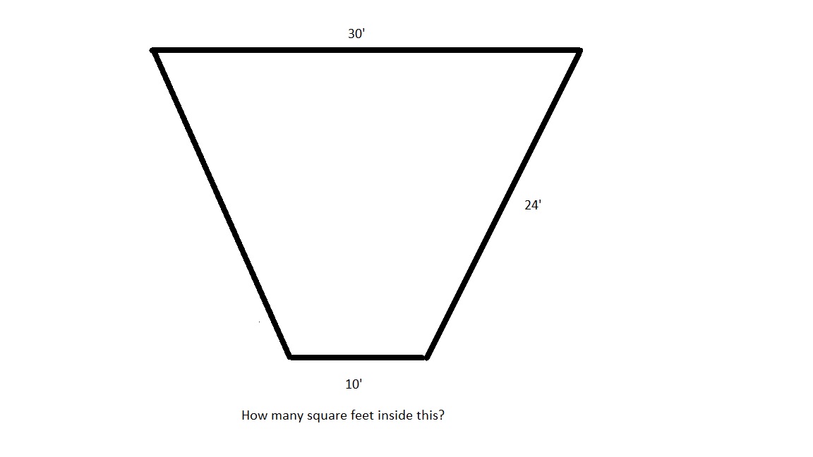

It's been so long since I got out of school, I can't remember how to solve this problem.
I can't even remember if its geometry, trigonometry or whatever. Maybe its early Alzheimer's?
Please help me find out how many square feet this is.
u got a rect 10x whatever. u got 2 rt triangles10x24 x whatever. solve triangle for whatever and u got it. 100 + whatever^2 = 24^2
