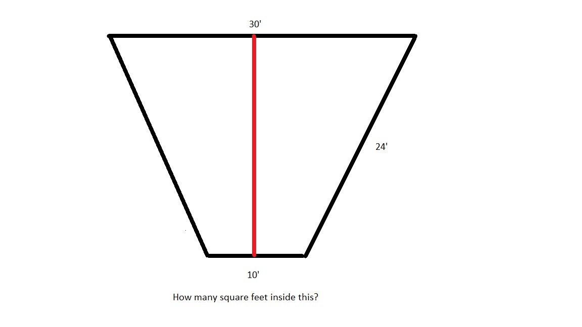

Hey, guys! The vertical height is not 24. That was the length of the slanted side.
I still say 1/100 acre. Just divide the cost of an acre/foot of concrete by 100 and multiply by the fraction of a foot you want for thickness. :)

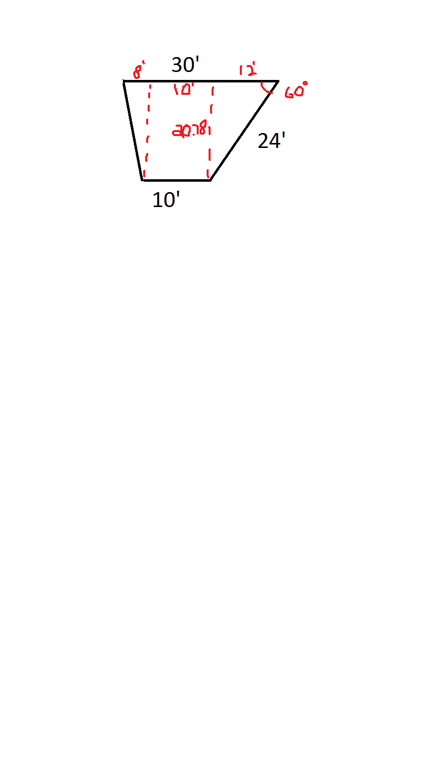

You're close enough! Dieselcrawer is dead on - 436.35 sq. ft. Your 22' dimension is actual 21.8 feet.
Yes, I think Dieselcrawler probably is exact. My figure of 440 sq. ft. was made by measuring paper with a cheap ruler so I could not tell the difference between 22' and 21.8' when I was measuring.
Now since my concrete will be 6" thick, 436.35' X .5' = 218.175 cubic feet. With 27 c.f. to a cu. yard that equals 8.08 yards so I will order 8 1/2 yards of concrete.

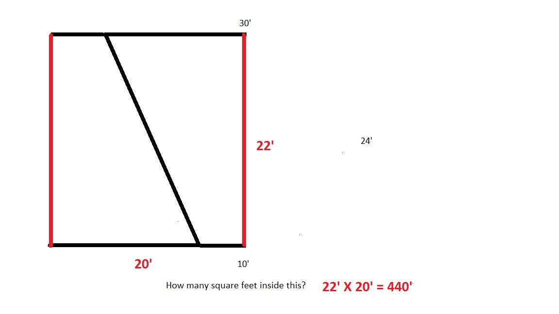

I thank everyone for their help. I was getting so many different answers I had to try to figure it out without using math. I drew it on a piece of paper, cut out the 2 sides, placed them together into a square and measured it.
My answer is 440 square feet.
I hope I am right because I am figuring out how much concrete I need to pour my driveway apron.

u got a rect 10x whatever. u got 2 rt triangles10x24 x whatever. solve triangle for whatever and u got it. 100 + whatever^2 = 24^2
That's right. Then take 3 guzinta 436.4 = 145.5 cubic feet. then 27 guzinta 145.5 = 5.4 times thats the number of yards of 6 bag See-ment you will be spreading with your apron on. My cement guy also specifies some type of moisture content along with the order for seasonal (temperature mainly I believe) consideration. The new thing for me is to pour it as one big slab and then slit it with a concrete saw a few days later for the crack/seams stress relievers. I just had a pad poured in front of my machinery shed that's 15 x 60. I got tired of laying down in gravel when repairing equipment. Its so nice I ashamed to park anything dirty or leaking oil on it.

Looked it up. It a side (30') plus b side (10') divided by 2 times the height. We don't know height and there's not enough info to determine.
There is enough info. Look at it as 2 right triangles plus a rectangle in the middle. Find height by using Pythagoras's theorem. At 81 I don't recall the math.
