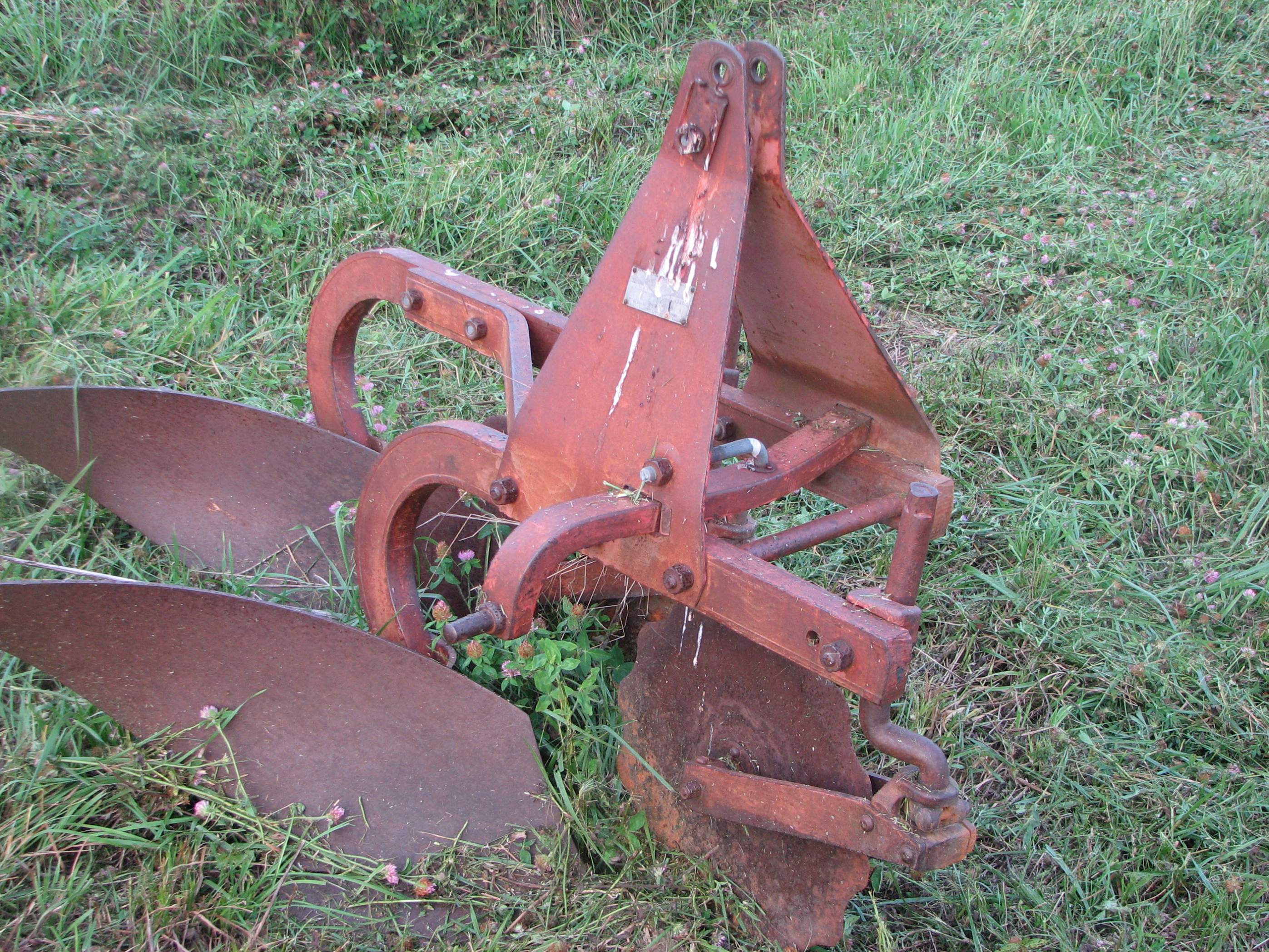

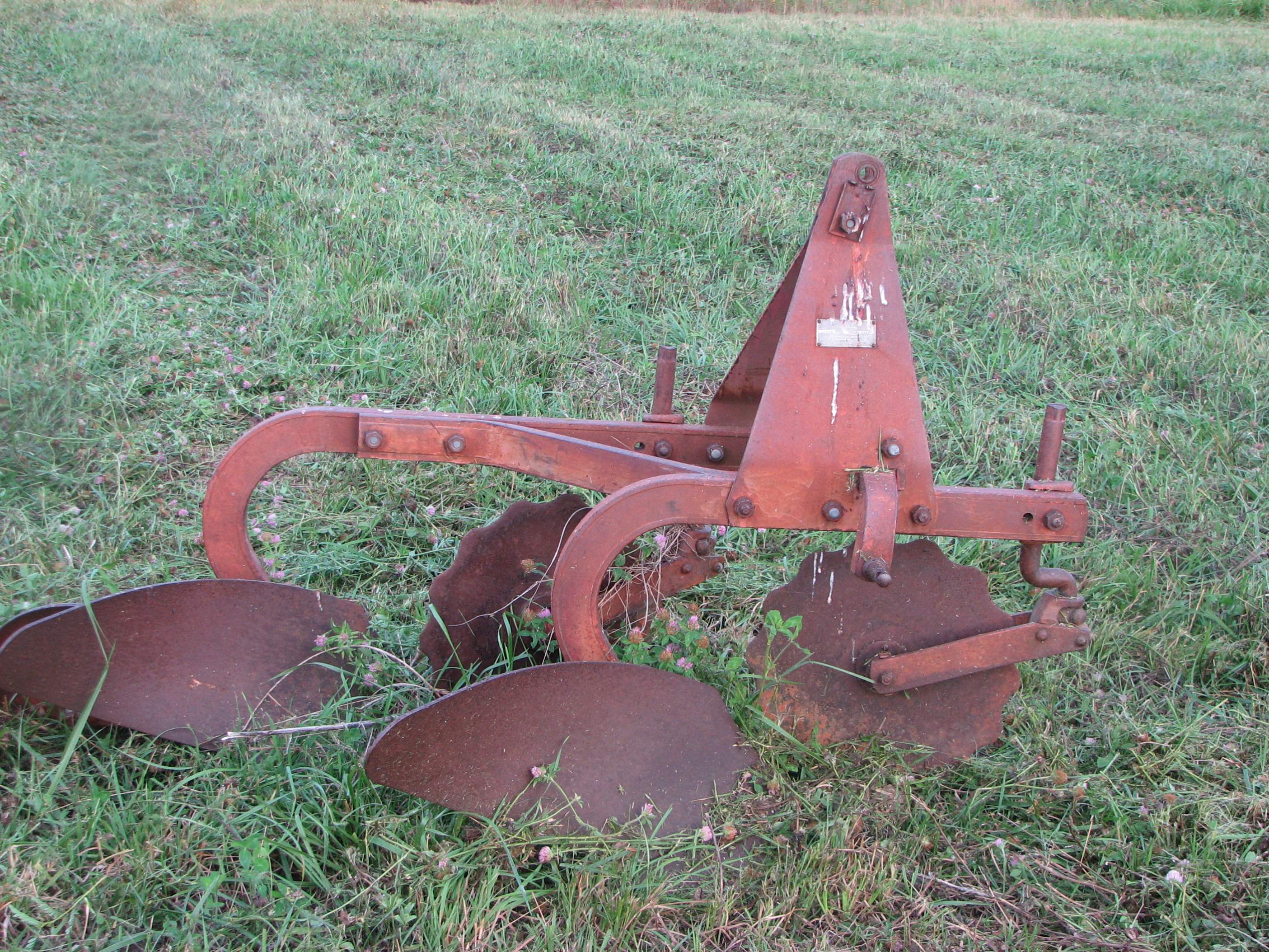

Hi guys i have found a 2 bottom plow the guy dosent no much about it. I was wondering if anyone knows what kind it is? and if its worth $175. dollars. What do i need to look for ? What can go wrong with them? I would want to use it for food plots right away. Thanks in advance .

It is one of the older Dearborn with 2 piece set up (moldboard and point). Difficult to find parts for this plow, However, the 2 coulters are worth $75 each and if the points are good now, I would buy it in a heartbeat. Ken Sweet

Yes, that whole rectangular piece at the bottom of the moldboard is the point or share. You can get on the back side of that plow and rock it toward you very easy. When you do this, the point will be visible for inspection. 2 strong men can load this plow manually, if no loader or boom is available. Ken Sweet

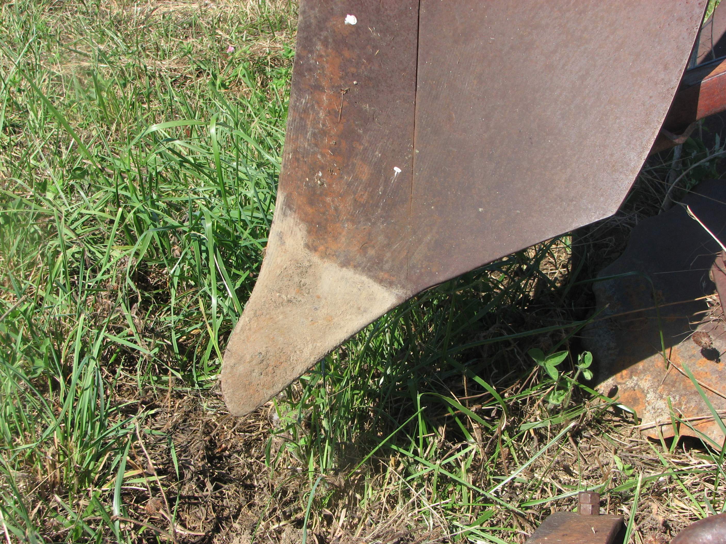

Ken here is a pic of 1 of the points he said other point looks the same. The tractor i would be pulling it with is a ct335 bobcat we dont have many rocks but some tree roots .

That point is showing hardley no wear. It is the old style. I would still lay MY money down for the plow. We just sold 2 coulters last week for about what they are asking for the entire plow. Ken SWeet

That looks like a dearborn to me, very collectable to the ford N crowd. I bought one ten years ago for $200 without coulters for my 2N. They are absolutely correct in that the tractor should spin before damage is done.
