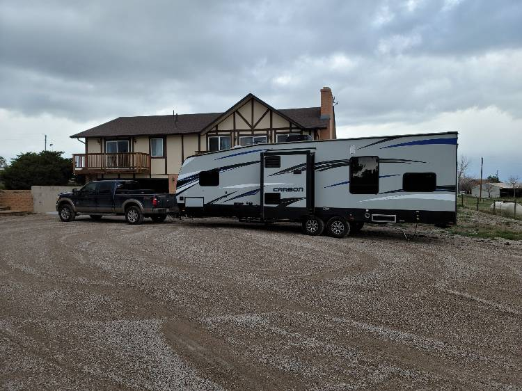

Exhibit 2: Toy hauler trailer. 12klbs, 1.5k hitch weight & everything properly sorted out according to cat scales (weighed with & without WDH). It tows really twitchy over 65 no matter how I fiddle with the WDH or weights. Not pleasant to tow more than a few hours. Hitch weight is way excessive if you don't have the toy in the back to unload the front.
Blue Ox WDH. Is OK to hitch & unhitch. Never had another WDH to compare it to. Trailer length, surface area & center of balance can be more important than a WDH.

You may want to get your trailer alignment checked, you may have an axle or both out of place because it shouldn't be twitchy.
Our TH is just over 10k alone, about 12,500 with the ATV's and max is 14K with the Jeep in it. I use the Equal-i-zer WD hitch and it tows fine empty or with either load. I have had speed creep up to 80mph before I knew it and no problem but I typically stay around 65-70mph.
Just FYI, This is on the receiver. Now the F350 (which we have) is only rated for 18K but this receiver is the same one used on the F450 so it shows the higher capacity.

Blue Ox WDH. Is OK to hitch & unhitch. Never had another WDH to compare it to. Trailer length, surface area & center of balance can be more important than a WDH.View attachment 758343View attachment 758344
