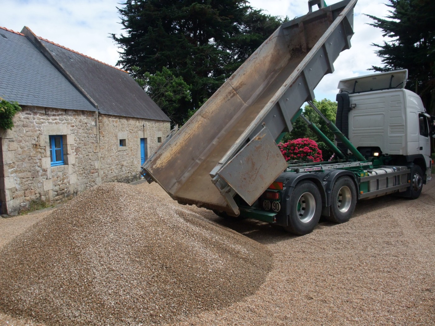

Its going to take some work to get it perfect. The driver did not do you any favors by not spreading it fairly even to start with.

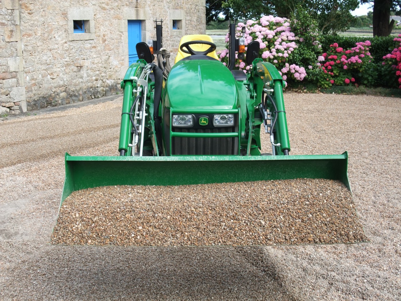

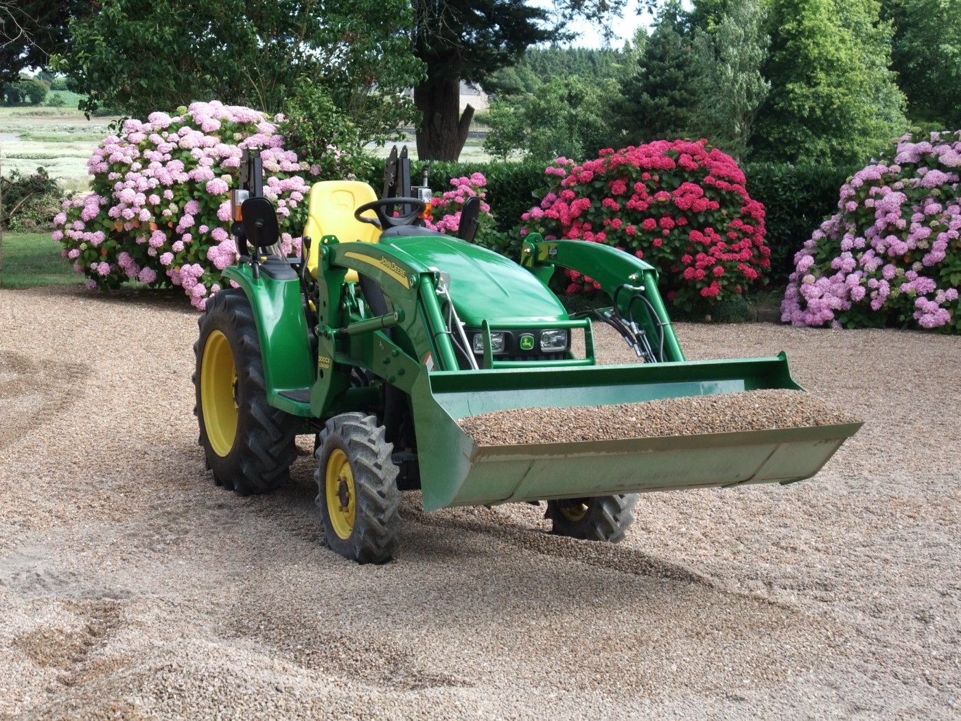

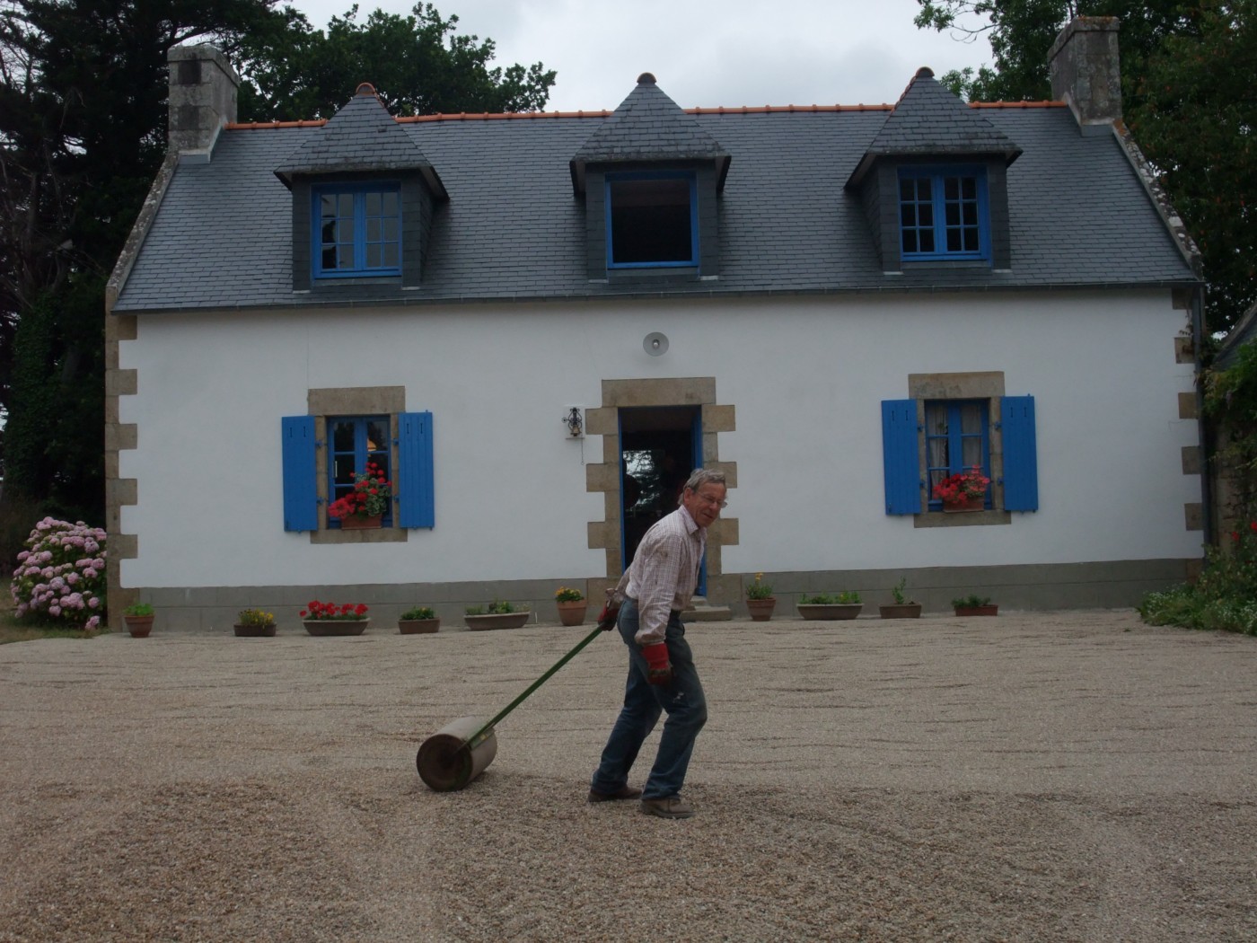

   / Need input - gravel #15

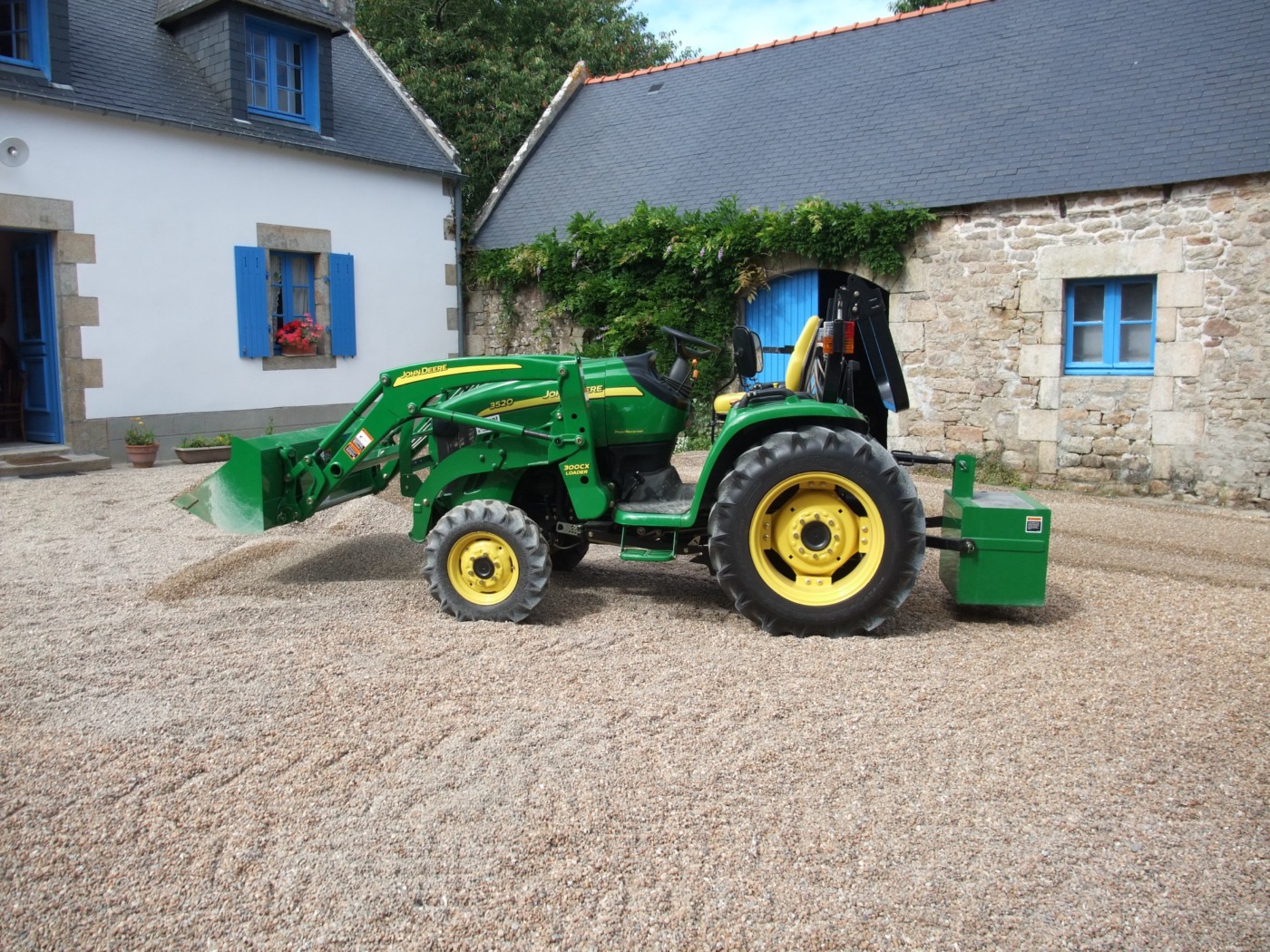

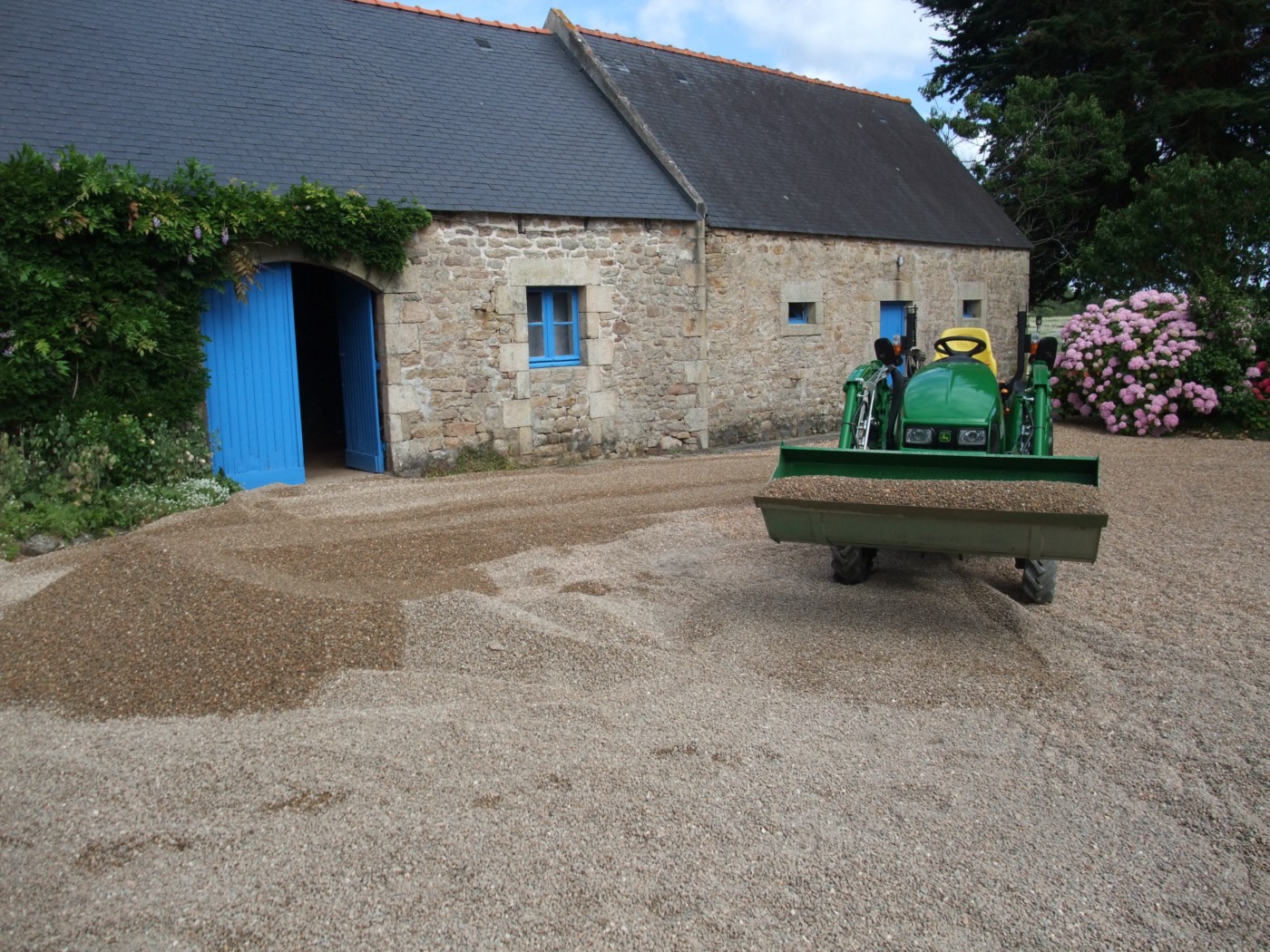

However you go about it, it's going to require work. I had all the gravel in a heap (unfortunately) as there was not much room for the truck to move. I picked up bucketfuls with the FEL and dropped them regularly. I then backed , flattening everything with the heel of the bucket. I didn't go into float as a measure of down pressure was required. I finished by hand with the good old rake and roller.
That is absolutely a beautiful piece of property. Approximately where in France are you located ?
Do you happen to know the age of the Home?
   / Need input - gravel #19
This is in southern Brittany, Pont l'Abbé more precisely. My small property borders on the Atlantic ocean, but I cannot quite see your side, even from the top floor. The buildings date back to the 19th century, but I haven't been able to find precise dates.
