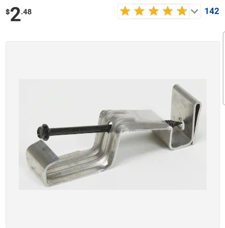

For installing gutters, why not use self drilling/tapping screws?

I couldn't justify buying a new toy ;)

These I've had good luck with, and what gutter installers just used on the horse stable.
