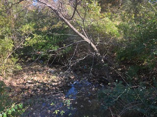

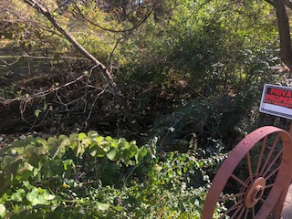

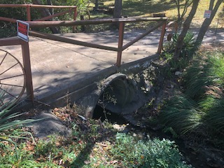

We have a bridge that is the only access to and from our house ( 100% our responsibility ) it is a 6' diameter concrete pipe with 6" wall thickness. From what I see there is what looks like 3/16" wire reinforcement in the exposed weathered ends. Then the concrete slab poured over it is 6" thick at the expansion joint in the center above the pipe and gets thicker as it goes out towards the street and our driveway. There is no information on this bridge at all ( apparently wasn't any codes at the time as this was farmland at one time ) I am trying to find out what the weight limit is of this bridge as I want to clean up the creek and our little "pond" to reline the banks with stone/rock where the water is washing out and eroding the soil into our yard due to the current during downpours coming through that culvert under the bridge.
Anyone have any idea what it will support as far as weight since I want to get a couple dump trucks of stone and have dumped this side of the bridge close to where I will be needing it? As soon as all the poison ivy/sumac and all the honeysuckle goes dormant I need to get in there and clear it out, remove a few dead trees as well, drive some steel reinforcement rods/pipes to help hold the rocks in place til they settle, maybe hog wire as well?
Thanks for any help
** The concrete at the expansion joint is 12" thick from the inside edge of the pipe to the surface of the bridge**

You have worse case design wise. Joint in pavement and concrete on pipe lead to point loads. Pipes are designed to be buried

In real world I have seen similar pipe many times. After first dump truck goes over pipe. Check for cracks near top of pipe. You should be fine with standard dump truck. To protect pipe you could dump gravel on concrete 6 “ would distribute street from additional trucks

I would try to couple the top slabs to the pipe with pourable grout. It looks like there is considerable space between the two and as mentioned above, is a likely place to see point loads. Use a foam sheet to preserve the expansion joint.

I agree, those round culverts, like has been said, are designed to be buried under engineered fill. Hard to tell from the picture but it appears the slab is in contact with the culvert. Probably no reinforcing in the slab to make it self supporting of the loads implied to be applied. If the slabs have no obvious faults you may be OK. If i has been there this long surely truck loads have been applied in the past. get your gravel in the smallest dump trucks they have not over 10 ton. Then again the truck driver is in the drivers seat. He has a liability issue staring at him.
