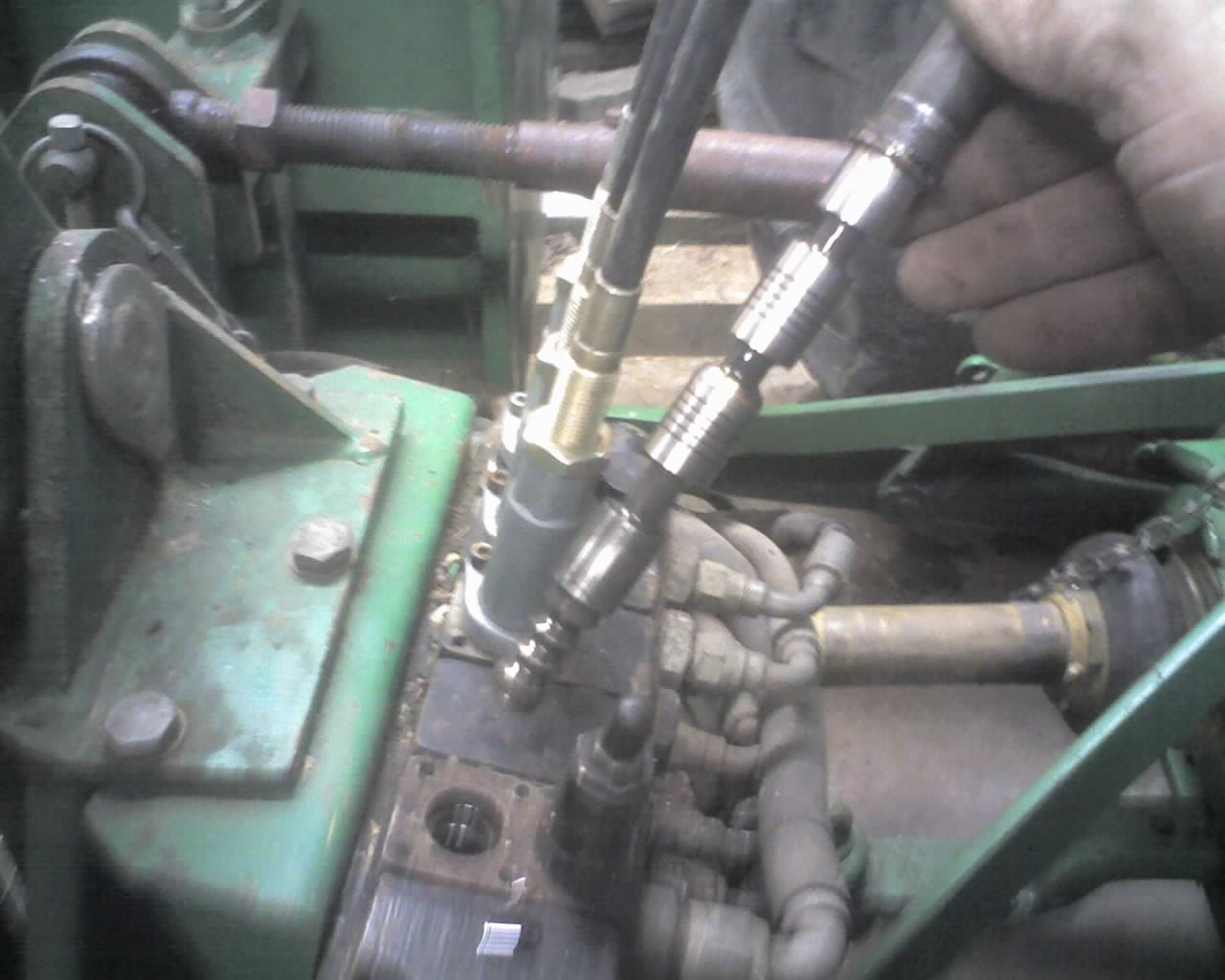

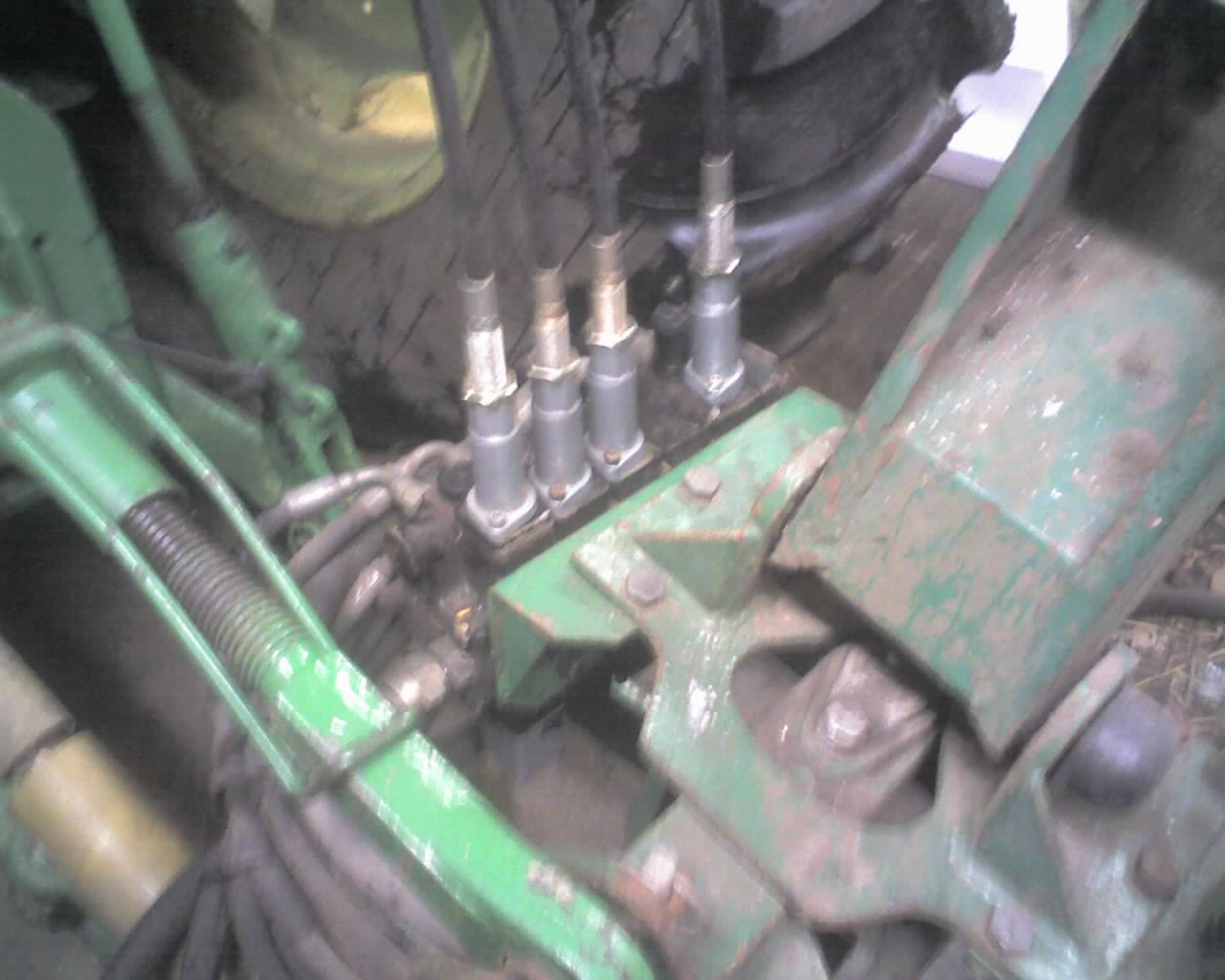

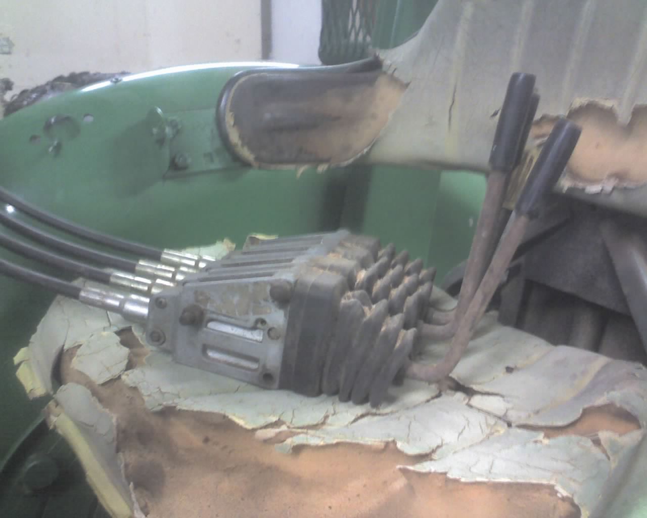

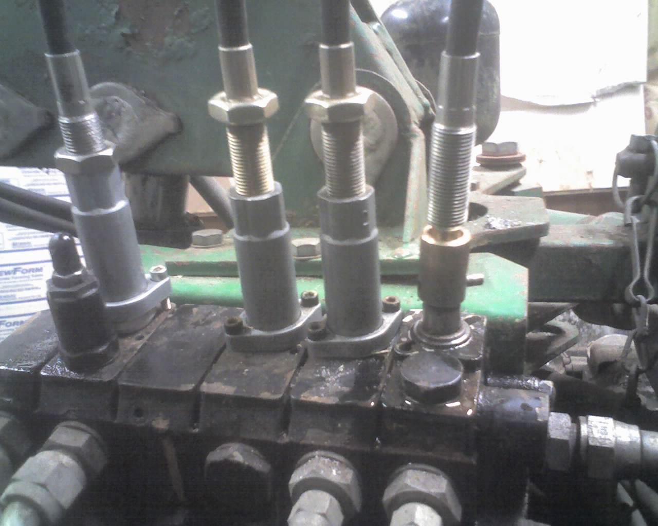

Shortly after I bought my tractor, I bought a used JD Model 90 Boom Flail Mower. The previous owner had bought new control cables for it, but never installed them to the mower. The cables were already connected to the control lever assembly. The control levers move freely when not connected to the mower. Also, I can move the valves on the mower by hand though stiffly. When I connected the control cables to the mower today, the control levers will not move with the exception of one and that one only in one direction. I'm guessing that something I did while connecting them was not correct. Anyone have any suggestions or advice for how to connect them properly?
I'll be taking them back loose tomorrow and will test operation of the mower without the cables connected. When I tested it today the mower head ran and could not be shut off as the control cable would not move. I'll also take more pictures tomorrow while it is apart.
Thanks in advance for any assistance.

You will probably need to adjust each cable length-one at a time to ensure the valve is centering and you have full flow in each direction. It's gonna be a PITI I bet...

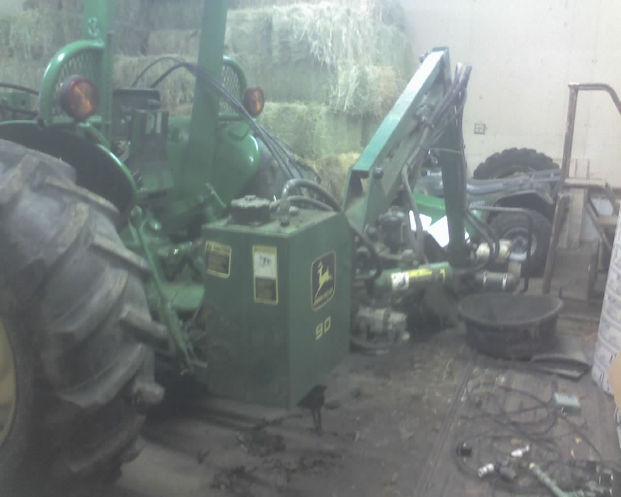

I would love to see pictures of that whole rig when you get time?

I'll get what pics I can for now, but it's sitting pretty tight in the back of the barn. Once I can get it working so that I can move it I should be able to get some good pics.
The thing I'm happiest about right now is that it ran, so once I get the controls working I should be able to mow with it.

No hurry! I assume it has a AUX hydraulic tank also?

OK, got the best pic I could for now for you Kenny.

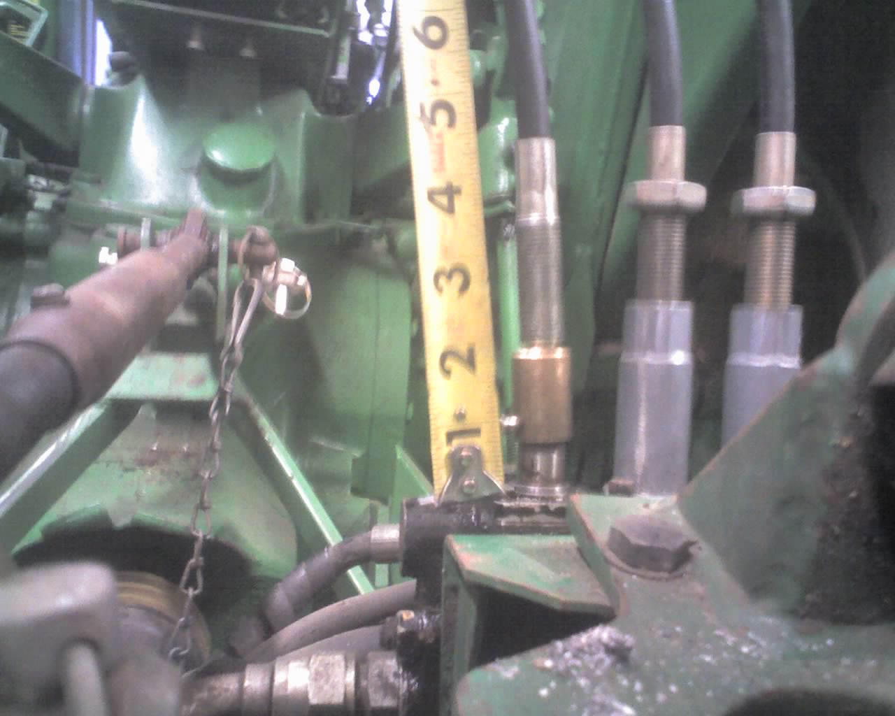

I have my problem identified now. When I install the cables, the outer piece which connects to the valve and the cable slides in, seams to be too short. Once it is turned down to connect it, it has the valve slightly depressed from neutral and has no ability left to lift on the valve (see pix).
Ideas for a solution? Do these come in different lengths?

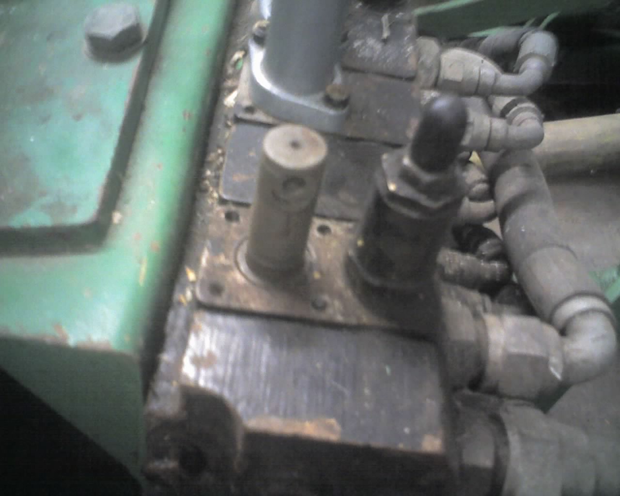

Also, when I disconnected the cable from the valve for the drive motor, I found that the spool will simply lift out of the valve. Is this normal?

However other thoughts I have include making sure the cables are not kinked or bound up in some way and that the bends in the cables be as gentle as possible. Although you mention the cables move freely when not connected to the valves, I'm wondering if some sort of cable lube should be shot into the space between the cable and the sleeve. Given that the mower was used and you live in a humid climate, they may need some additional lubrication.

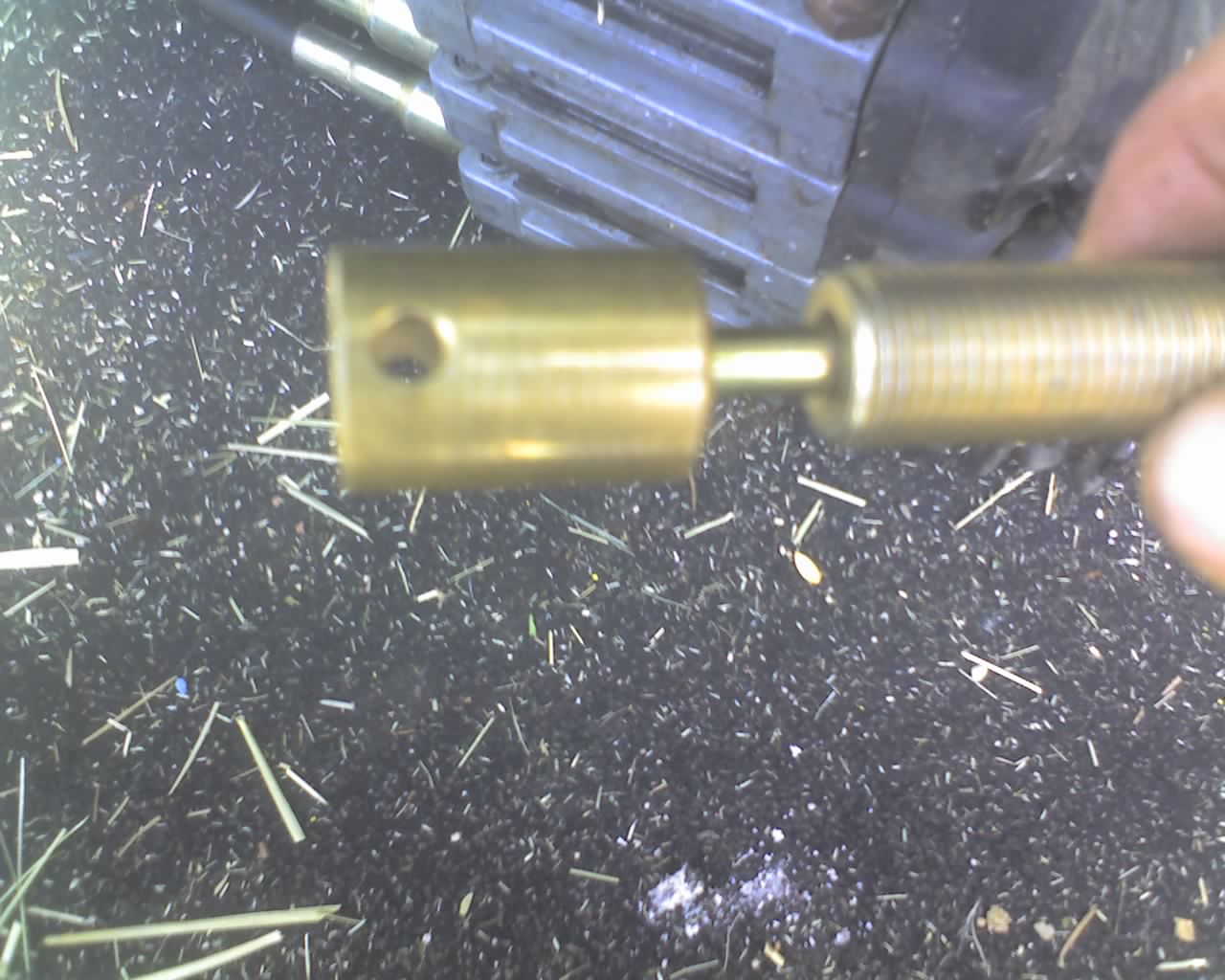

The cables are new and were provided by the previous owner, but never installed. I hate trying to reassemble something I've never seen and someone else took apart. I think the problem lies in the silver collar piece which attaches the cable to the valve. If you look at this pic, the silver colored collar which attaches to the valve is over the brass colored piece which connects to the valve spool. The silver piece necks down inside and stops the upward movement of the brass colored piece at that point. The valve on the right is in the neutral position and the brass colored piece is as high as where the silver collar necks down. To me, it seams like the silver collar is too short.
Other opinions?
I think that's the only way you can connect the cable to the valve spool....so I think thats "normal"....

Just a thought Cyril, and maybe a lot of work?
I know you are pretty handy though. You could make a 2 piece extension that clamps onto your valve base on one end, and has a thread (same as the adjustment thread on the cable). You can turn it up in the lathe but leave 2 "ears" or a larger diameter on the piece. Make it out of something easy to machine like Aluminum. Plan on slicing it in half (after all the work is done) so you can clamp it back on. You would drill and tap the ears. One half of the ear would have the tapped portion and the other half of the ear a clearance for a cap screw. When you clamp the piece onto the base, it would be tight, and the threaded part should be the right thread. There would be enough thread to screw in the adjusting thread on the cable, but it would be a 2-piece thread. You might think about sealing it once attached.
The way I have been attaching and removing the cables is as follows. (Don't know if this is right or wrong). I unscrew the jam nut and alluminum collar and slide them up the cable so that I can get to the brass piece. There is a pin which connects the brass piece to the spool. (You can see it sticking out on the valve on the right in this pic.) Then, with the valve in neutral, I slide the collar dowm and thread it on until it just touches the valve body and install the two screws which hold it to the valve body.

I'll remove the control assembly today and take some more pix of how it was when I received it.
I think this is how to adjust to spools to center......

It took all day, but most of the problems have been identified and confirmed.
When the valve is in neutral, with the cable attached, the top of the brass piece on the end of the cable is 2" above the valve body. This piece, when retracted into the alluminum collar, stops at the threads in the collar. The distance from the end of the collar to the threads is 2". Therefore the valve can be depressed but not raised with the collar attached. The valves have 1/2" of movement possible whthout the cable attached. I robbed a shim from the top of the motor spool valve which is 1/2" thick and installed it between the valve body and the alluminum collar on the other valves. With this shim installed, each of the other three valves operated normally. I did however discover that if I do not clamp down the top pieces of the first valve, that it blows hydraulic fluid everywhere. What a mess. Oh well, the fluid was milky and needs changed anyway. My conclusion for these three valves is that the alluminum collar is 1/2" too short. Also the parts manual shows these three valves using the same cable by part number. For these valves, lift/ extend/ and mower head angle, I will either need to find longer collars or procure 1/2" shims and use longer screws.
On the motor valve... this is the one which comes out of the valve body.
It would not go down as far as the other valves. I finally removed the end cap on the bottom of the valve and found a ball bearing which I believe is for the detents in the bottom of the cap. I still don't think things are quite right, but for now it will work.
I think there is a ball bearing missing. The parts in order from the cap are as follows: Cap, then there is a spring, then there is a tapered collar. This collar fits over a piece which has two holes (one on each side) in it which the ball bearing will just fit into. Above this are a flat washer looking piece which sits against the bottom of the valve body and then a small collar which fits into the valve body to retain the lower O-ring. I don't feel the detents when moving the valve spool and I think that with only one ball bearing, the tapered collar can move sideways instead of having to lower and depress the spring. I'm not sure how to identify and order the correct ball bearing as there in no breakdown of the valve body in the parts manual. Just a part number for the body and one for the cap. The valve stem is now at the same height as the others though.
