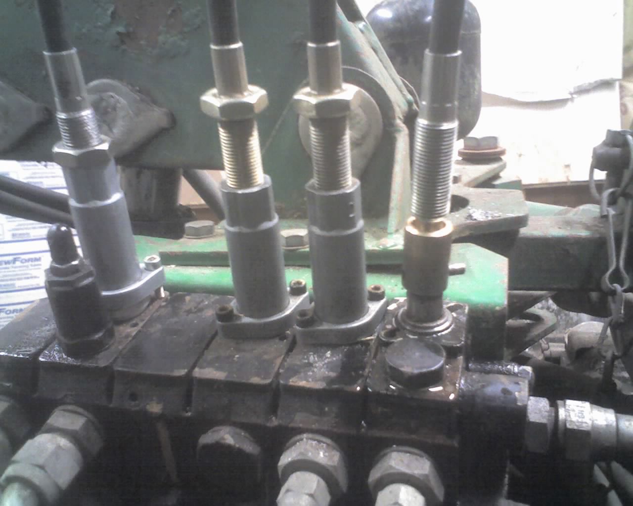

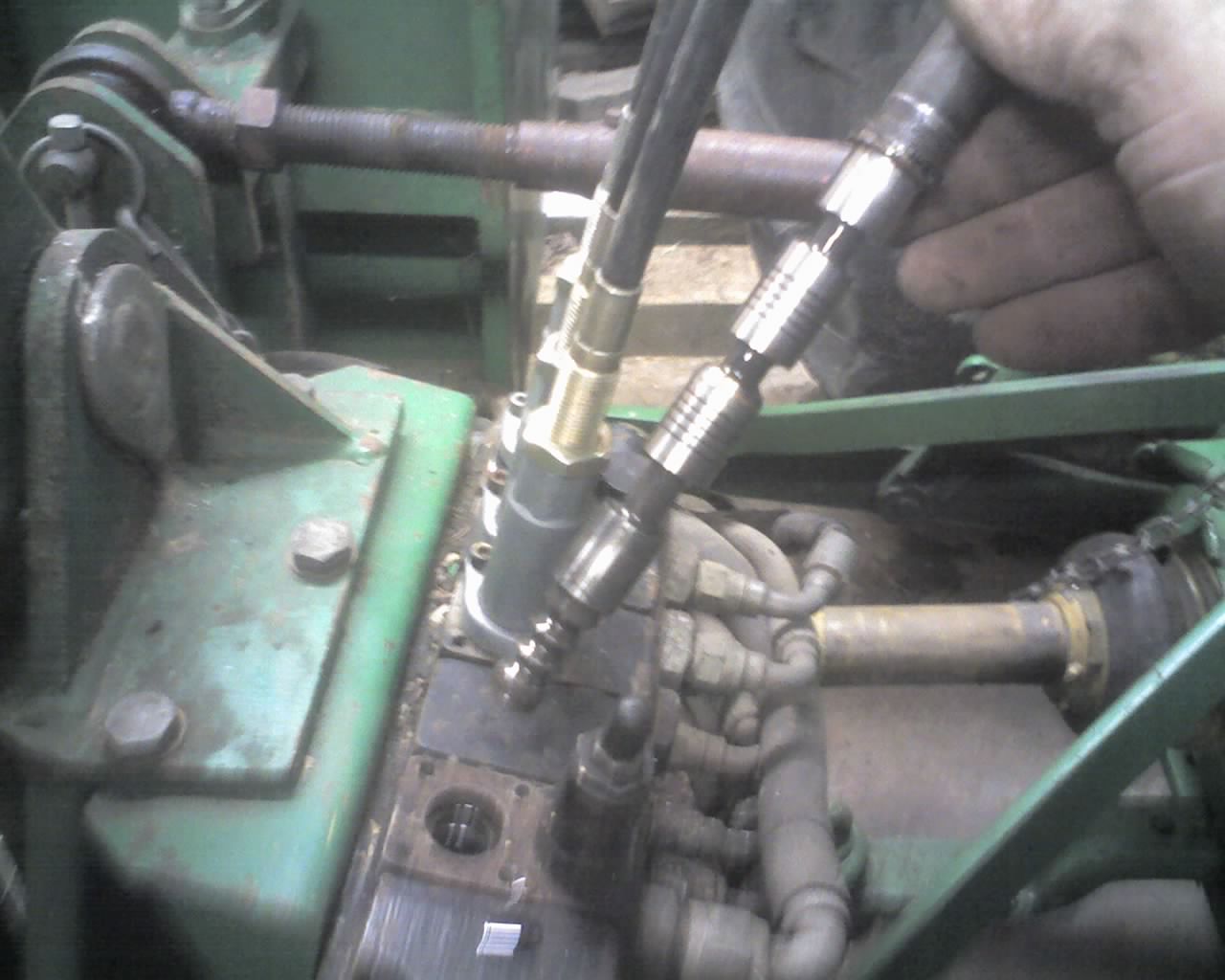

Today went better than I expected. I figured out how to disassemble the cable and get the collar off. First I had to disassemble the control housing (pic #1). Then remove it from the housing (pic #2). Then I could slide the jacket of the cable far enough to see the hexed portion of the cable to unscrew the spool stop from the end of the cable (pic #3). After the spool stop was removed it was just a matter of screwing the collar off the end of the cable.
Another issue I have found is that there is greas in the spring centering portion of the control which is probably origionsl and is now just dried gunk. The old dried grease makes the controls very stiff and sticky. How should I go about cleaning this before regreasing? Also, what type and how much grease whould I use?
Pic #4 is of the full opened control handle and pic #5 is of the existing mounting which is on the right fender. I am going to make a bracket to be able to use this to mount the controls in this location.

Are you sure it is grease??? It could be graphite paste too....very common in different types of cables....like parking brakes etc...

No, I'm not sure. I think it is. If you look closely at the first picture above, you can see some of it that is kind of a translucent yellowish color above the spring toward the left. The grease? around the spring is darker (dirtier?). It does look alot like dried grease. It lubricates the nylon? pieces on the shaft where the spring is located. These nylon? pieces are pulled inward to the center when the control lever is actuated and the spring provides pressure to return the lever to neutral when released. One is for each direction the lever is moved. If needed, I can get some clearer pix. All feedback here is appriciated.

I would soak everything in mineral spirits to clean...then pack with new synthetic grease.

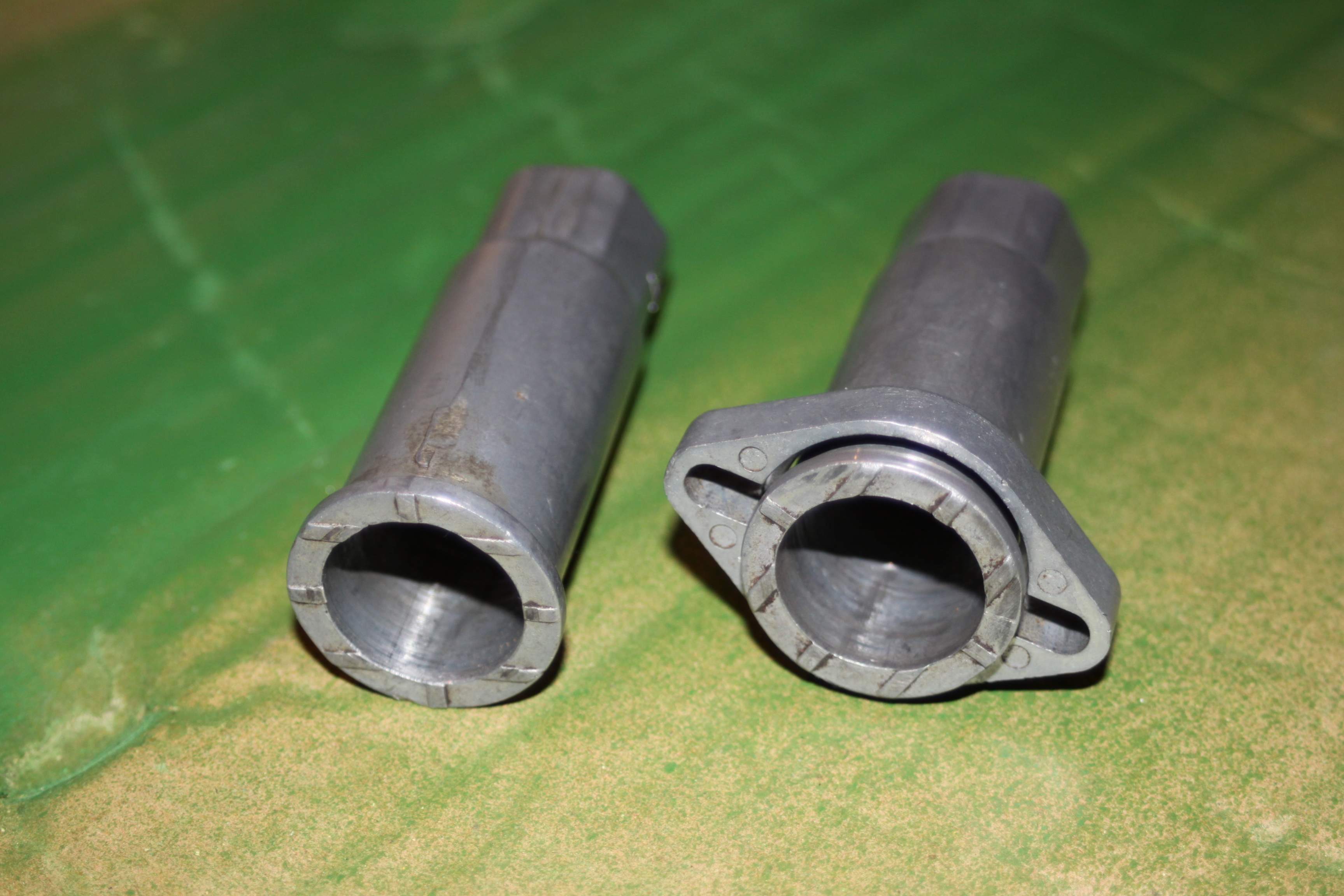

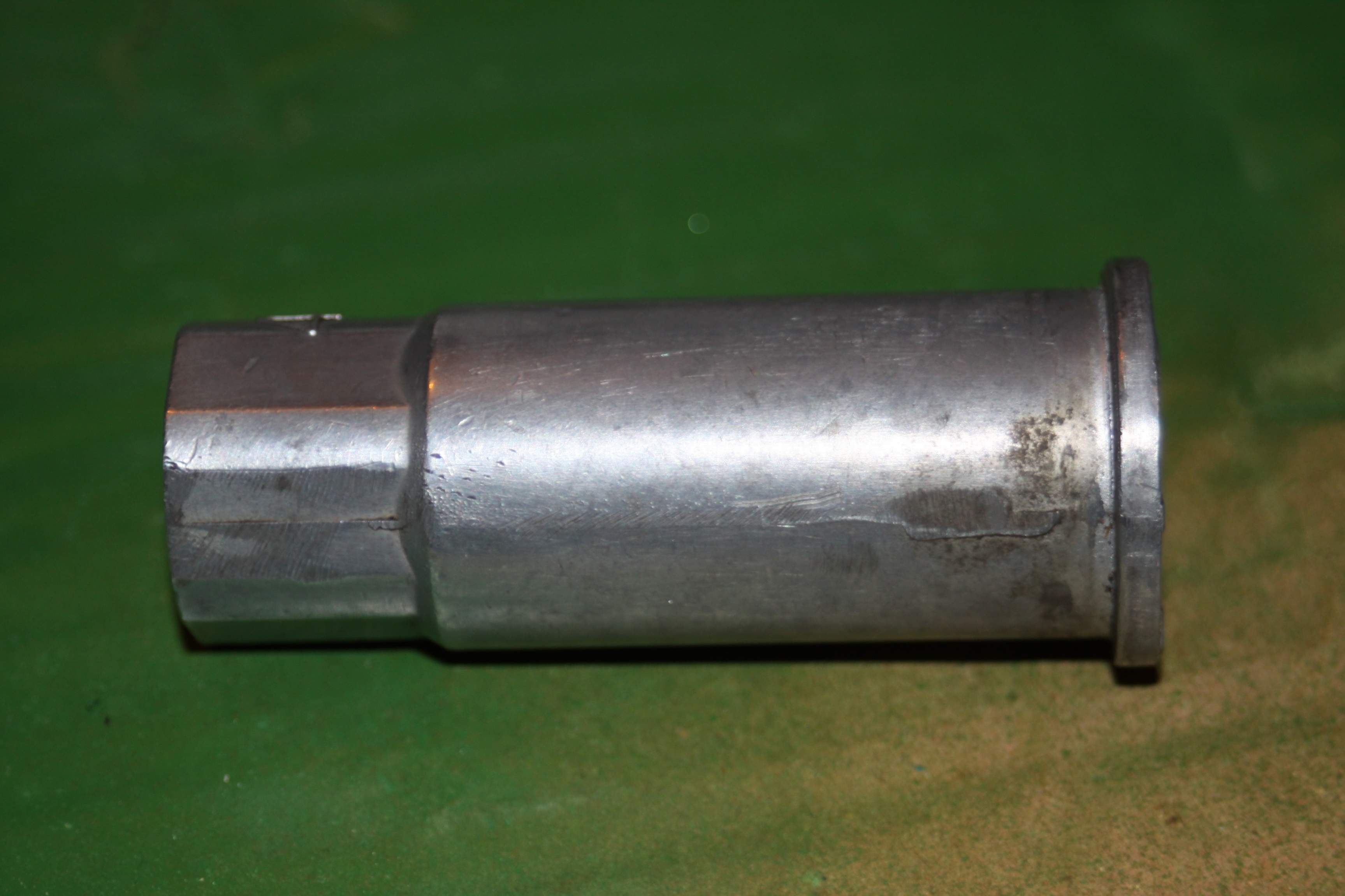

Here are some pix of the origional collars after being removed from the cables. 4shorts, 3rrl, and myself are working on ideas for fabricating new collars in the lengths needed for the cables to operate properly.

I think I managed to track down the current owners of the company who origionally made the control unit. Morse Cable | Control Cables I eventually plan to contact them, but for now, I'm going with the quick fix.
I'm currently working with Rob (3rrl) and we are looking at just making what I need. I sent one of the pieces to him Monday. I should get some feedback from him shortly.

I heard from Rob (3rrl) today. He doesn't think he'll have any problems milling up new collars. The only issue right now is identifing the correct thread. He thinks he'll have the first one done for me to test around the end of next week. Once we confirm that it works correctly, he'll tap the rest and mail them.

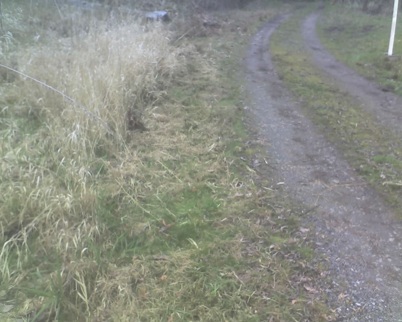

We had an unusually warm and sunny day today. I couldn't resist trying out the mower even though I don't have any controls yet. I operated the valves manually and set the mower to a specific point and started the flail head, then got on the tractor and began mowing. Three passes with the mower set defferently on each pass. Not bad for no controls and old RUSTED knives. Here are a couple pix of the result. The brush was nearly to the wheel track when I started.

That's good that you tested it so you can find out if the mower has other issues besides control cables. From your pictures, I'd say once you get the control cables worked out you'll be good to go.
