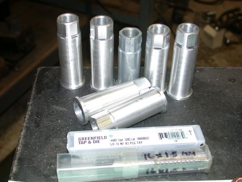

The motor control valve is repaired. Parts...1@ 1/4" bearing, 1@ 1/2" snap ring. Cost...free. One peice of the puzzle complete.
Haven't found a source for cable parts yet, but I'll get there. This should be the easy part once I find a source.
Hi Cyril,
Looks like you found the right source alright?
Here is a photo I took yesterday of your new cable sleeves. The one in the center is the original. The new ones are made of aircraft grade aluminum. Four of the new ones are 1/2" longer and two are 1/4" longer. As soon as you call me to tell which thread it is (either 5/8"-18 or 16x1.5mm) I can finish them up for you and put them in the mail. I have both taps ready to go.

Here ya go Cyril,
After your phone call earlier today, I went to the shop to drill and tap them for the Metric 16x1.5mm threads. They are done and cleaned, and Loretta is putting them in USPS package right now. You should have them by the middle of next week. The stock collar is in the middle of the photo below. I hope you get your mower going soon, and thanks for the fun little project...

No, Thank You Sir...very much. You do beautiful work! :thumbsup:
I understand how a lathe works to mill out the piece and drill and tap it, but I have to ask...
...how did you make the hex top for putting a wrench on it to adjust it? That part has me stumped. :confused:

I think he milled it down a little on a lath (see the stepped edge at the corners of the flats) and then ground flats onto it. Looks like it was factory made. GREAT work.

I thought of that idea, but I think it would be difficult to get the angles and depth right. Different people have different sets of knowledge and experiance. I bet that Rob knows a tool and a means which will allow him to quickly and efficiently get it right every time.

Cyril,
On the lathe I turned the outside and inside diameters and chamfers.
I also turned the (to be threaded) hole for the Metric threads because they are a smaller diameter than the 5/8-18. I figured if I had to enlarge it for the American thread, I would do it later. But if it was the Metric thread, they were done already. After doing all the lathe work, I set up a Harrig #1 Spin Jig on the milling machine. I can index that Jig to any angle I want. I set it to rotate 60 degrees and milled off (side milled) the hex for a metric 22mm wrench equally from each side. I cut the hex back into the chamfer so it would look really good.

Sounds like I was right about it being a trick of the trade. Knowing the right tool to use and how to use it. I've never heard of the Harrig #1 Spin Jig and have no idea what it is, but again, that's why I try to go to someone who knows how to do what needs done. I can do a lot of things, but this one was beyond my experiance base. Thanks again for the help Rob.
