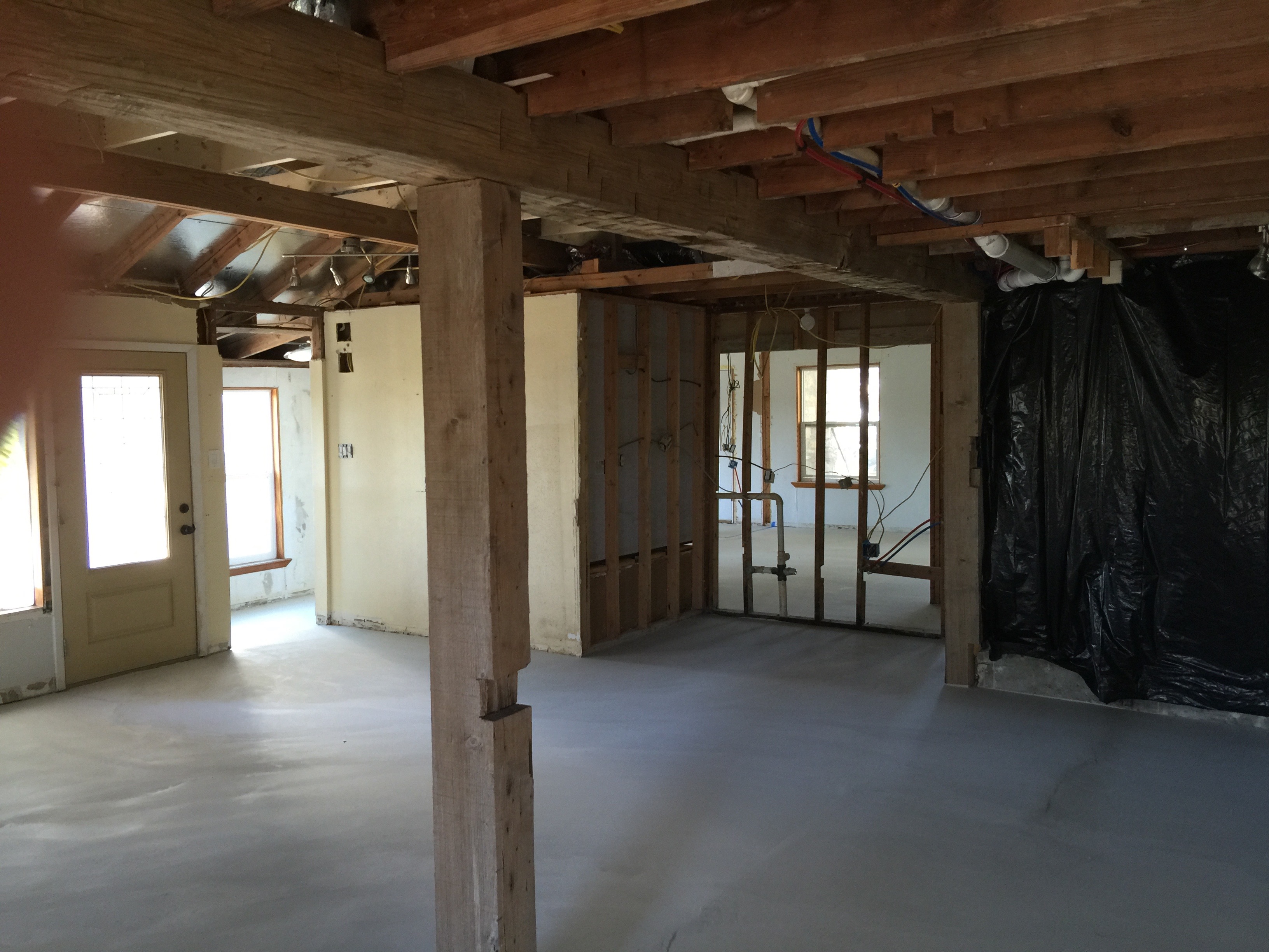

Legit concern and I did bring in a consulting Architect prior to doing all the ceiling work. Due to the size at 1"x12" and that most are on < 16 in centers he was comfortable with the wood removal.
NOTE: The wood removal was already there to begin with and has supported the floor for many many years with zero tile cracking so I am ok with that. I do see the Ditra as a better and lighter weight approach and I think worth my investment. vs the concrete backer board. Bear in mind this bathroom was 9x15, with tile from floor to the 12' ceiling on concrete back board. I just hauled 3000 lbs to the dump and another almost 2000 lbs so there was 5000 lbs in tile, concrete and cabinets and there were no cracks and none of the joists has slipped down...at all.
If you look in the pic to the upper left that was a flat ceiling and I vaulted it.

it certainly sounds like you are trying to do everything right and as best as can be with the conditions you have.....and from the look of the pic's you sent you have your hands full based on the previous construction.........I do question the consulting advice you received though.......all I can say is I hope you got everything in writing from him when he said he was comfortable with it.........the international residential building code which is used for homes in most of the country states that the maximum height of a notch in the bottom of a floor joist can be the depth of the joist divided by 6.....so in your case that would be 12/6 = 2 inches.......just visually those notches look like a lot more then 2 inches in height.......and at only 1" thick those joists just don't have a lot of meat to them.......a plumber with a saw is a very dangerous person on a job site......Jack
I understand. When I stripped out the sheetrock I saw same and inspected it very well for the concerns you state. There was no visible splitting or cracking anywhere to be found. Then the fact that the bathroom did not have a floor but only a subfloor with concrete backer board. This begs the question, why? Well the original floor was taken out, which was wood or so it appears and my guess wood with linoleum. They had to remove it in order to put in backer board and floor tile and I have made 2 trips tot the dump and left almost 5000 lbs of backer board and tile from that bathroom behind. I am only replacing tile in the shower and floor, just using drywall for the rest. My guess is that is a net savings in weight of about 1500 lb+.
In the pic I posted above you will see a beam that supports those joists, that is a Hickory beam 10"x12"x30' that is about 200 years old...me and one other guy installed that, it weighs almost 800 lbs. I removed the supporting wall, which was just a 2x4 build and notched out the joists to fit in the 10" wide beam
This house is built from lumber from the '40's and its completely different from lumber you buy today in both size, its true to size and in the strength of the wood and if it can support not only 5000 lbs of tile, but the entire upstairs along with it and done so for over 50 years I just don't think I have anything to be concerned about.
I just checked in the one spot I have access to a joist, I thought it 1x12, but its not, its 1 ½ x 12...interesting.

I saw that beam.....thats a nice looking piece of wood.....looks hand hewn.....people will pay big bucks for that look.........you are right that the older wood has higher structural values then what we can get today......more then likely those joists were milled from old growth trees hence the higher values.......also the type of wood will make a difference......the older wood dimensions use to be truer to size......so a 2 x 12 measured 2 x 12...then it went down to 1 3/4 .....and then 1 1/2 .....and I've even seen some at 1 3/8.....sign of the times......the one thing that has gotten better is the connectors we have today......like simpson hangers.....they can really make a difference.......I've had my fair share of older houses and I don't envy you at all......haha......make sure you keep us updated with finished pics.........Jack

Thanks Jack. As for hangers, those joists are free, they just sit atop the Hickory beam (yes its hand hewn with wooden dowels, no iron) by weight alone. I did pre-load. When I installed the beam I jacked up the top floor under it and then cut my 3 vertical supports to an exact fit, the sit the beam on them. The 3 verticals are old cedar that came out from under a very old hunting cabin on the ranch. It was a 24 foot center joist that supported the cabin. The beam and the verticals are all free, not nailed or affixed to the house other than weight bearing.
