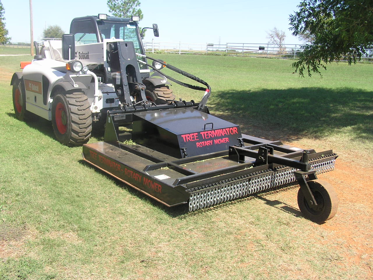

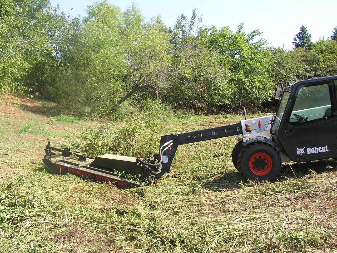

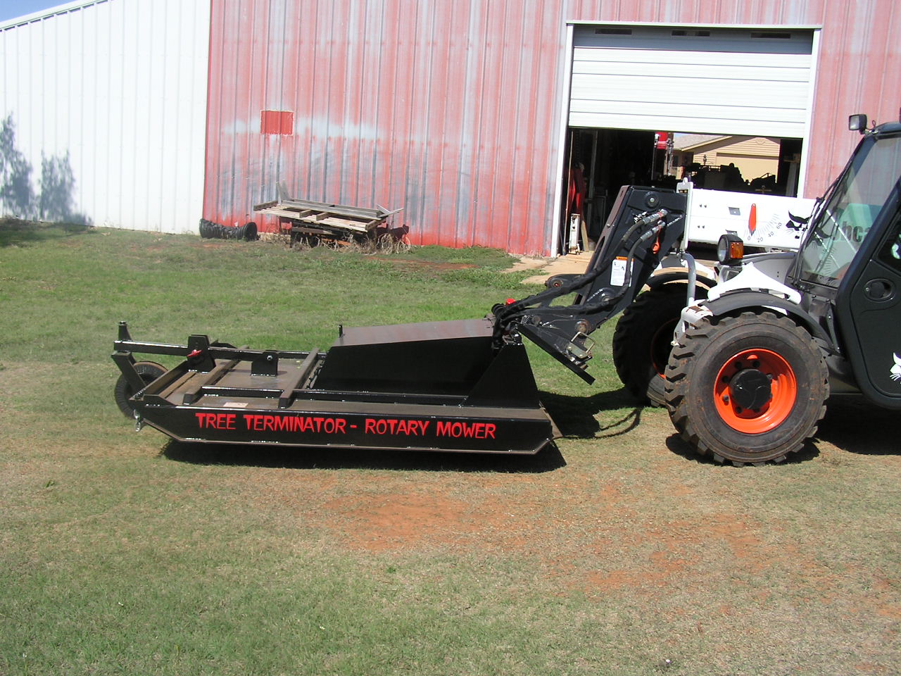

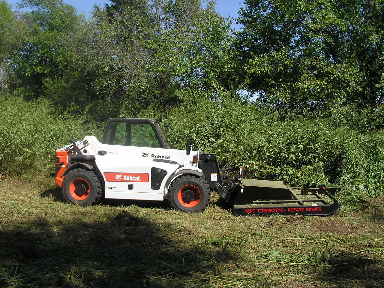

Since you mentioned bush hogging, This is the 7' rotary mower that I use. Out front where you can see what you are cutting!:D
View attachment 323078 View attachment 323079 View attachment 323080 View attachment 323081
The V417 is a 2009 model, was a demo with 44 hours, paid $52,000, delivered, in September, 2010. It has about 630 hours now.
But you get what you pay for, this machine will lift over 5,000 pounds 17 feet high, push or pull its self out of any stuck in the mud situation and does everything I would need a tractor for. I have owned several tractors during my 73 years, so I have a good basis of comparison.
Is that mower hydraulically driven instead of PTO driven? From the pics, I can't figure out what powers it. It wins the "cool" award, for sure. Very nice. Sure would be handy for mowing ditches and embankments.
