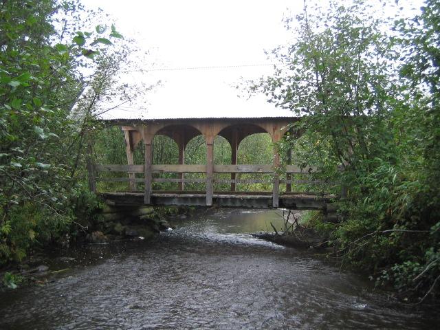

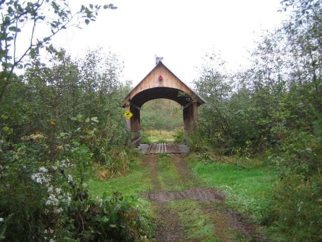

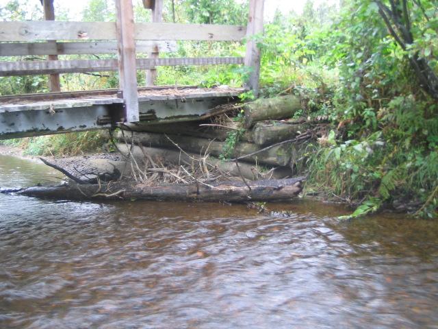

deanfitz, Here's some pics of my covered bridge. 24' span w/ 4-14" beams. I got the beams spec'd by the engineer at a steel fab company I used to subcontract erection jobs for. asked for 10K lb live load. They spec'd 12" but had used 14" at 1/2 the price of new 12". Cross with DK45S & Silverado 2500 HD without noticable deflection, tremor, etc. Planked with 10' x 2x8" rough hemlock. Four 5/16" carridge bolts per plank/ one per beam. Wanted to close the sides in to waist level but sometimes get up to 12" water over the deck in high water, don't want it swept away. Pair of beams on each side tied togeather at 12" OC with three 8" beam daphrams & 3 more between center beams about 48" long. Covered the bridge to extend deck life & cause it's kind of neat. The lengthwise pieces are just 1x3 strapping to keep snowmobile track picks & carbide runners from sawing the planks in half. MikeD74T
