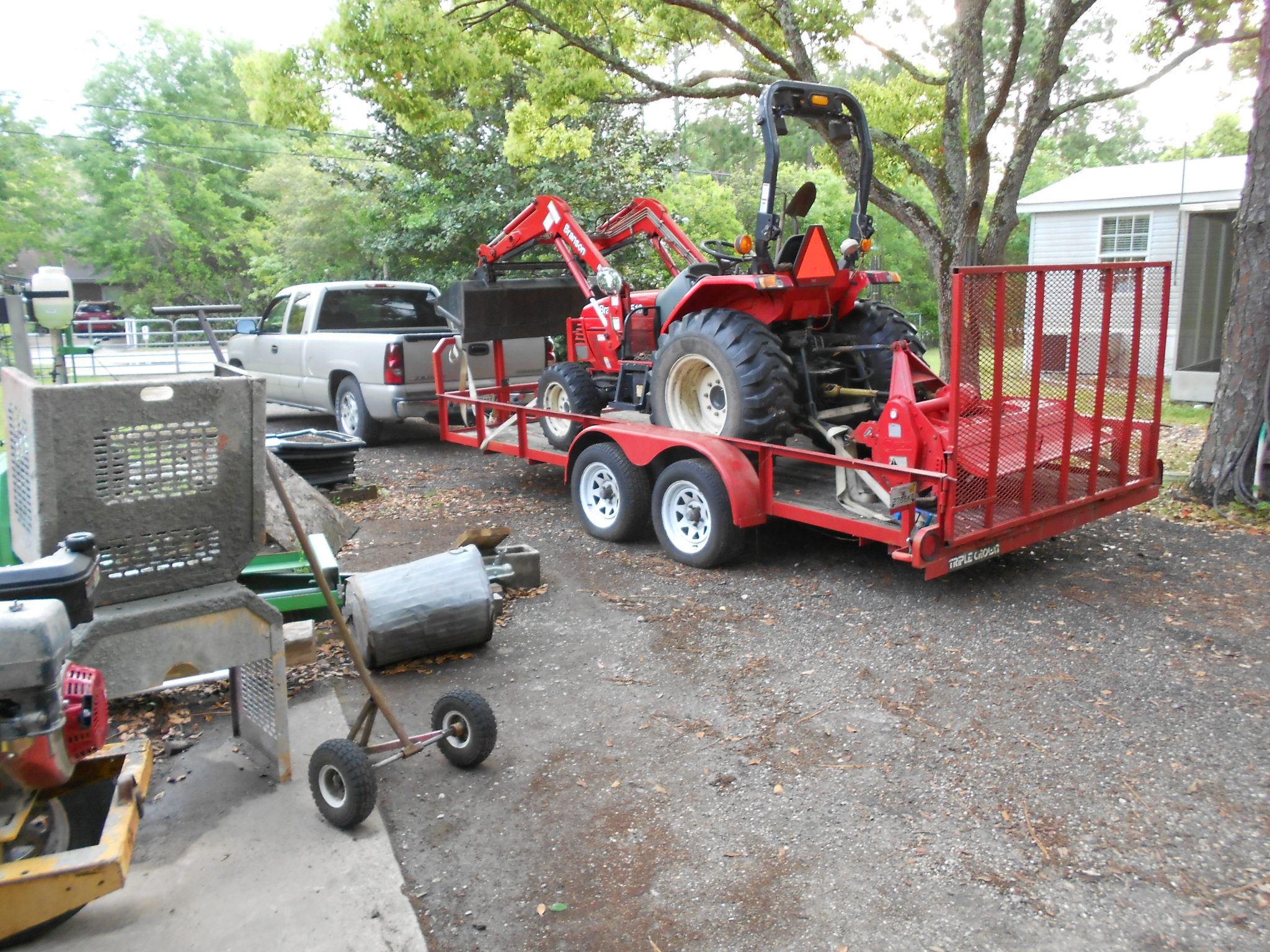

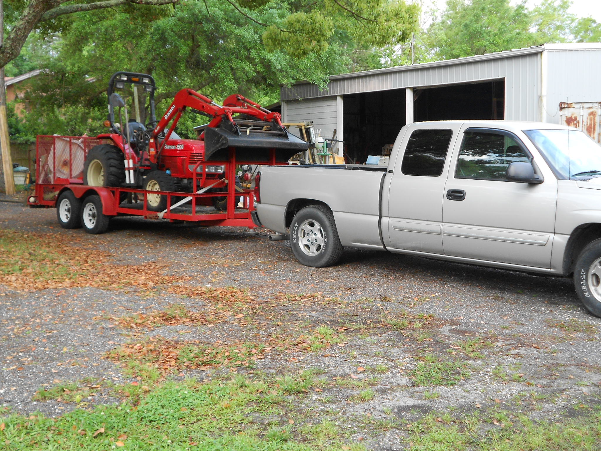

I haul my Branson 3510 on my 16' 7000# trailer.
Here it is with tiller and FEL on.
I built the Bulkhead on the front for hauling things like fridges that are tall and it works great for the bucket.
I do have electric brakes on the trailer and they worth every penny!

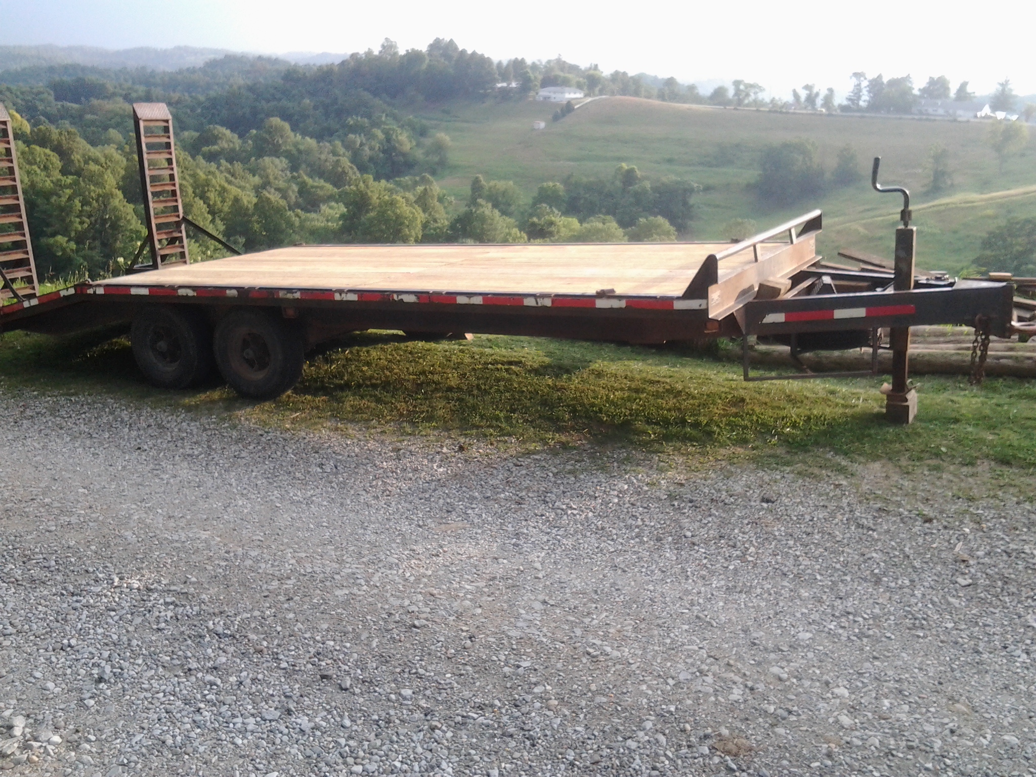

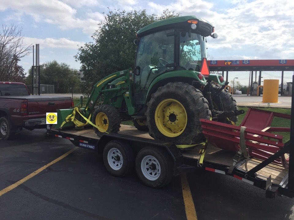

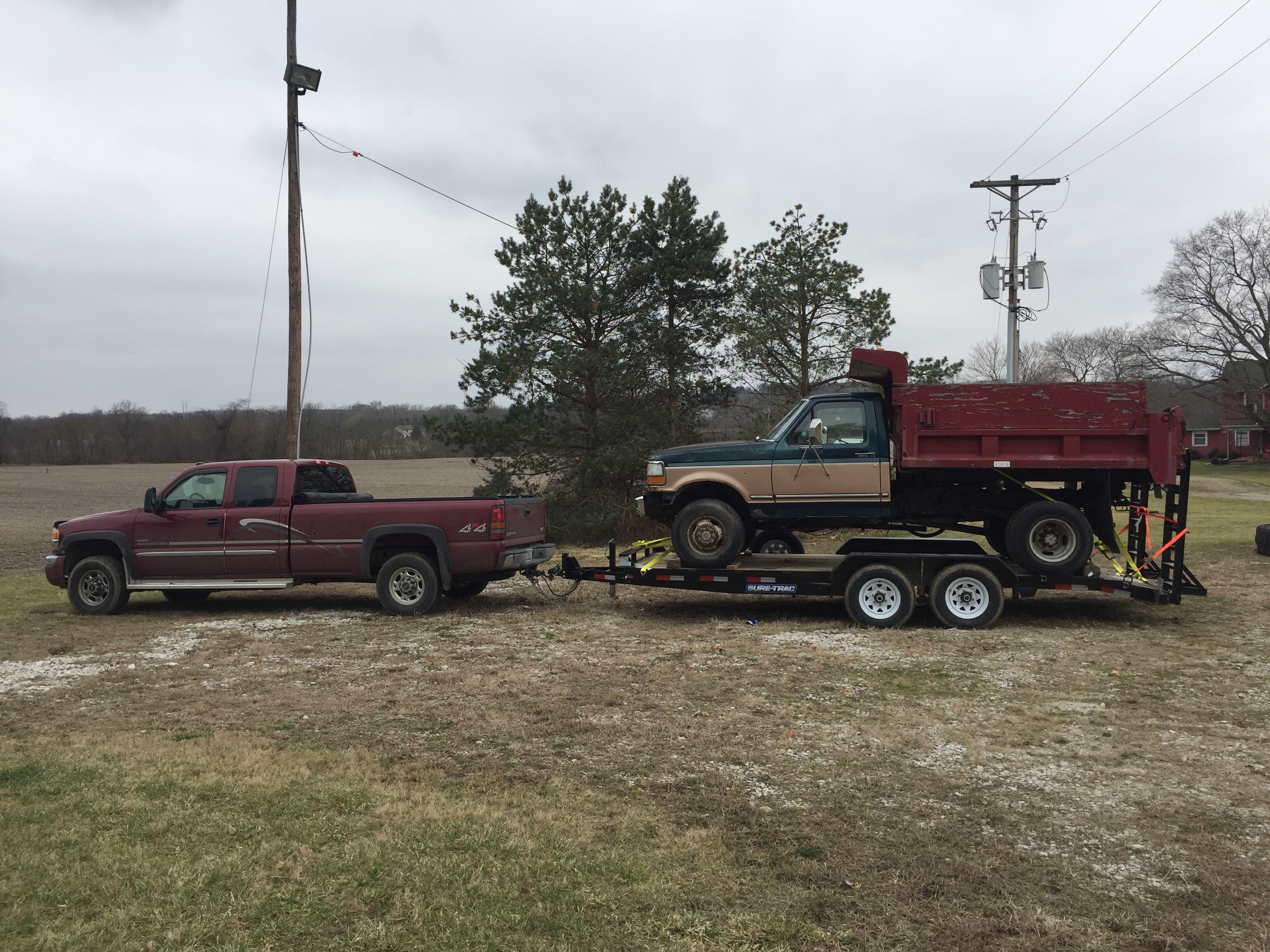

Everyone's needs differ... but mine are well covered by this 20' (16'+4' dove) deck over. Rated at 9990 lbs, it has illegally handled loads 3k lbs over that. My JD 3005, with loader and 5' brush hog fits, with the tail wheel sticking out the back about as far as the ramp legs do when on the up/travel position. I prefer deck over, fenders would get in my way for other purposes. I'll take slightly higher Center of gravity over fenders in the way for side loading.
You're hanging the FEL over the front end of the trailer, and you're barely fitting the tiller on the back of the deck. The OP wants to haul his with a rear 3pt mower on it, which will stick off the back end of the tractor a considerable ways farther. 16' is too short for what he wants. 18' minimum, and actually a 20' would be more versatile.

That's what makes my 20' deck over work for me... 3 vehicles that are 3/4 or one ton, diesel powered, and capable of towing it for any one of many uses. What works for me, may not for others.

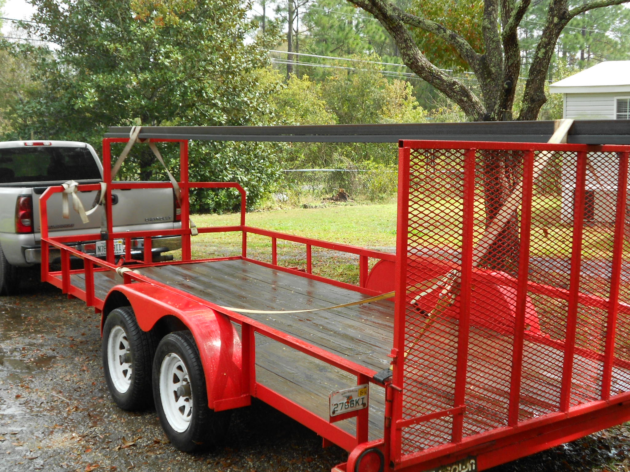

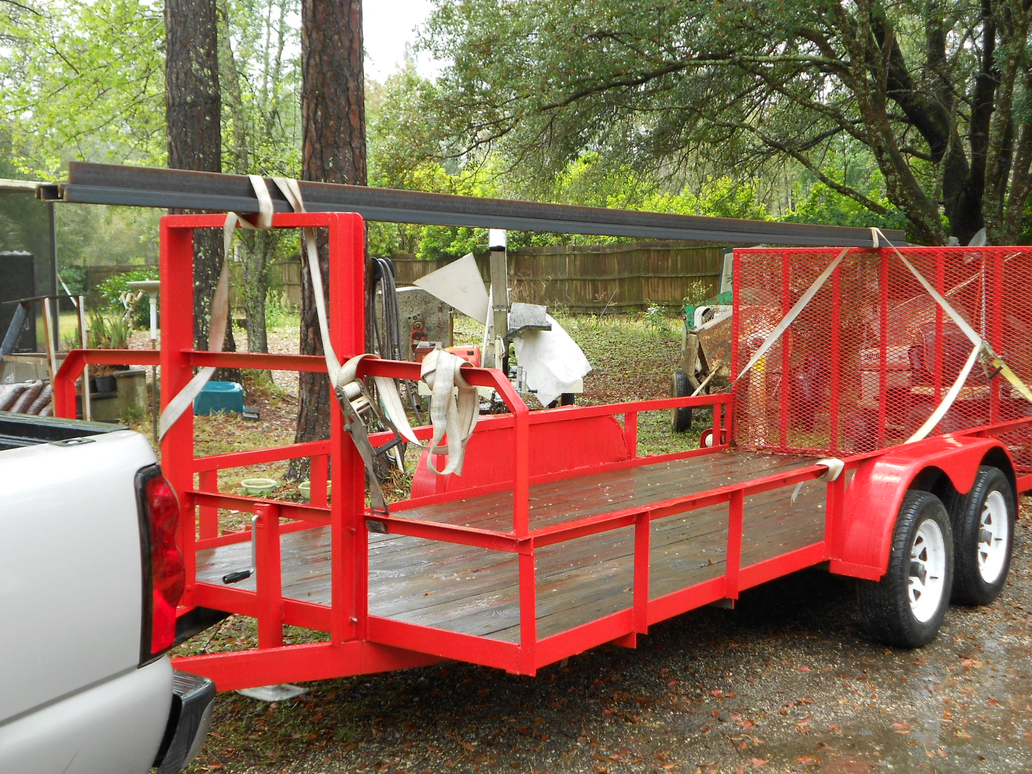

When I need to haul longer items I can do it on top of the bulkhead and tailgate.
Have had about 2000 lbs of steel up there and 27' of 2" X 2" aluminum tubing when I built my screen room!

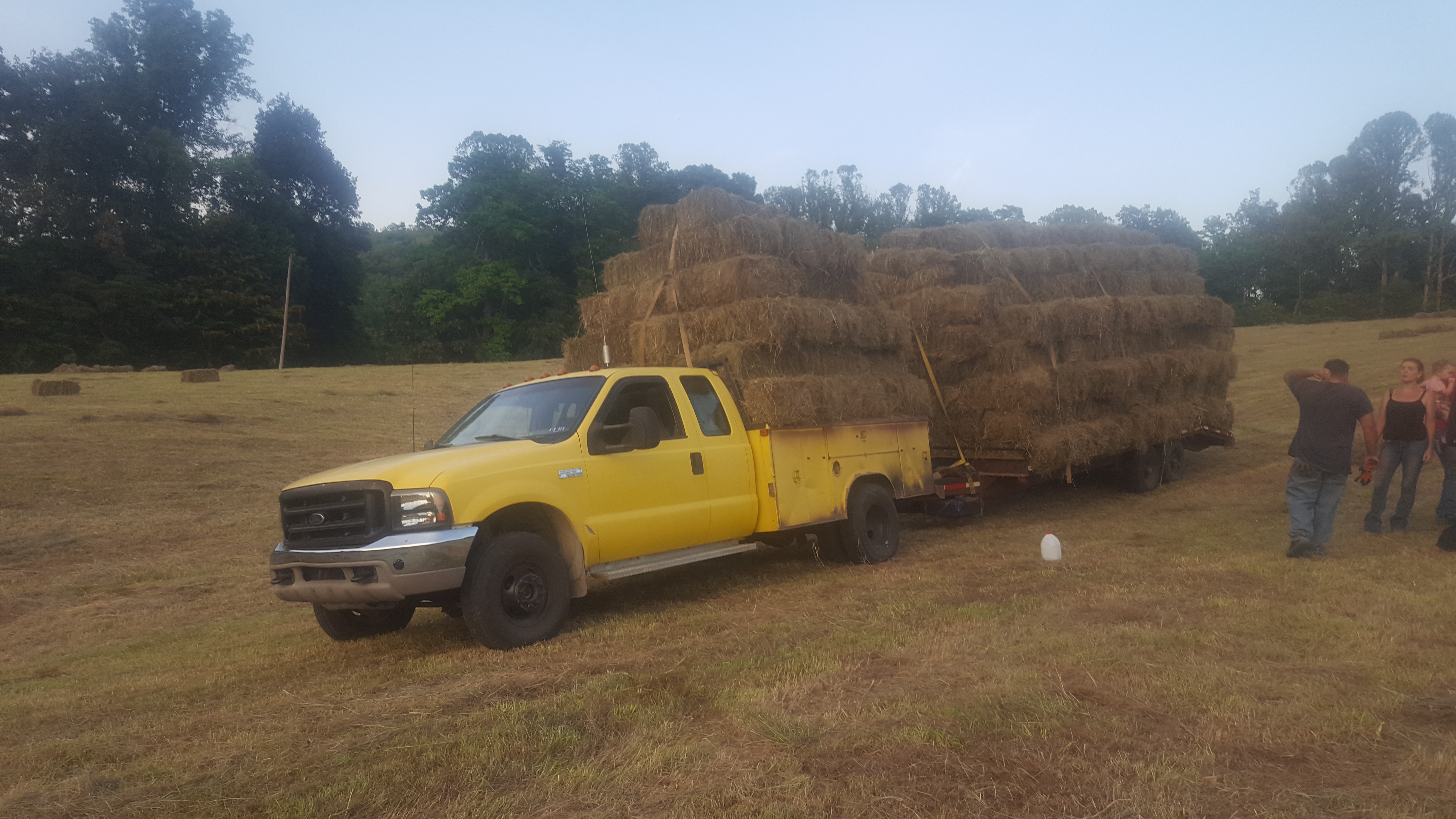

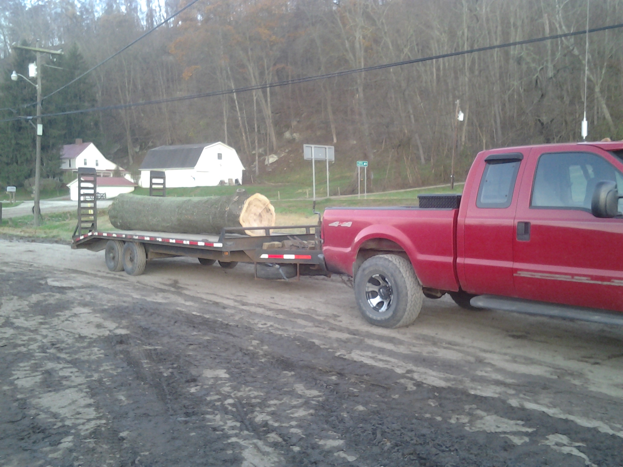

I have found a lot of times it's better to get by with what you have then spend big bucks to upgrade. I do it all the time now lol. IMG_6887.JPG
There's tons of stuff I would like to have but find myself putting off to pay down other things. I'm still hauling with my 81 F150, I finally decided to just keep it so I bought a class 5 receiver for it, am gonna wire it for a brake controller and the 7 and 4 pin trailer hook ups. I deff don't win speed records with the old girl but she gets the job done. IMG_7247.JPGIMG_6924.JPGIMG_6730.JPGIMG_7440.JPGIMG_6519.JPG
My motto is "I can't buy everything all at once" I'm always legal weight wise but sometimes unconventional.
