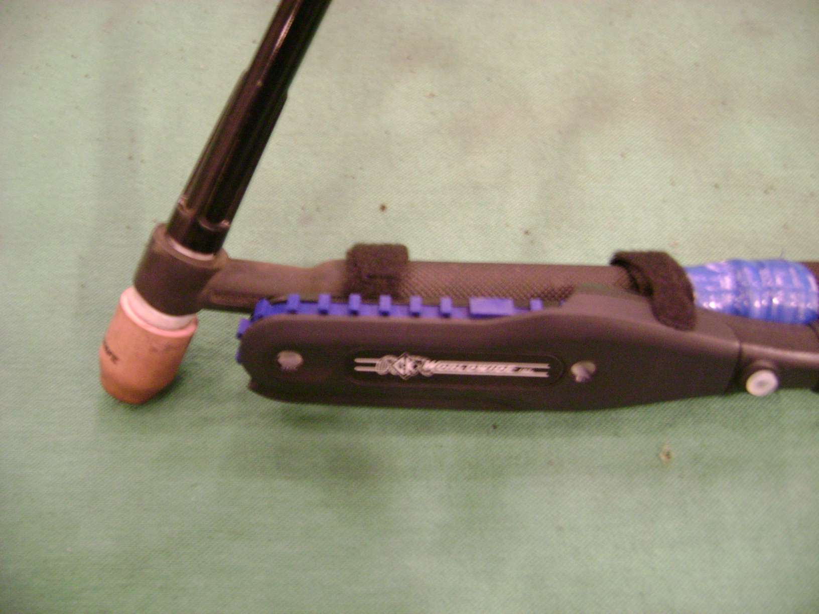

WHy not get a torch with built in slide amperage control? Alot cheeper than a pedel...
That's a good idea kid! See that's why we keep you around.:thumbsup:
I like my CK north south.

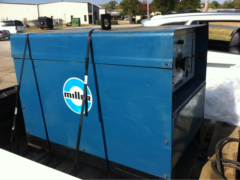

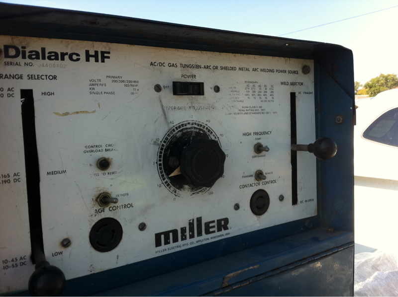

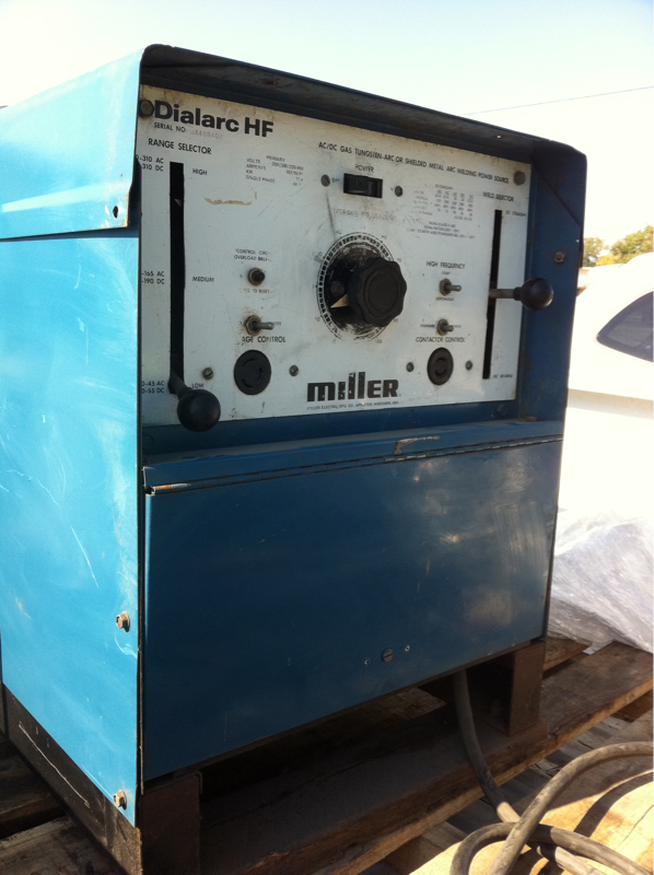

The big truck just showed up this morning! Here's a couple pics. I want to put new 50' leads on it. The ground is missing and the other lead is pretty short. It looks to be in good shape though for the most part. I thought about dropping it at the miller dealer and letting them go through it but not sure if it's worth it.

   / Need welder advice... #54
Take her for a test drive first, why spend money if you don't have to!

I'm not familiar with that machine at all. You can go to the Miller site and down load the manual for it. You'll need the serial number.
When I had my Miller 330A/BP in the shop I wired it direct to the breaker. But it drew 100-amps, at max output.
Miller - Owners Manuals
