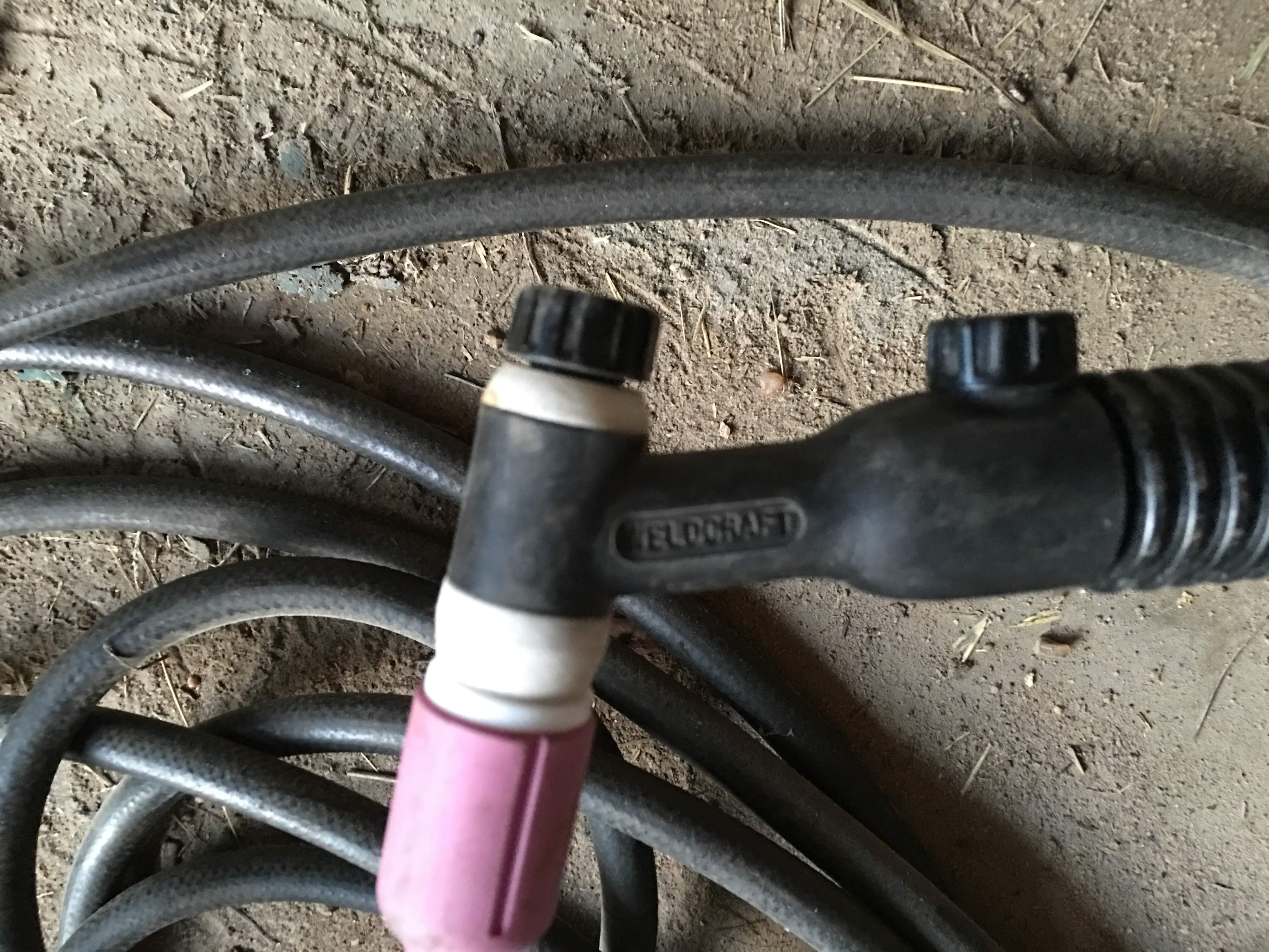

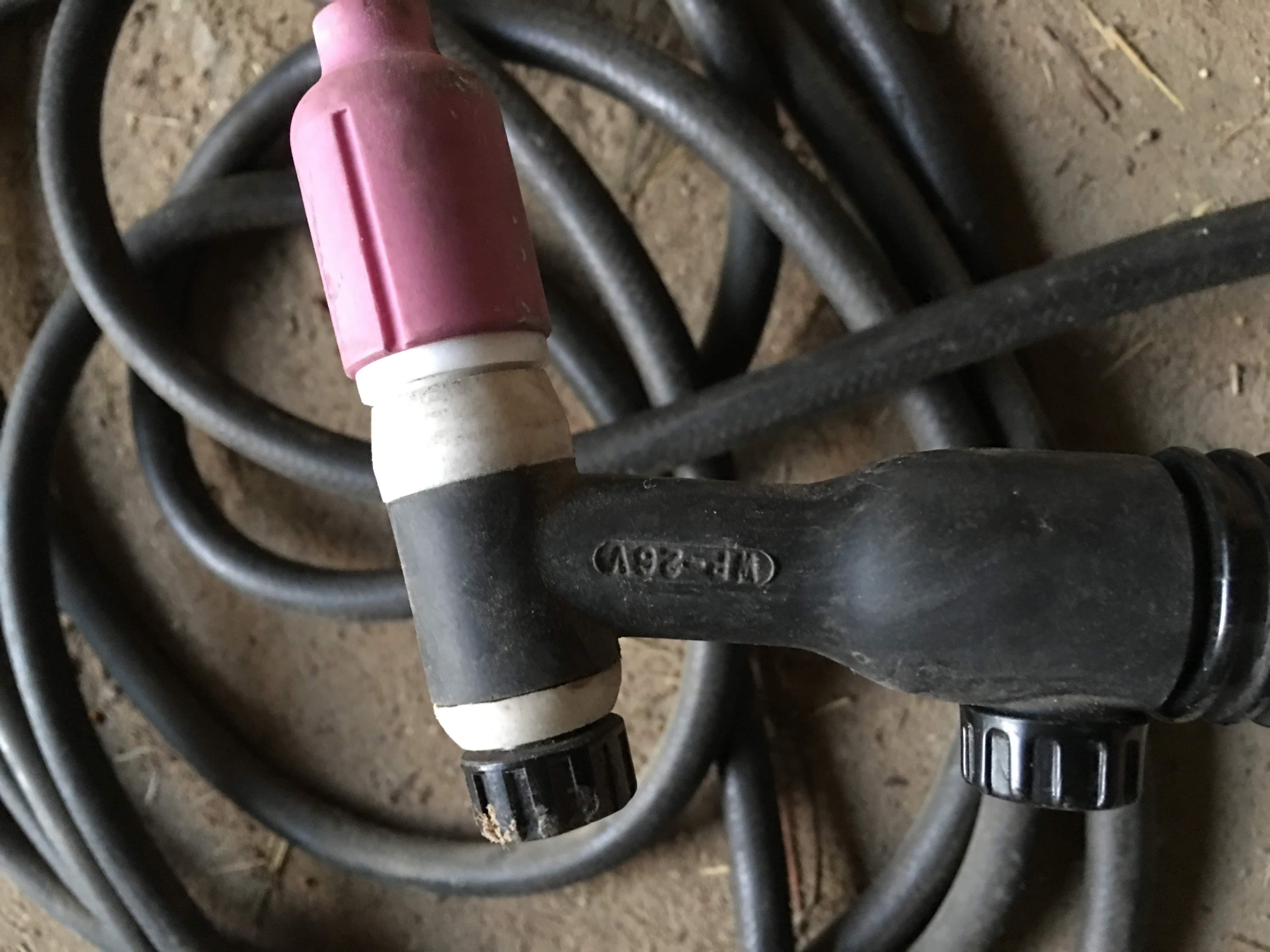

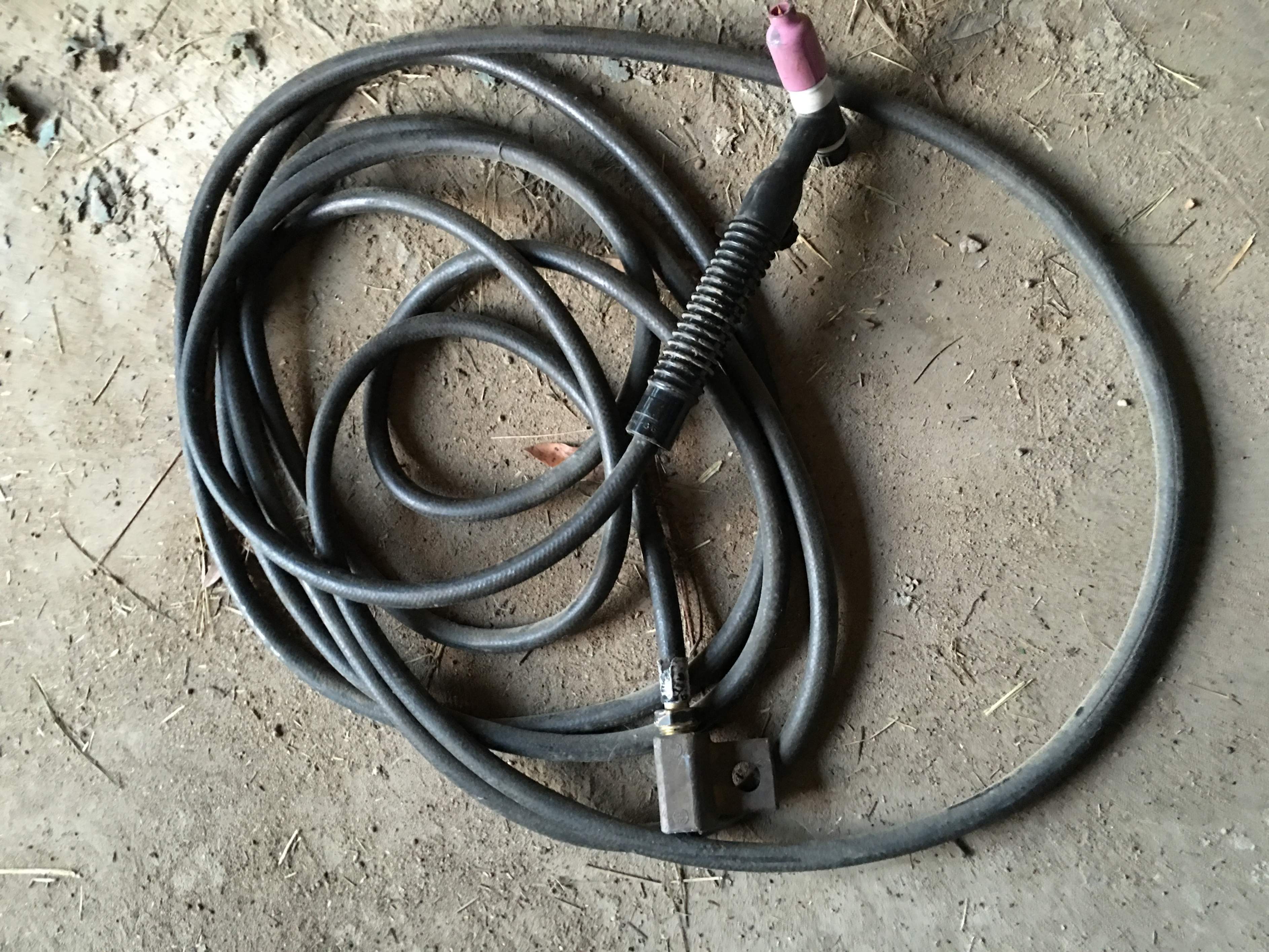

Ok so I got the pedal on the way, has been tested and looks to be in great shape. Also a friend gave me this torch awhile back, wp-26 I think it says. Is this ok to start with or even compatible with the Dialarc? image.jpgimage.jpgimage.jpg

I am looking for a RFC23A foot pedal also. I passed on the one you bought when it was $120.00. The ad read untested and the wires were beat up leaving the pedal. He had been trying to sell that pedal for some time. If it needs parts you can get them from Miller, Good luck though

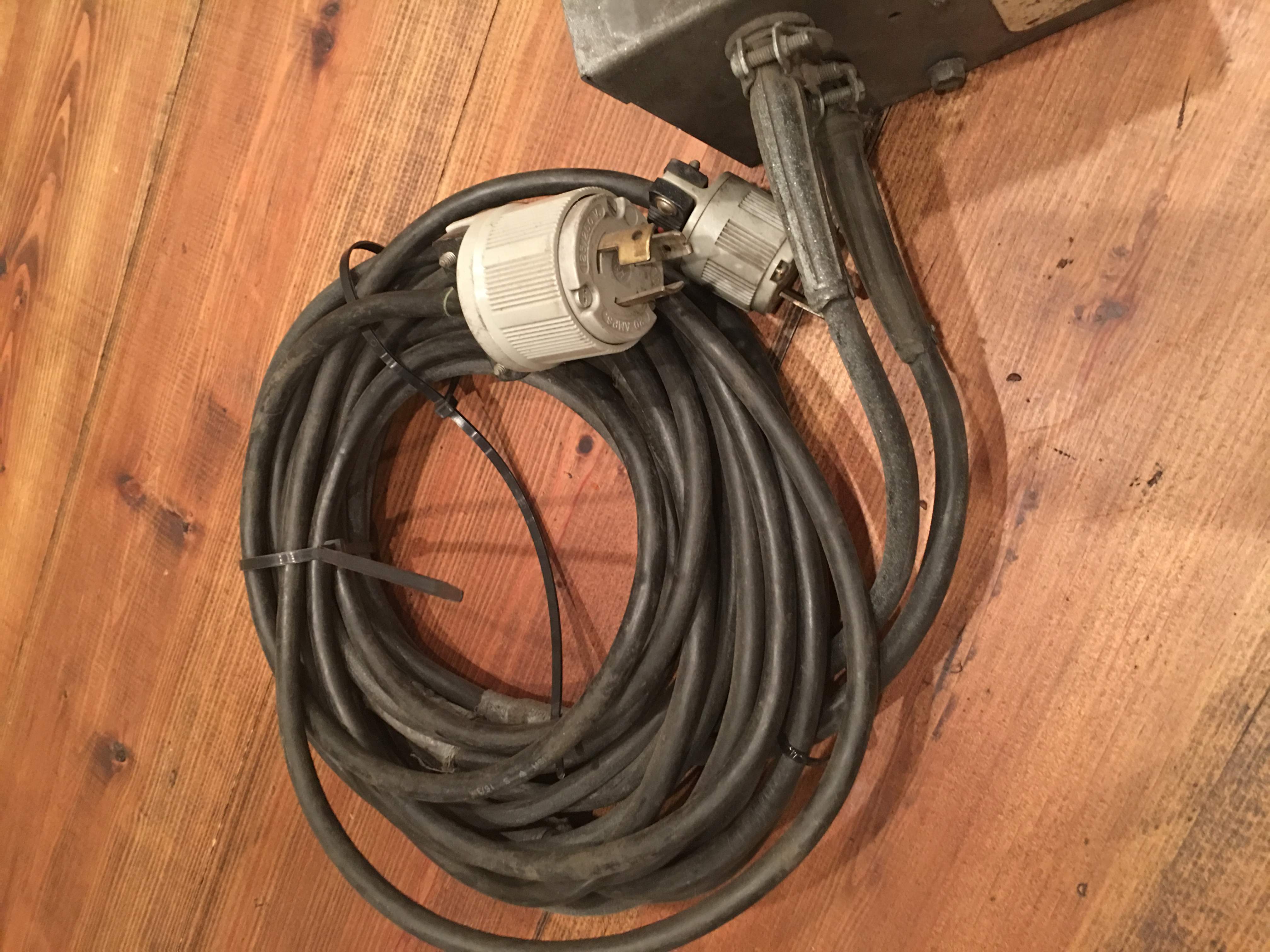

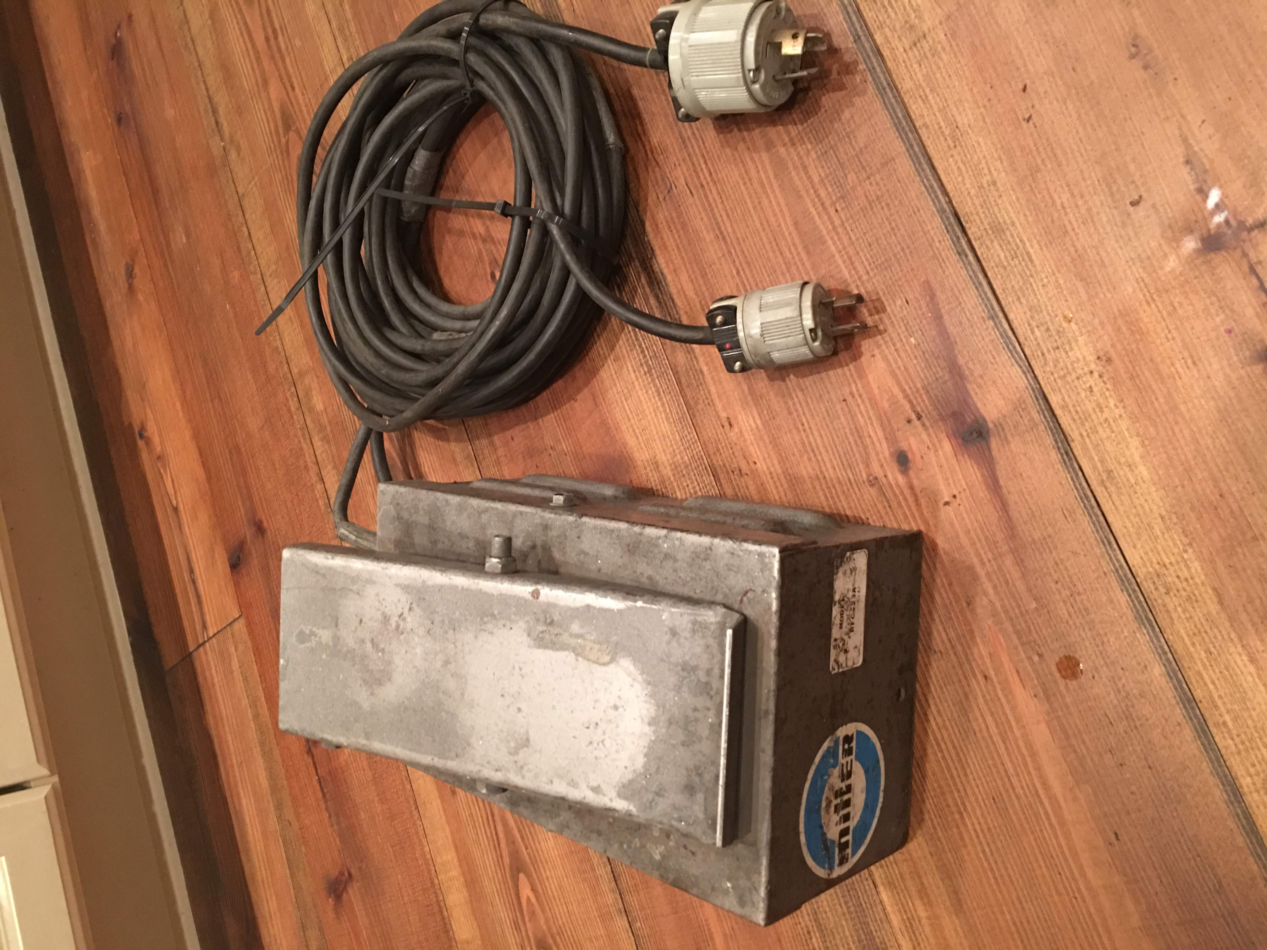

Well whadya know my pedal came in today! I checked the tracking number and yup it was sitting out in the yard. That was really quick shipping. It looks to be all there, a little paint worn off but the plugs look right and the pedal moves really smoothly. A bit too late for me to go try it out though I'm tempted lol. Got an early morning hunt anyway.
Here's a couple pics,

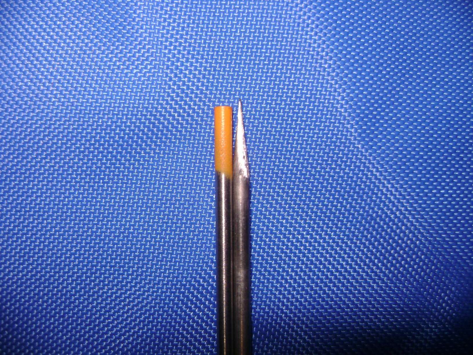

Can anyone recommend which tungsten electrode type I should try? I've read somewhere they liked the 100% tungsten but before I order a kit I figured you all may have some suggestions. Are there any online suppliers you all recommend, or should I bite the bullet and pay my local store a little extra. Thanks for any help or advice.

I don't know what happens if you try a green tungsten (for Aluminum) on steel, but I think the differences between ceriated and lanthanated are,,,,,, "subtle".

When using an inverter welder I use 2% Ceriated tungsten, (orange) for all my Tig welding. Even aluminum.
Arc Zone generally has anything you'll need far as Tig welding. But I use Google Shopping, and Bing to find the best price on anything I buy.
