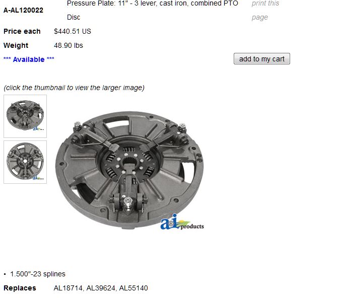

Here's a PP for dual stage clutch from A&I.
   / Neighbors tractor broke from towing up hill ?
#28
TxJim, Does this look like it may work?
Home > Tractor Parts > John Deere Tractor Parts > 2255 > Clutch >
Remanufactured Clutch Kit
Our Price: $322.00
Core Charge for item 202066: $27.00
Part Number: 202066
Qty:
   / Neighbors tractor broke from towing up hill ? #29
What vendor are these parts from? If 2255 indicates model then some research is in order. Is 1020 gasoline or diesel?
