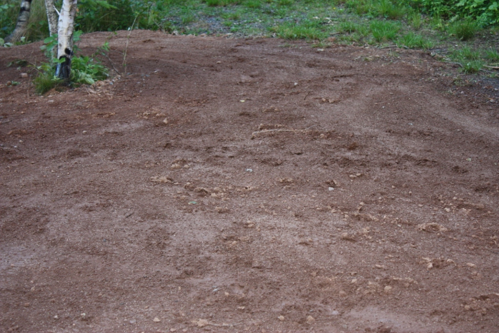

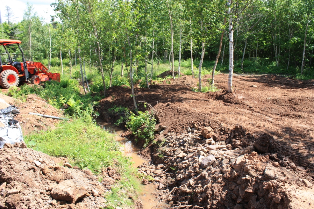

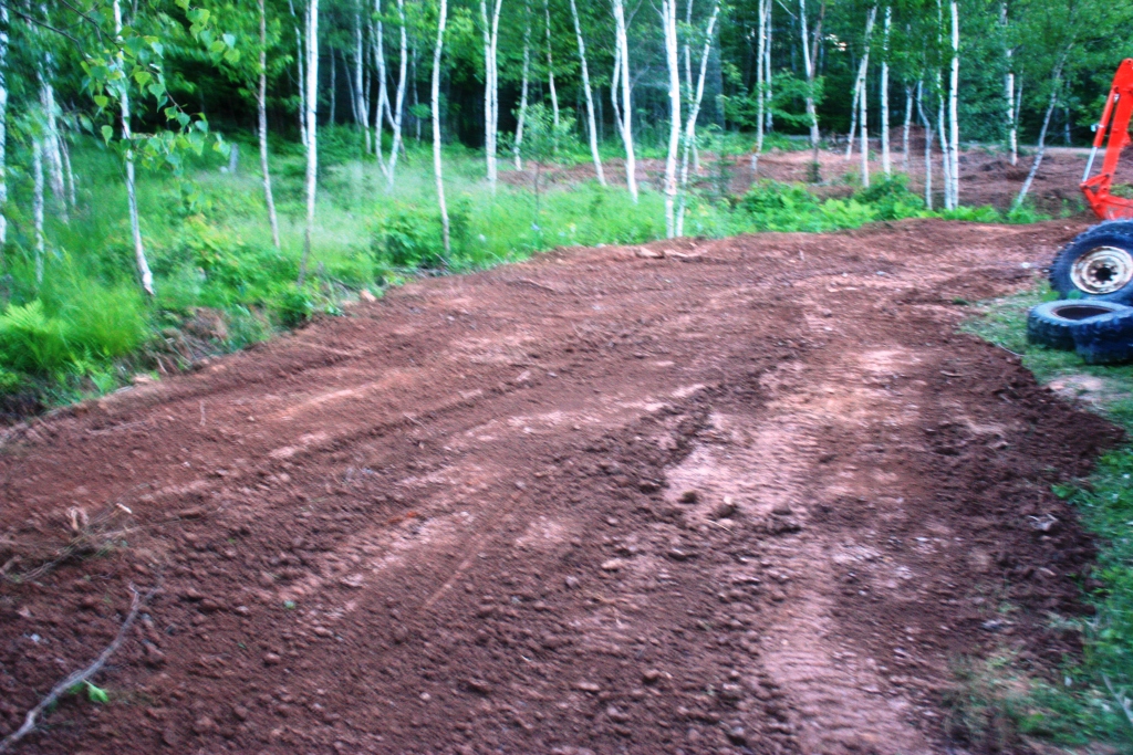

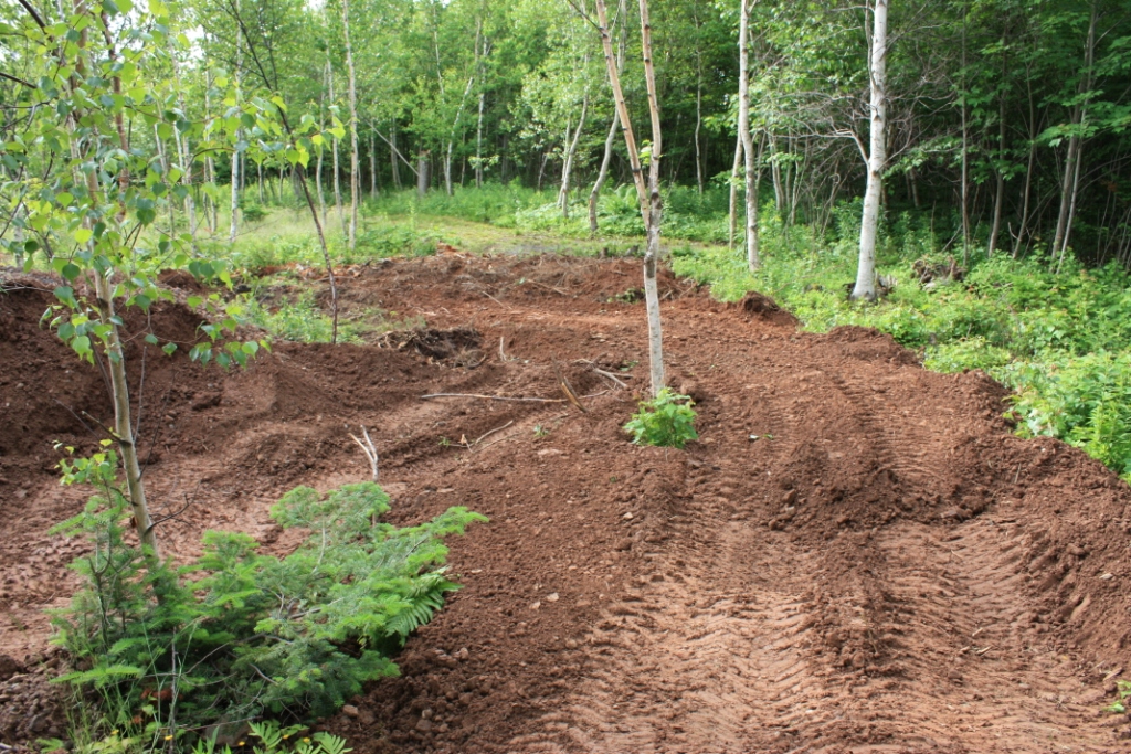

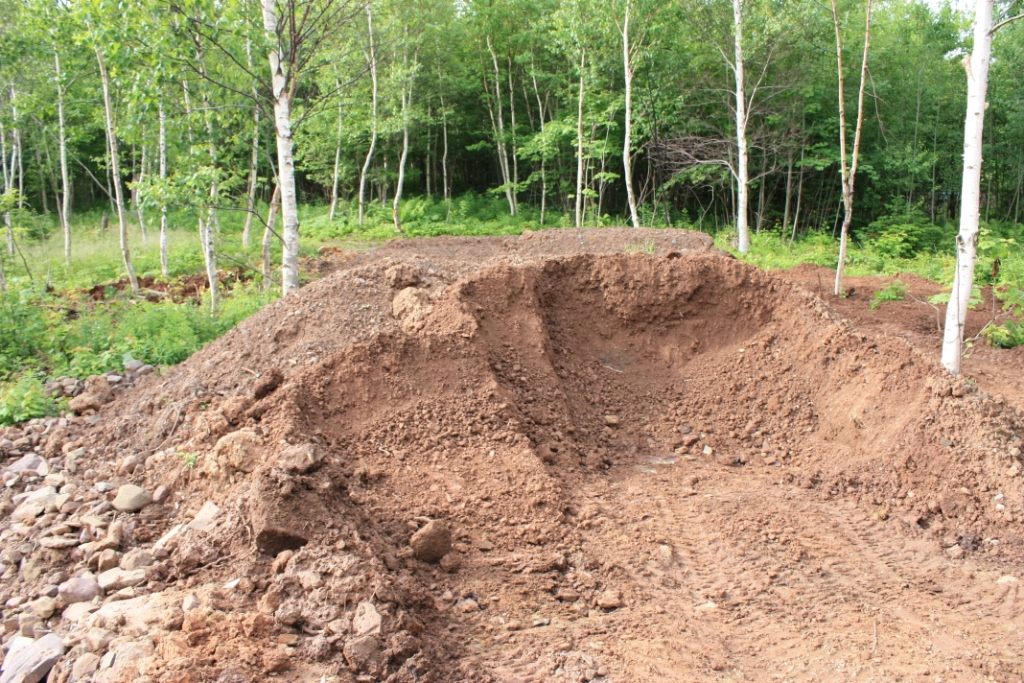

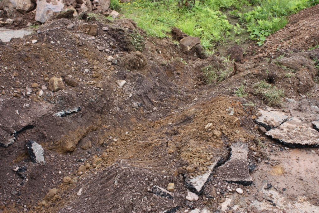

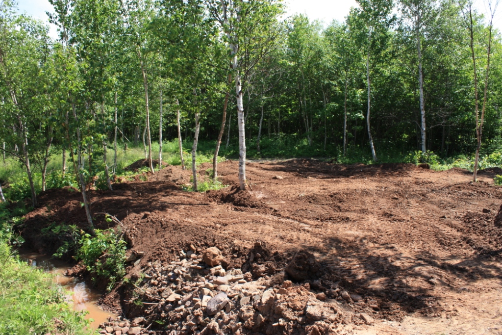

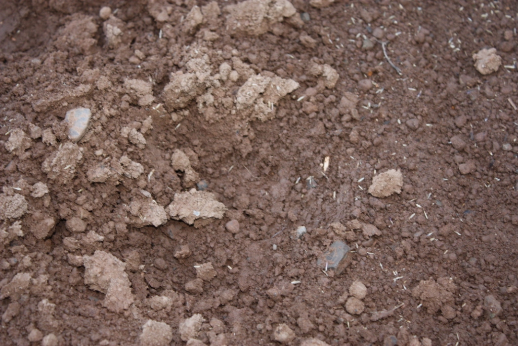

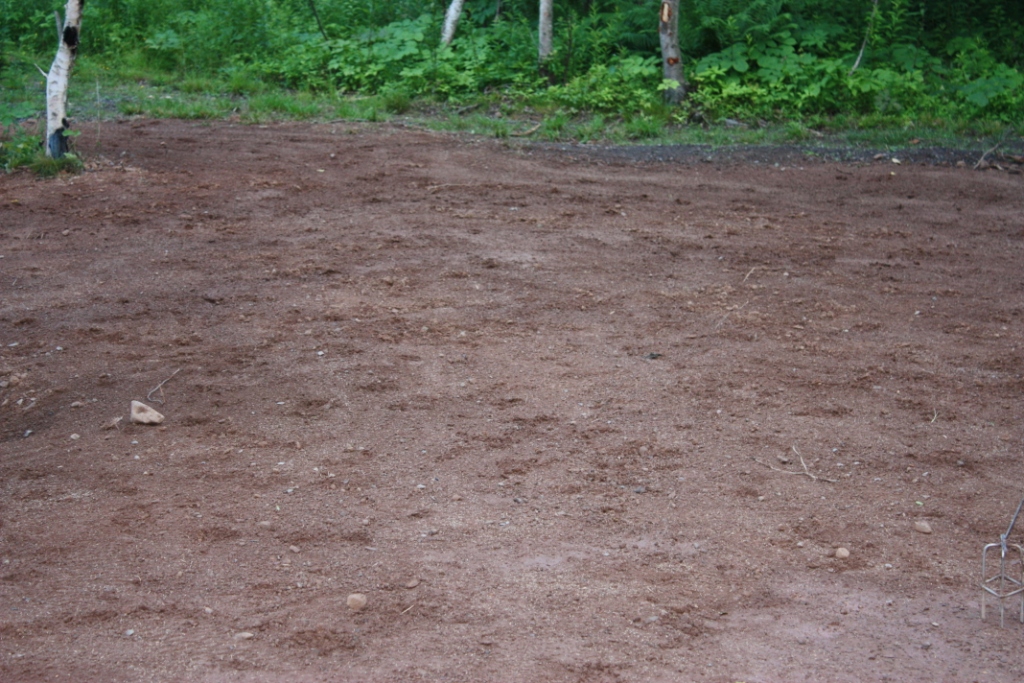

In my never ending quest to make work for myself, i decided i need more lawn:rolleyes: so i spent 12 hours today spreading fill to turn swamp and rock into grass:D
Over the last couple weeks i rounded up close to 60 tons of fill and 20 tons of topsoil.
First job was to spread the fill in a swampy area to the right of the barn and level it out and prepair for topsoil. As you may be able to see from the pics that area was full of trees / stumps. Took several hours to grub and bury the old stumps. Most were s,mall, but there were a couple 12" hardwoods, and one ~24" hardwood that was a bear to get out!!! Unfortunately i forgot my to take pics while in the middle of that job.
Got that section mostly done, and i hope to finish that tomorrow.

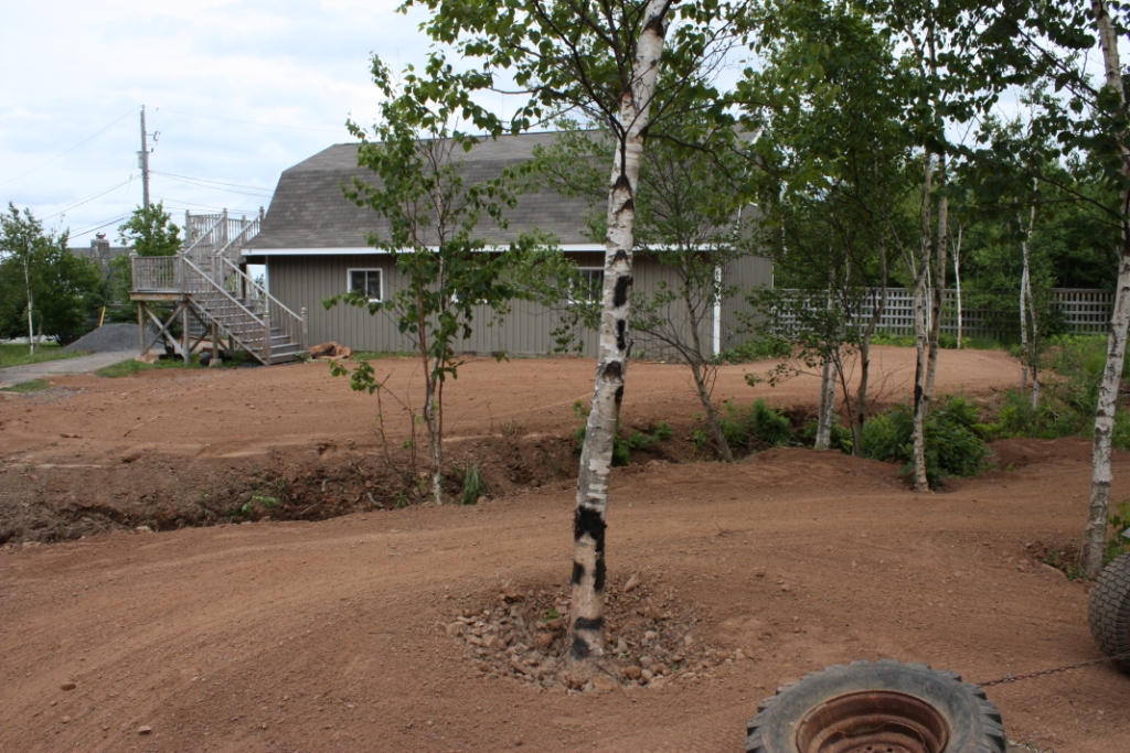

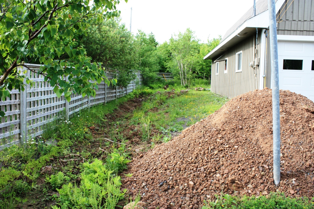

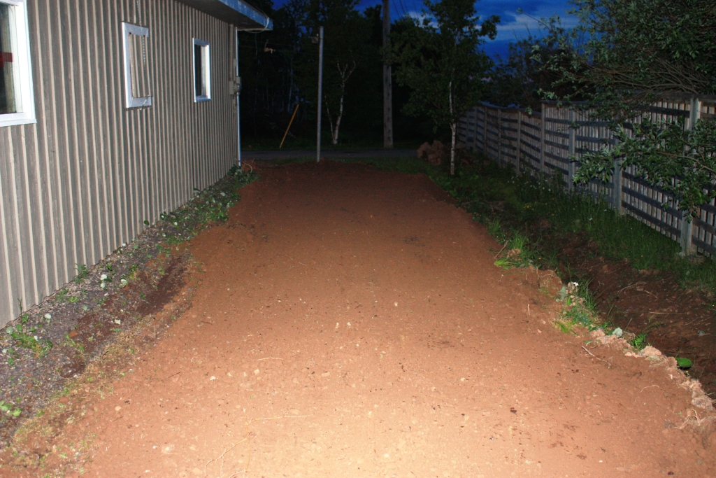

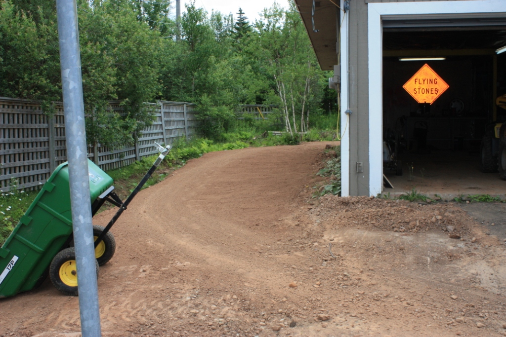

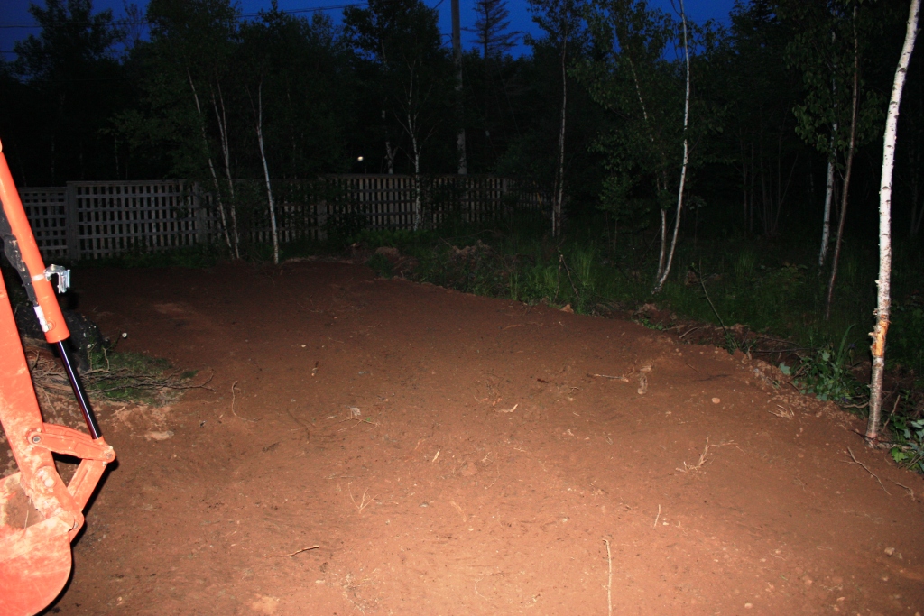

Second half of the day, i spent filling in around my barn. Trying to landscape and level it off. THe right left and rear all require fill. Then im going to top with more grass:D
When the barn was built, it was built over a swamp. This required LOTS of LARGE rock. This made things extra fun:mad: Ill try to remember to get some pics of the rocks tomorrow.
It may be hard to tell in the pictures but there was close to 5 ft drop from the barn floor to the Left hand ditch beside the barn. Required lots of fill. Got that and the rear mostly done.
All and all it was a long day. 12 Hr in the seat makes for a sore ***

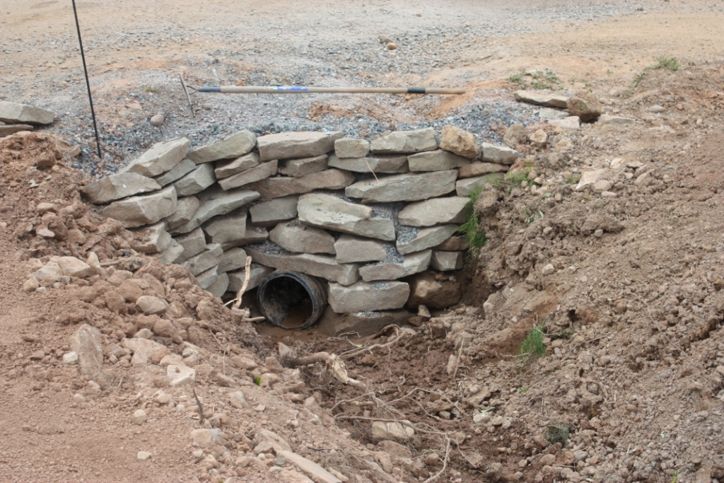

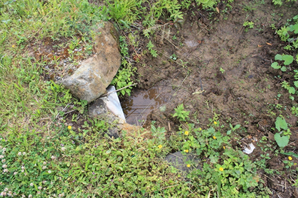

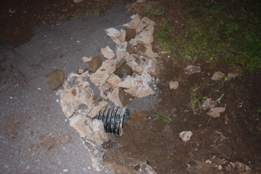

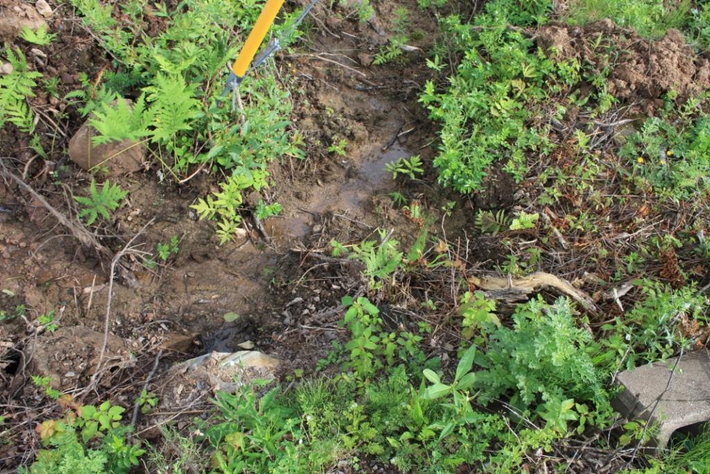

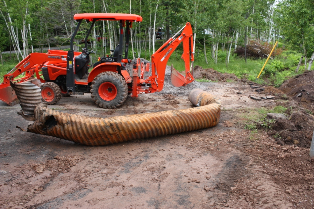

As part of the lawn construction, i had to clean some ditches and redo some culverts as the old ones were clogged and rusted. The new poly culverts are 10x better, and hopefully will last a lifetime. The old ones were pretty much done after 20 years.

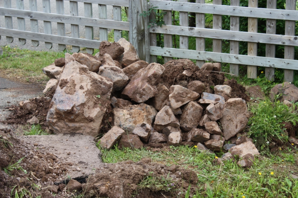

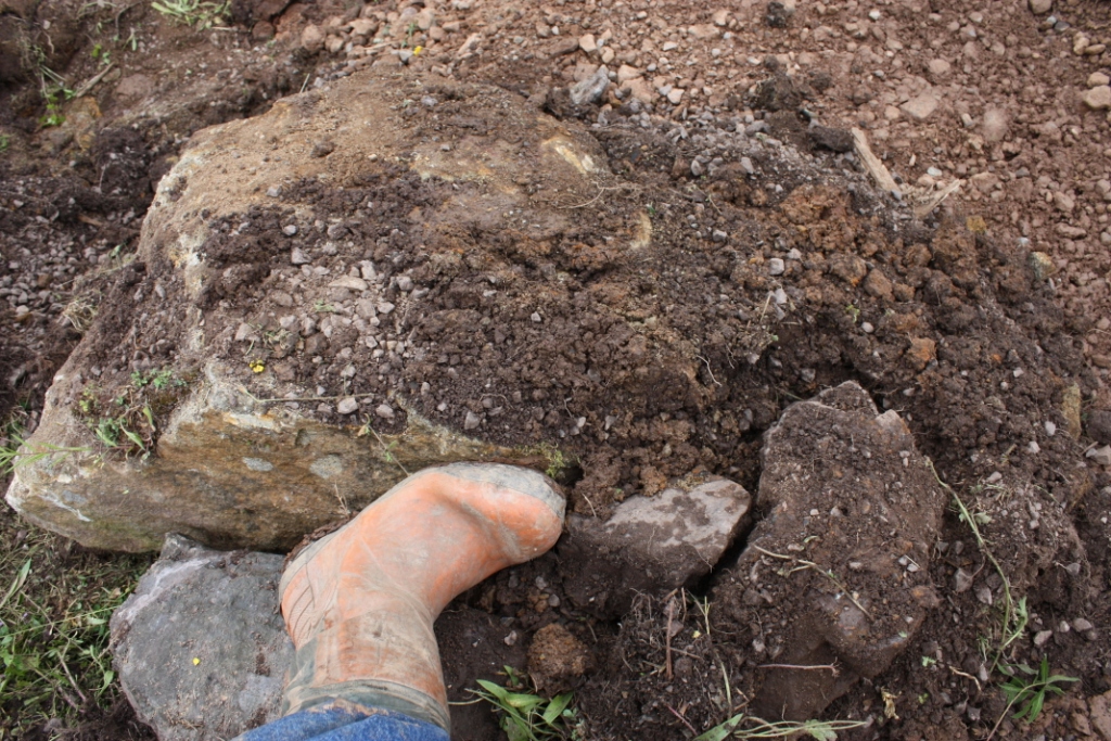

The ground in the area has some major rocks as mentioned before. This made life extra difficult.

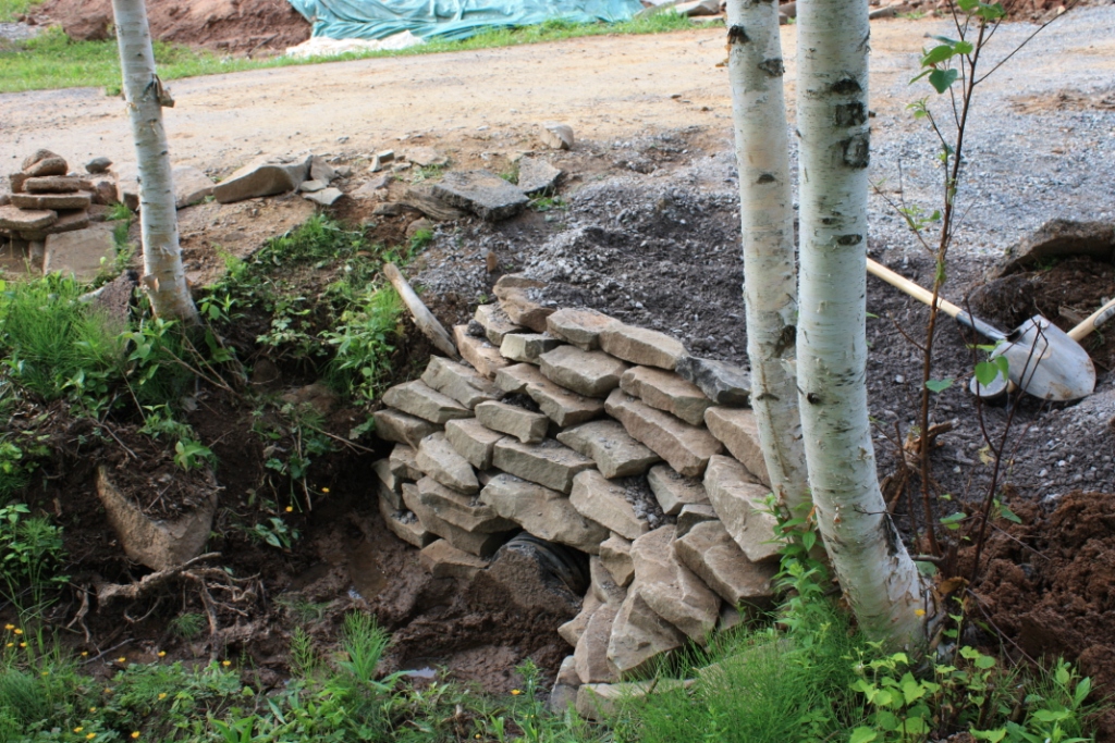

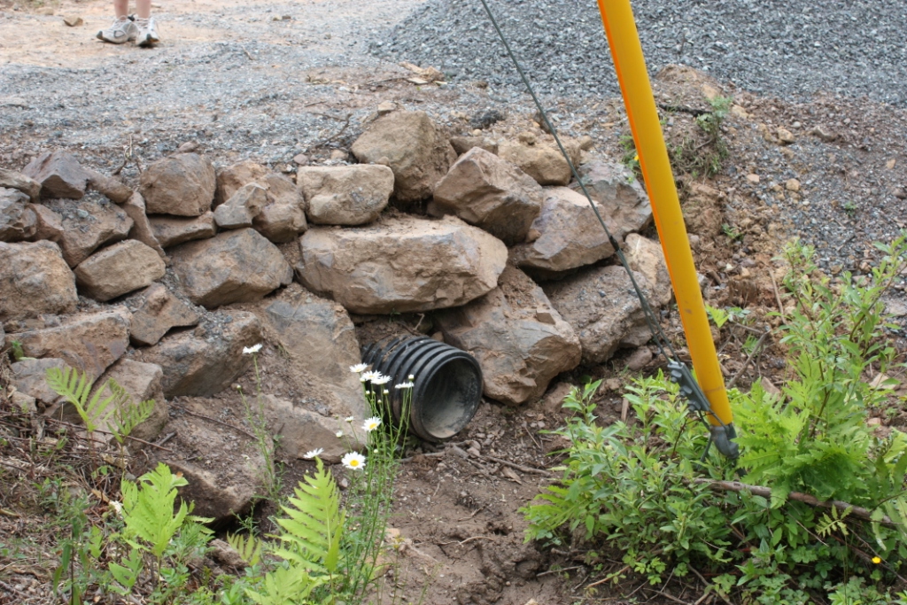

But at least the rocks came in handy to build retaining walls around the culverts.

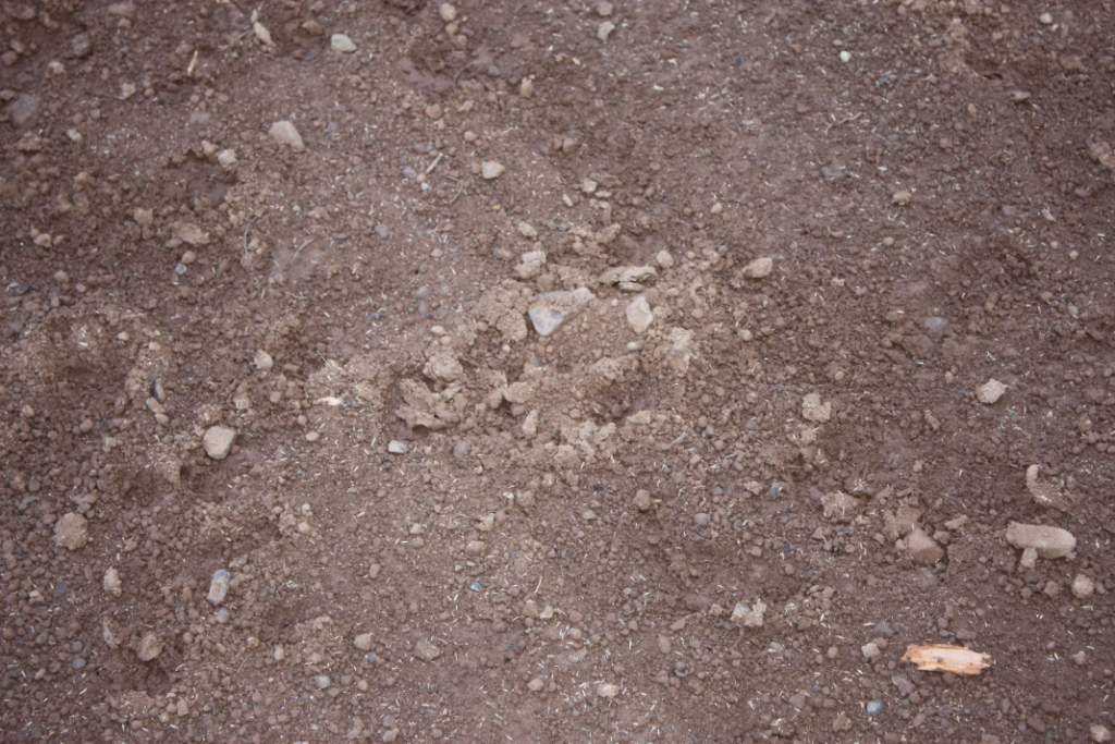

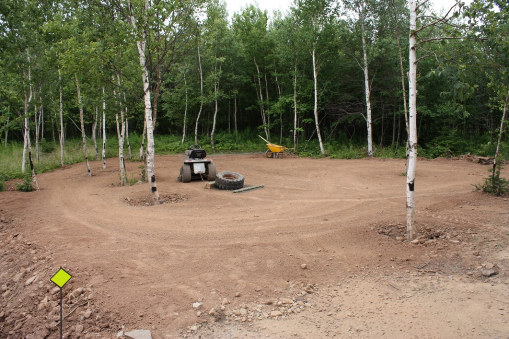

Finally i got the topsoil and seed spread over the new lawn area. Total area is around 7000 sq feet. One thing i can say is seed sure has gone up in price! close to $120 in seed to cover this area. Plus another $40 in fertilizer.
I brought the 23 year old craftsman lawn tractor out of retirement after my several page thread on TBN on getting the old girl ready for work again. And it worked GREAT.
I put together a chainlink drag to level and spread the topsoil. Probably one of the best things ive ever built. And considering it was made of junk that was kicking around, even better :D

Oh come on Scooby, a little brush on rust converter/remover and those culverts will buff right out to look as good as new. :rolleyes:

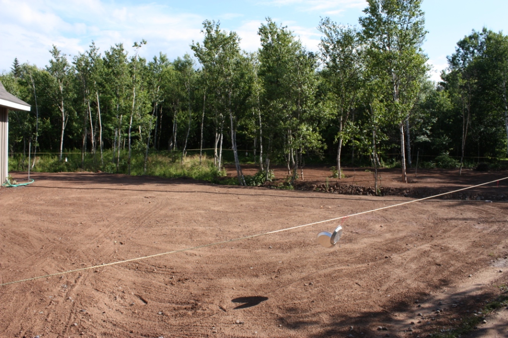

I strung up some rope at waist height today and tied some pie plates to it to act as noise makers. Also had a leak on a couple trees to mark my territory :D. Havent got any hair yet, but i may try that too. Got to keep the bastards at bay somehow:D

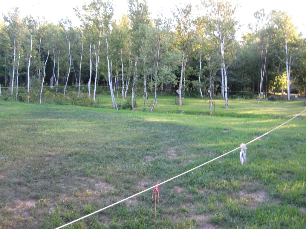

Jim: Yeah the joys of trees,eh?:D
Maybe next year the craftsman will have to get traded on one of those nice 4ws deere x324's;) or a ztr, you know, to make life easier....
mjncad: Dont know about the Coors, but i can say there was definately some Keiths there :D
Looks like my system of plates , ropes and Pi55 are workin. Knock on wood.

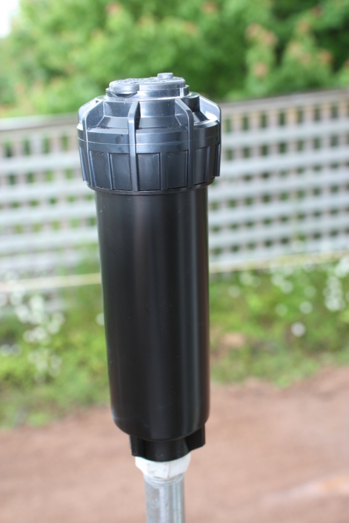

In a previous thread, i recommended Rainbird impact sprinklers. I think im going to have to retract that recomendation, at least for me. While they are well built, due to my limited water (6GPM and 40PSI) they have a tendency to stall and overwater. If you were wattering on city water or from a pond with a pump, youd be fine, but for my conditions This just wont do.
After talking to my brother (greenskeeper) he said i should go with a rainbird 5000 series rotary. He said all the golf courses have gone rotary. He was right. Much better coverage, even and consistent. Plus it comes with lots of nozzels so you can dial it in to match your available GPM exactly. Anything from 1-8? GPM. Perfect if your on a well. I really cant recommend them enough. Made in the US, adjustable, well built. I put together each sprinkler for around 30. Less than the price of a import, non adjustable sprinkler.
So i rigged up some redneck irrigation :D
I built a riser out of Galvenized 1/2" pipe and a street 90. Then i welded on a stake to anchor the sprinkler. WORKS EXCELlENT. TO make it even better, i put it on a couple timers. :D Its like a mini golf course. Automatic Lawn here i come.

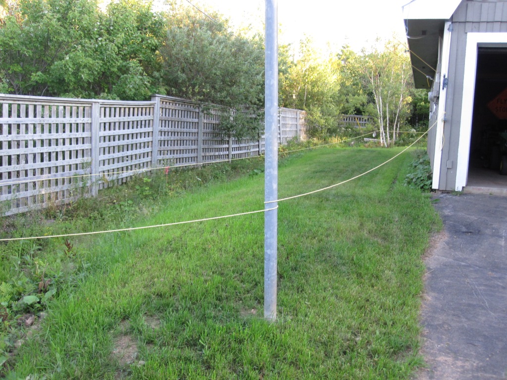

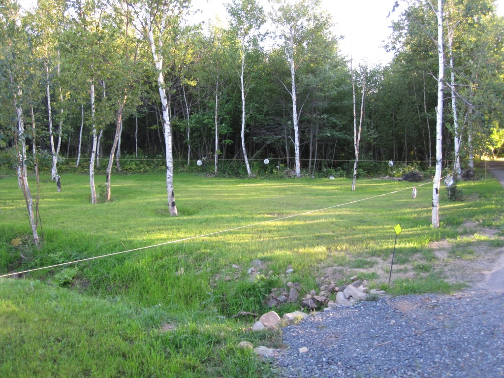

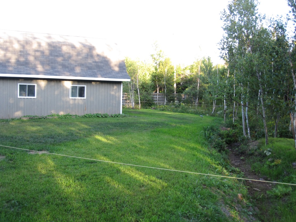

A little update since our growing seasion is winding down.
The irrigation system worked wonders. I probably had the best results ever installing a lawn, and there is no doubt it was the reason.
I highly recommend that when installing a new lawn, you go out and spend the money to install a temporary system such as i did. Cost was around $150, and part of that was a brand new hose $50, money well spent.Plus ill be able to re-arrange the system for garden duty in the future. Makes a huge difference. Unless you want to water your lawn every couple hours all summer:D
The lawn came in quite well, with only a few bare patches. Ill rake them and reseed next spring, but all in all, lawn looks good.
Heres a few pics. With the current air temps, sure feels like it will be covered in snow soon :eek:

Thumbs up on well done project Scooby.
Little more lawn to more than before,but lawn w/trees and stream should look like picture postcard. :)

Your grass really came in good & looks great!... The old culvert really looked bad.:eek:
Also great work on the irrigation system!
I really like the way you stacked the rock around the new culvert!... I had a guy call me yesterday to ask if I had any rock to put around a new one.
I've put in some triple wall plastic pipe for friends before, and they may last longer.. BUT, they sure cost a lot:D
