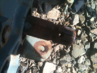

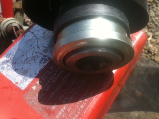

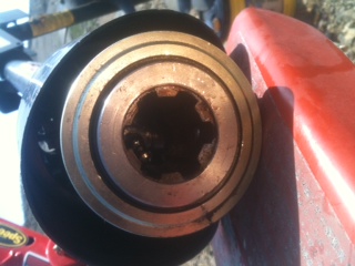

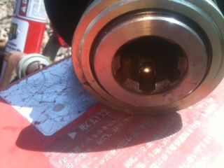

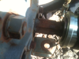

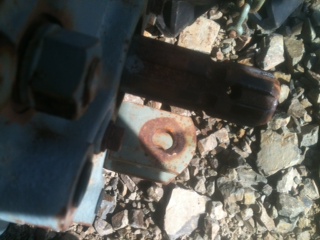

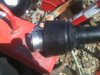

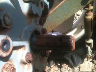

#33
OK, so everything seemed to go ok but now I cant get the auger to attach to the PTO shaft? Here are some pics of the end of the auger shaft and the PTO shaft. I have checked online but cant find a video or anything for fieldmaster to show how to attach it. I did find other companies and one one of them there is an extended shaft with a pin you pull out. This does not have it. Does it look like Im missing parts? I cant push this auger shaft onto the PTO shaft any further than it is and it wont lock into place and if it did, I cant see how you would remove it?
Any advise as I have never installed any implement ever. I was hoping to start digging fence post holes today.

   / New 2 me YANMAR 2210 BD 4X4- NOW-SERVICE QUESTIONS?
#34
YEP, THAT WAS IT, my wife actually looked at it and said the same thing before I got this reply. I had to pull that colar out and slide it on and it clicked. simple. Thanks for the reply.

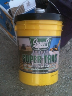

Pretty sure just a play on words but just wanting to make sure you used combination transmission/hydraulic fluid and not just hydraulic as stated in post 31.
#36
Winston I hope I used the correct stuff-- I used this

   / New 2 me YANMAR 2210 BD 4X4- NOW-SERVICE QUESTIONS? #37
If that bucket says it can be used where Deere 303 is specified - its fine.
   / New 2 me YANMAR 2210 BD 4X4- NOW-SERVICE QUESTIONS? #38
A retailer and the distributor recommend it as a suitable replacement for the John Deere 303 fluid that Yanmar specified.
The distributor notes it is for moderate temperatures (like single-grade motor oil); outside that range they recommend their premium fluid. That sounds like 303 to me. Remember Yanmar specifies 5 minute warmup before moving the tractor, probably to get the hydraulic fluid warmed up. But nobody warms up that long!
Rural King
Atlantis-usa
Applications
Super S SuperTrac 303 Tractor Hydraulic Fluid is designed for use as a replacement fluid for the hydraulic, wet brake, and transmission requirements of equipment manufacturers where a product of this quality is recommended, including:
... John Deere 303, J20A ...
SuperTrac 303 Tractor Hydraulic Fluid is recommended for ambient temperatures between +32F and 104F (0C to 40C). For ambient temperatures outside this range or where a premium tractor hydraulic/transmission oil is required, please use Super S Premium Universal Tractor Hydraulic Fluid.
